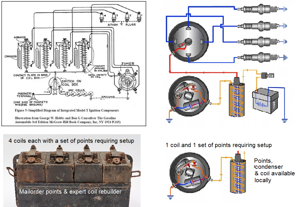

Interesting argument about "distributors" being more reliable.
There should be no argument that a distributor ignition system is less complicated, have fewer points of failure and less expensive to maintain.

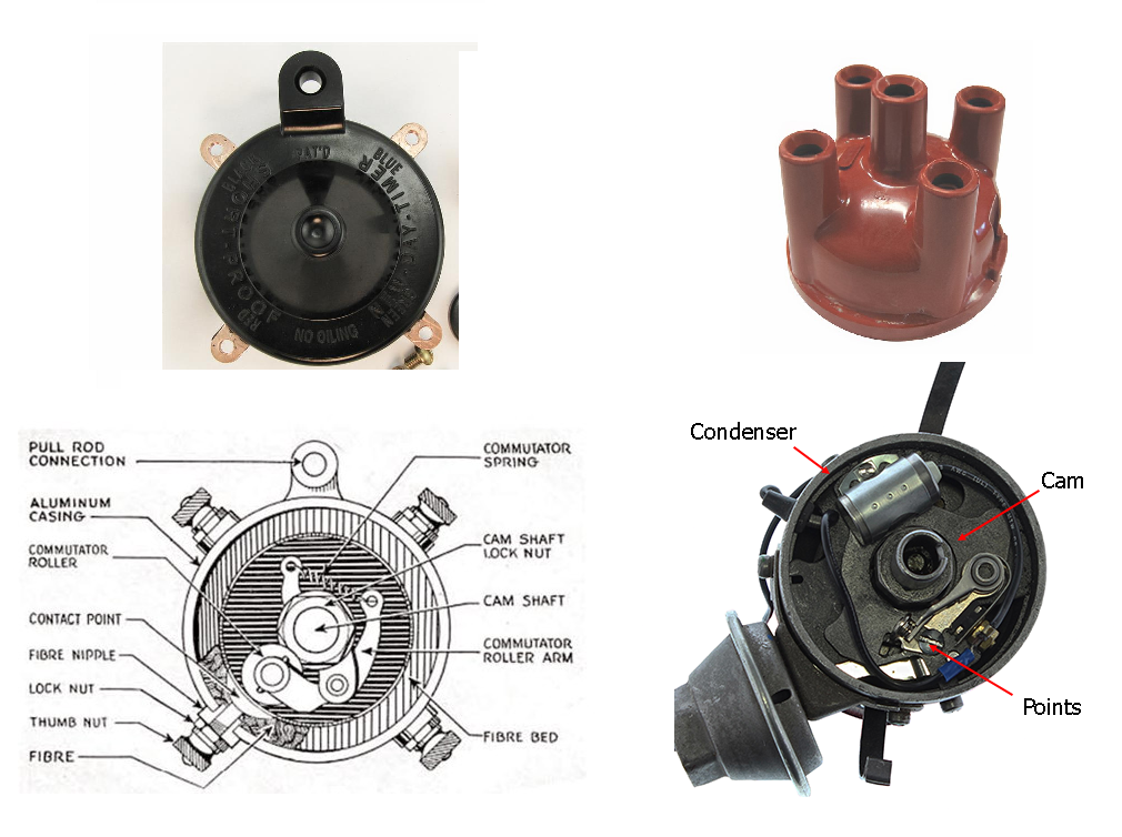

No much difference in a commutator and distributor head. Cap & rotor

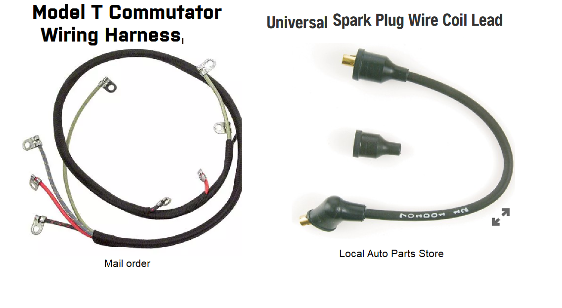

More wiring to contend with

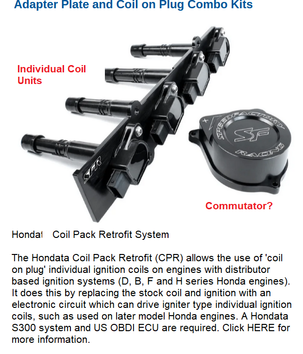

BUT the latest technology is a modernization of the old.

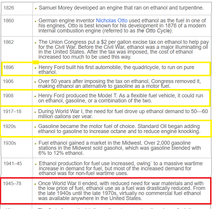

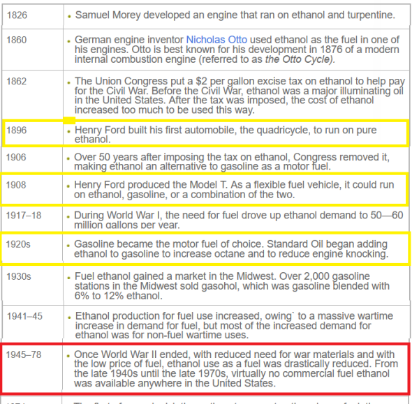

Ethanol blended gas is a relatively new idea & Henry would never have used it.
Ethanol’s first use was to power an engine in 1826, and in 1876, Nicolaus Otto, the inventor of the modern four-cycle internal combustion engine, used ethanol to power an early engine. Ethanol also was used as a lighting fuel in the 1850s, but its use curtailed when it was taxed as liquor to help pay for the Civil War. Ethanol use as a fuel continued after the tax was repealed, and fueled Henry Ford’s Model T in 1908. The first ethanol blended with gasoline for use as an octane booster occurred in the 1920s and 1930s, and was in high demand during World War II because of fuel shortages.
