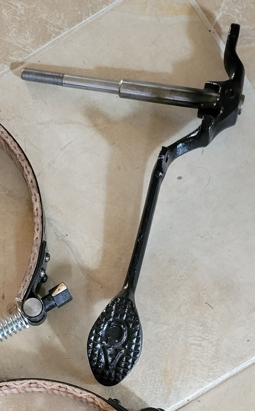

RVA23T
Posts: 848
Last Name: C
Re: Replacing pedal shafts
Post by RVA23T » Thu Aug 08, 2024 2:37 pm
cwhuntersr wrote:
Thu Aug 08, 2024 2:13 pm
Probably not the right terminology - the added piece welded to the pedal for actuating a master brake cylinder
For accessory / aux brake systems like this:

Posts: 5100
First Name: john
Last Name: karvaly
Location: orange, ca
Post by speedytinc » Thu Aug 08, 2024 3:53 pm
They will work on this pedal. You may have to shorten the 5/8 tube to retain the O-ring seal in the pedal.
