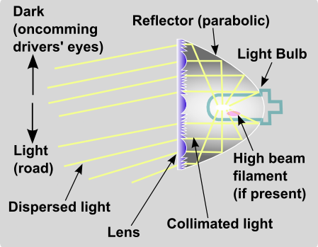

The orientation of the filaments in the bulb being when at the focal point of a parabolic reflector have little or no practical relevance. The "focal point" or sweet spot of the reflector is actually very small. So when adjusting the headlights on Bright both filaments are illuminated and the brightest point is determined by the filament's light relationship to the sweet spot not their physical relationships.

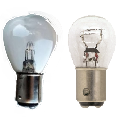

Given the two bulbs below the filaments of the one on the left are tight together and almost form a square at the wire ends & bright and dim filaments are at the same height. If there is an argument on bulb orientation it would apply to this design of the bulb on the right with its filaments spread out and at different levels. Not much within the sweet spot. A two filament bulb which shines light onto a parabolic reflector and then through the lens into the area in front of the car. The parabolic reflector takes the light from the bulb and directs it parallel to the bulb’s axis in straight lines which means that the light is therefore organized (like a flashlight) and more useful than the scattered light of say a candle flame. The filament of the bulb will be positioned at the focus of the parabola making full use of the reflector to give the greatest light quantity. The parabola makes all the light waves nice and straight and organized and the lens can do its work to direct the light. The reason why these early cars had round headlamps was that it is the resulting shape for a parabolic reflector. The ribs on these headlamps’ lens’ aren’t for your pleasure they are called flutes, and it is their job to direct the light into the required direction. Nominally downward away from an oncoming driver’s eyes and to the off driver’s side direction.

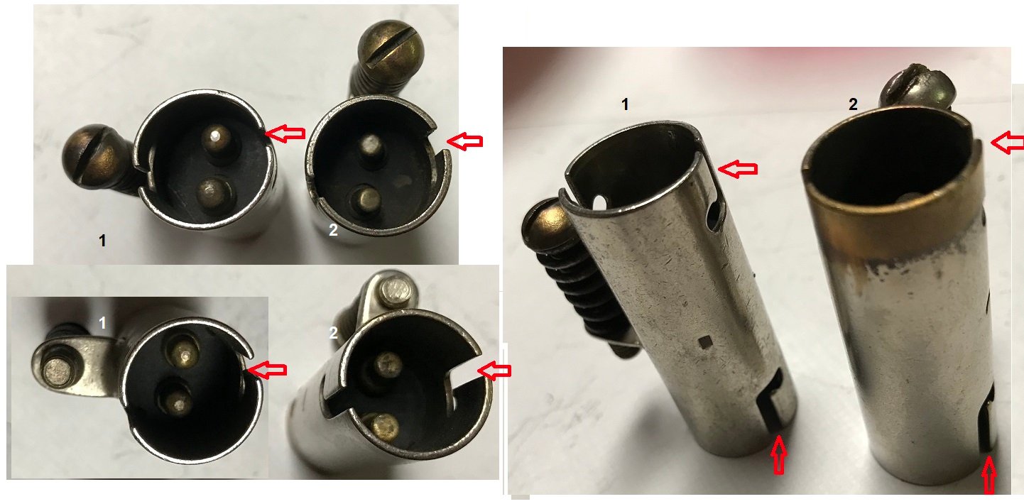

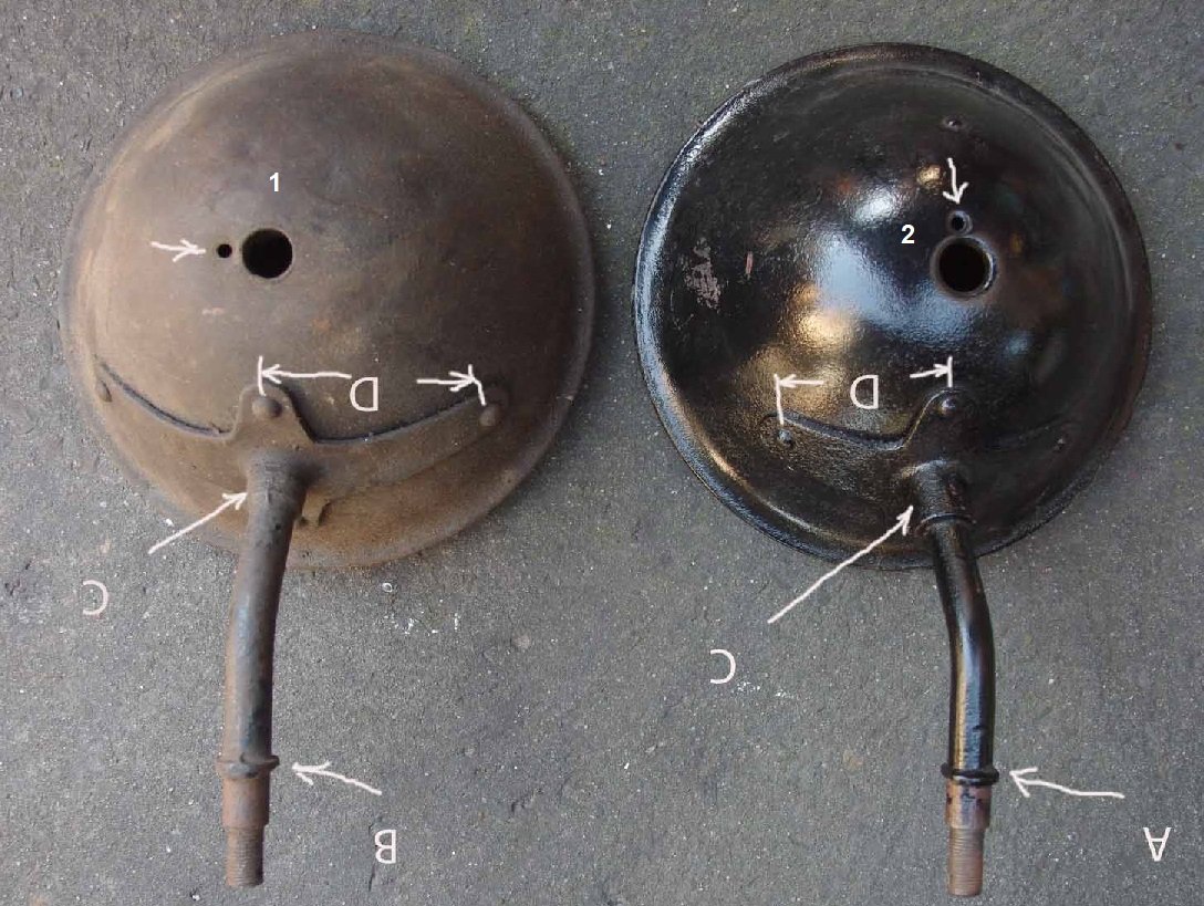

There are two variations of headlight buckets based on the focus screw position, twelve o'clock and 9 o'clock. --
Then there are variations of the original sockets to keep the bulb aligned (The original two filament bulbs as shown in my previous response are so close I can't see how orientation would cause a difference)
If you very close to these pictures you'll notice #1 is for the 9 o'clock bucket #1 and #2 socket is for the #2 bucket at 12 o'clock
An even closer look shows that the contacts are 90 degrees off but the cuts for the plug & bulb are in exactly the same position. --

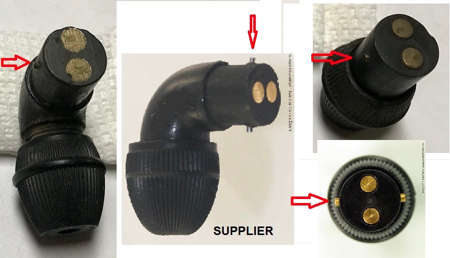

Now there are some differences in the 90 degree plugs, but not the straight on. The one on the left is for the #2 socket & bucket. --
So if the "supplier" 90 degree plug was used in the #2 Headlight & socket its end would point to the left. However If a #1 socket is used in the #2 headlight bucket the supplier plug end would be pointed down but the filament position would be changed. Same is true for that combination for a straight through plug.

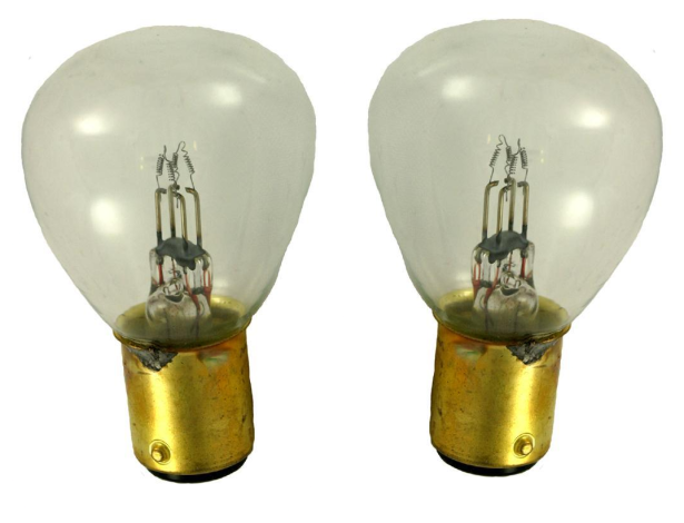

If this is the style bulb you are using there is no orientation affecting light focusing issues (right is rotated)
