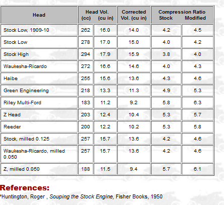

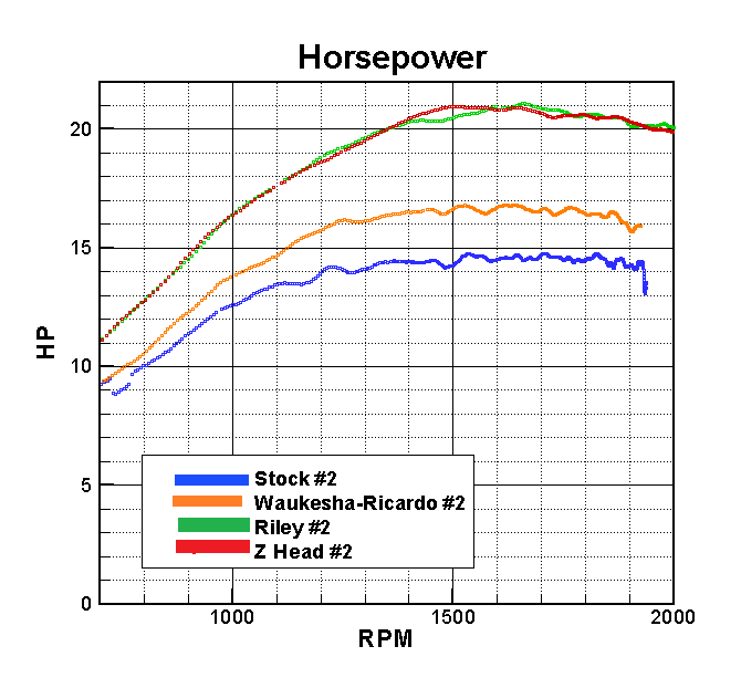

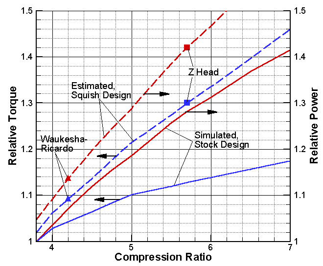

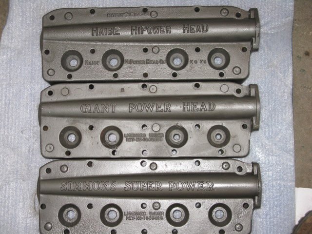

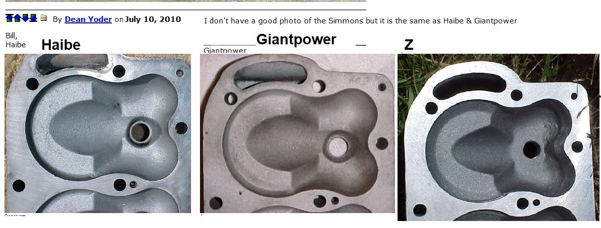

Posts: 6539
Re: Giant Head
Post by TRDxB2 » Tue Aug 13, 2024 11:57 am
"High Compression Heads" are not necessarily that much higher than a low stock head but offer different performance characteristics.
Iron or aluminum?
compression ratios.png (105.2 KiB) Viewed 2310 times
Giant Haibe Simmons & Z
