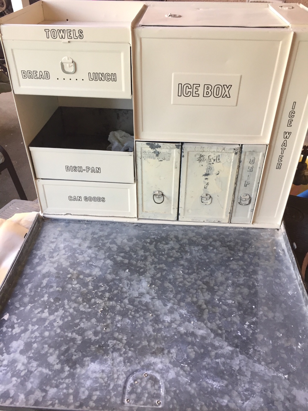

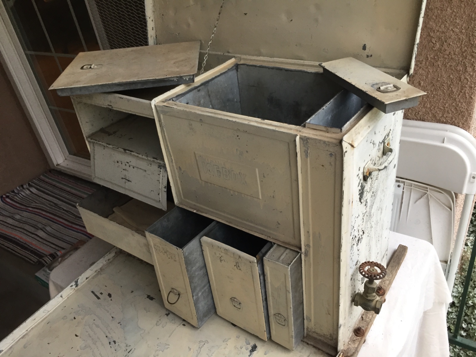

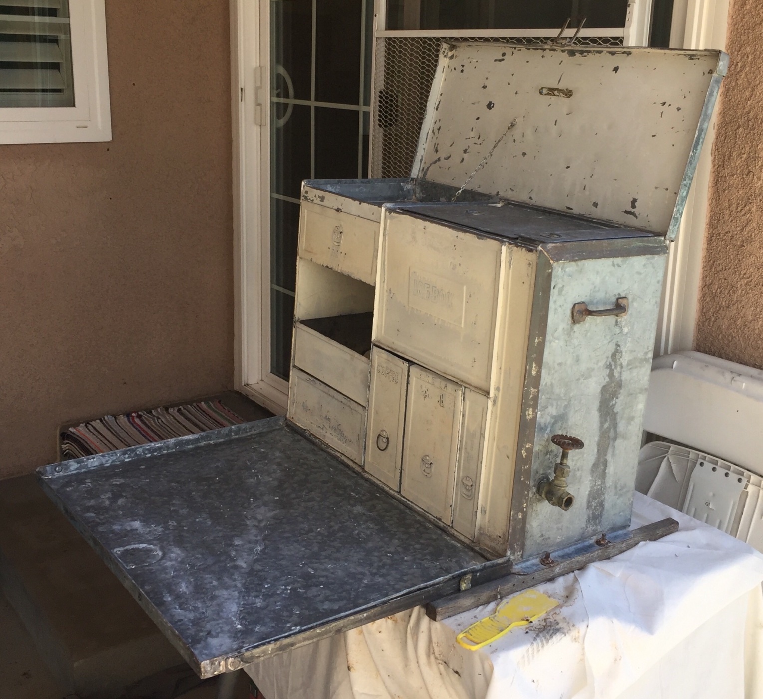

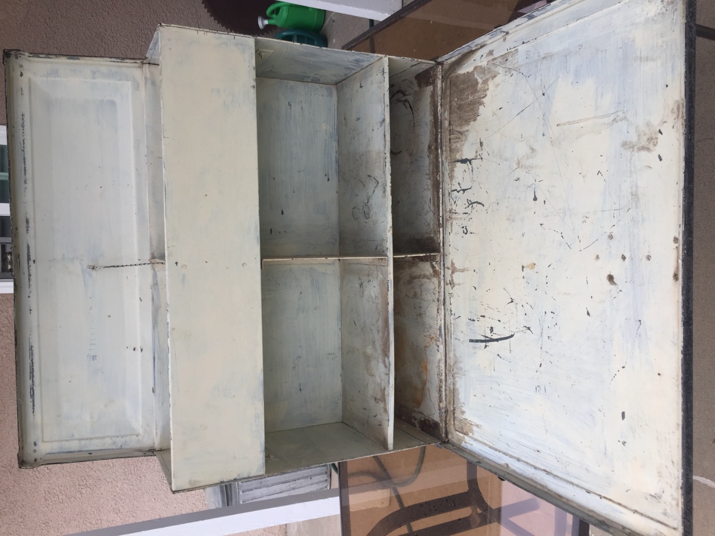

I picked this up at an auction last weekend.
Unfortunately someone took the time to paint over the decal lettering. I plan to strip the paint off and either leave the galvanized steel or paint it. Either way I would like to add decal lettering.
Any suggestions?

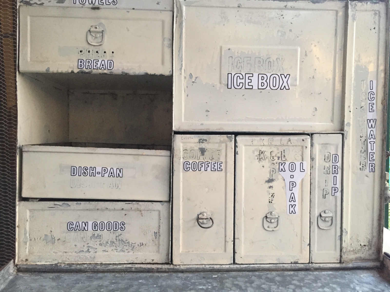

Re: Decal block letter suggestions for my running board Tourists Kitchenette

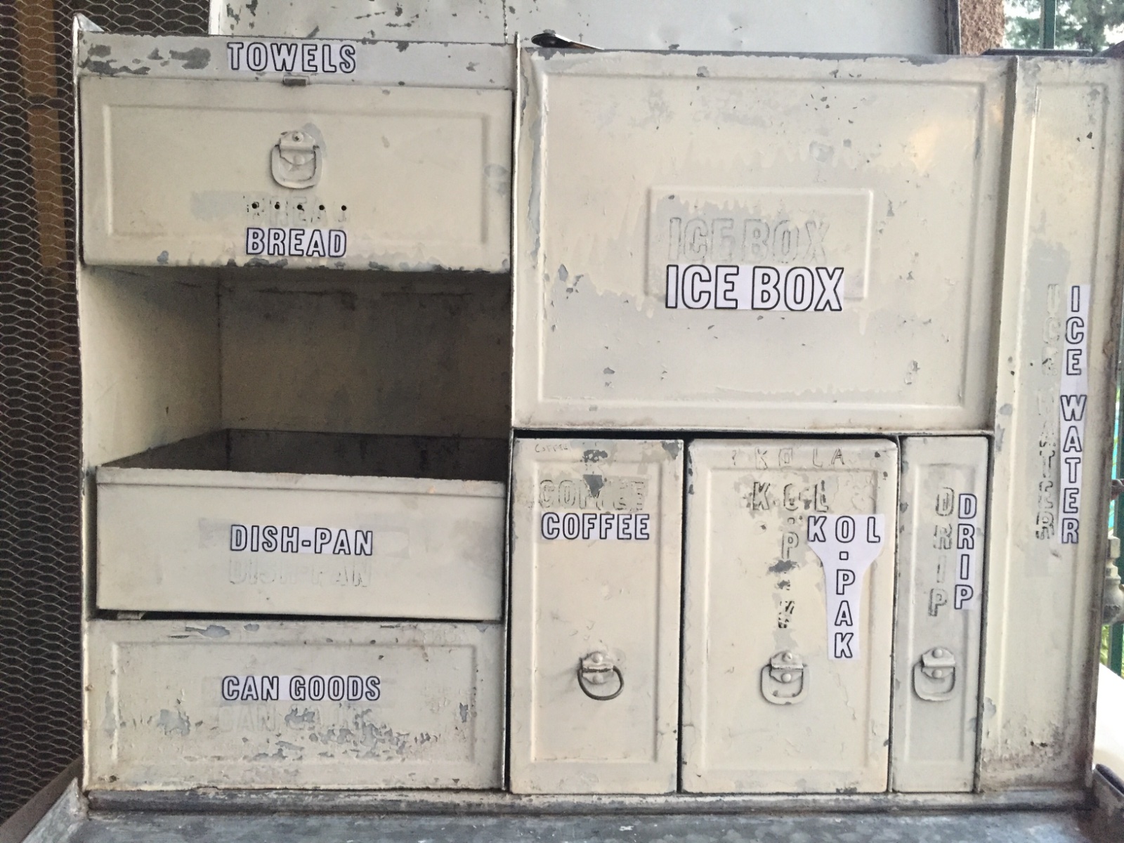

Post by Matt in California » Sun Aug 27, 2023 5:03 pm
“ICE BOX” Seems to be written and 1 inch lettering.
Everything else seems to be written with three-quarter inch lettering.
I am not sure on the exact font but this appears to be a block lettering with black outlines. I’m not sure if it was a decal or some sort of lettering that was stamped on with paint.

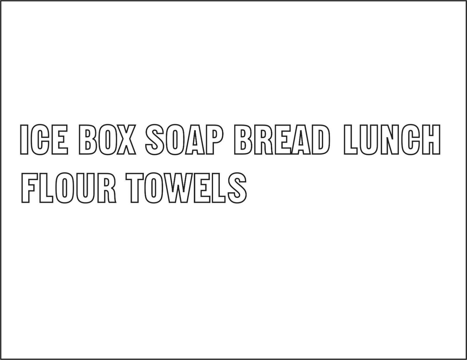

Post by TRDxB2 » Sun Aug 27, 2023 7:32 pm

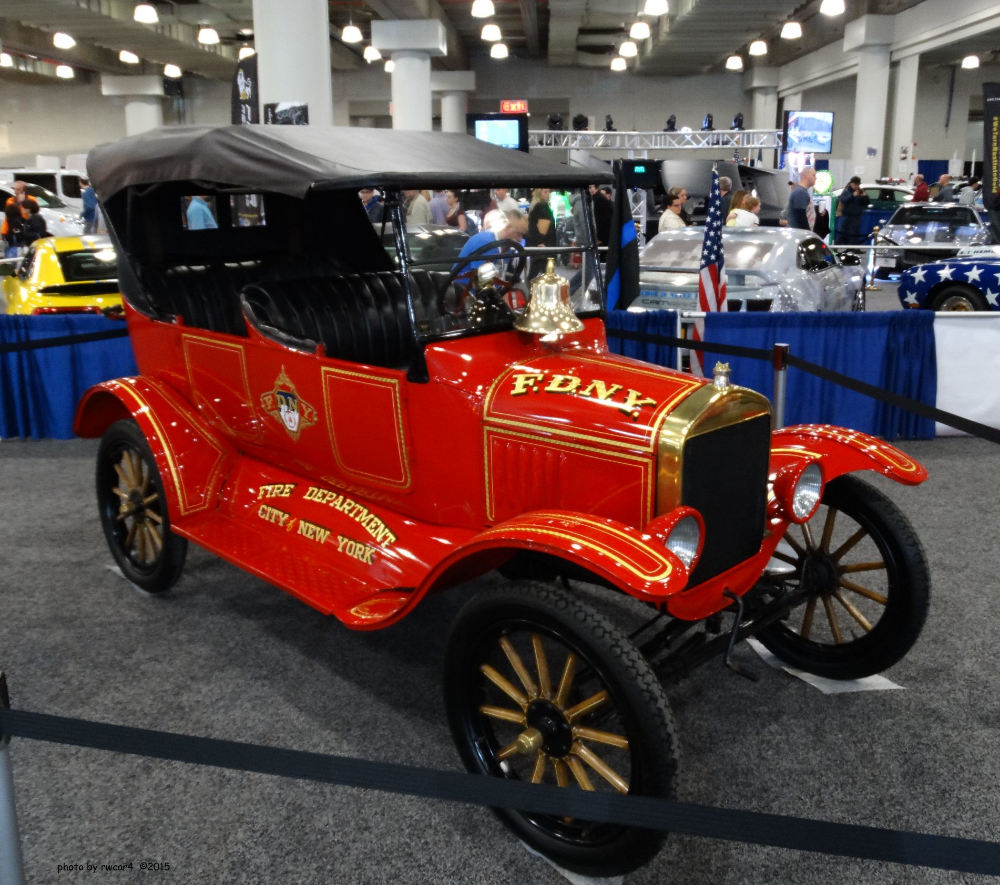

Post by jiminbartow » Sun Aug 27, 2023 9:56 pm

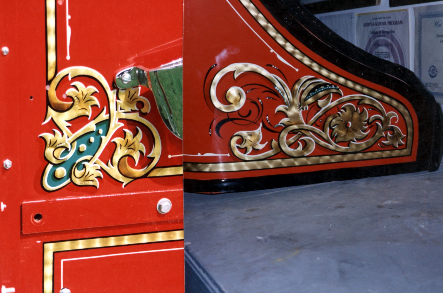

I have always liked the gold leaf Wild West font with ornate pin-striping like the lettering on Fire Engines. You can look up examples online and where to get such lettering. Jim Patrick

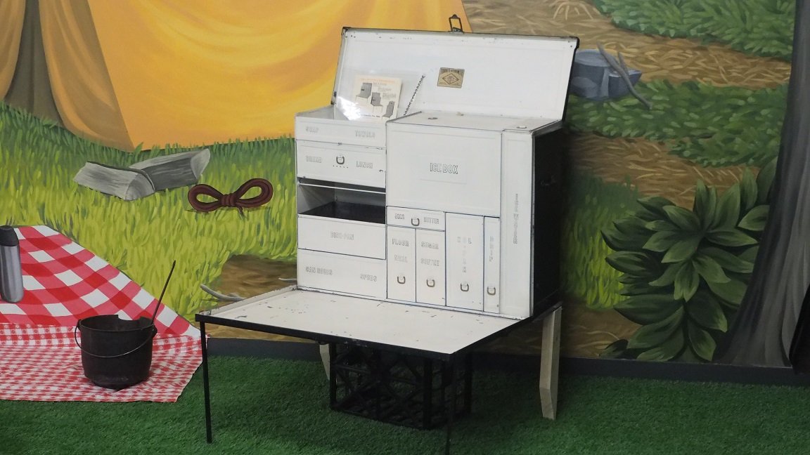

Post by Ken Lefeber » Mon Aug 28, 2023 12:16 am

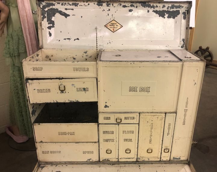

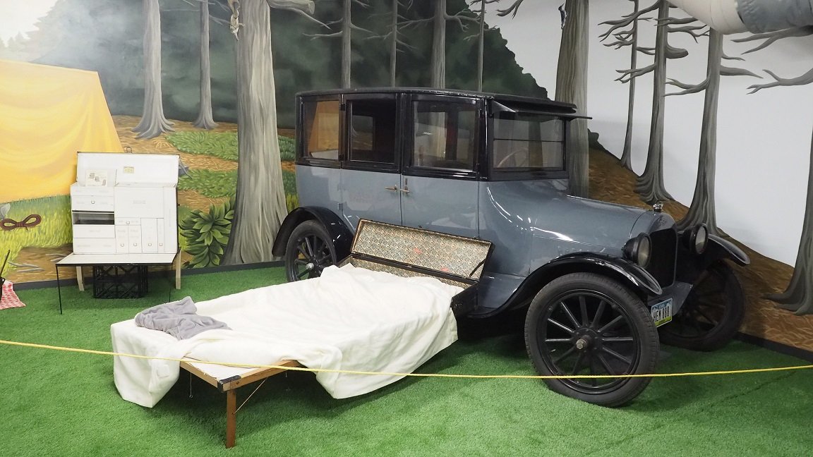

They have one of those on display at the Antique Car Museum of Iowa.
Looks like fun.

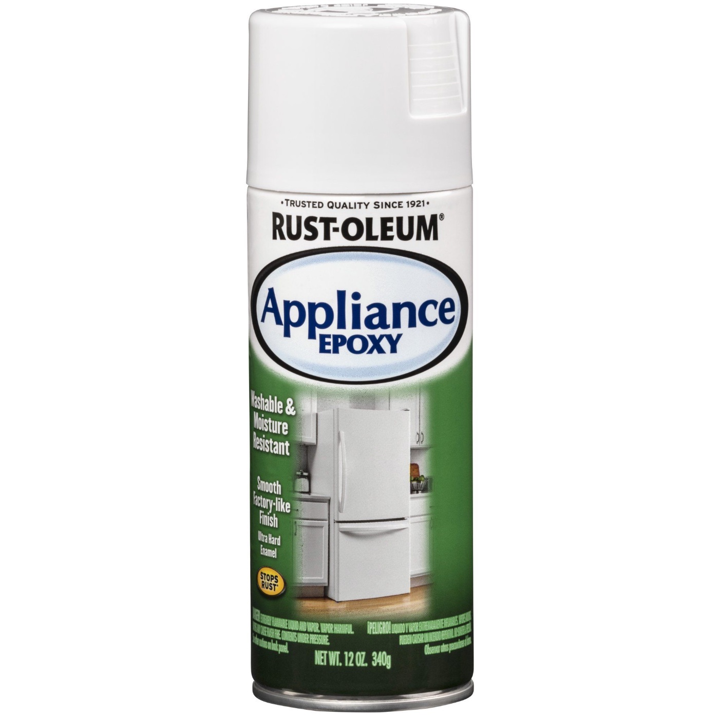

If you want to keep it white, Rustoleum Gloss White Appliance Epoxy spray paint is the best I have found. Sand off all the high points and runs with wet/dry sand paper to get it as smooth as possible then spray. If you are good, you can get a professional looking paint job. This is a fender I did with the Rustoleum Gloss Black Epoxy. Pictures were taken after the paint was dry and before polishing with Meguiar’s rubbing compound. You can get an even better shine if you polish it with rubbing compound but the finish looked so good, I did not feel the need to compound it. The same results can be achieved with the white. Jim Patrick

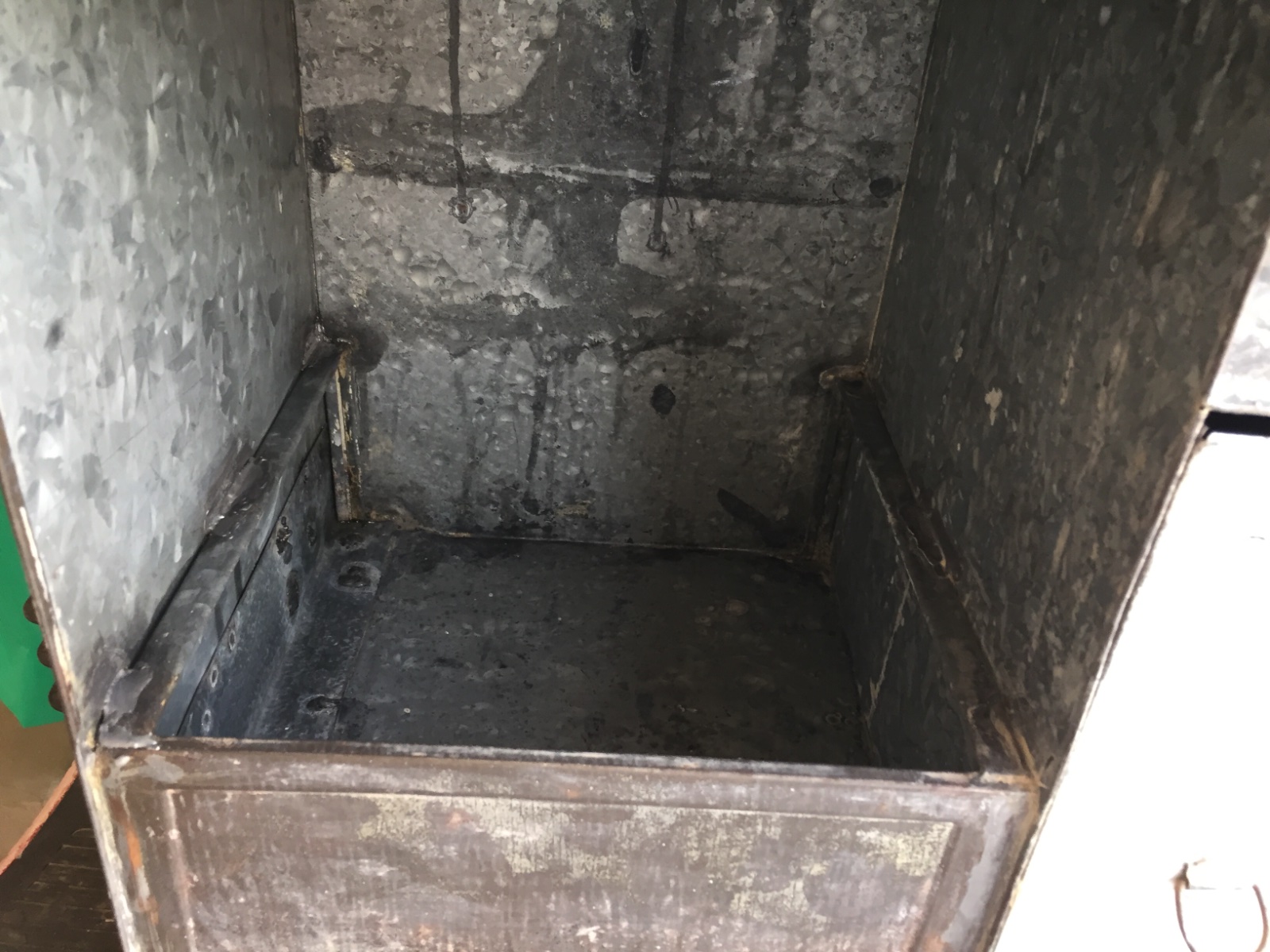

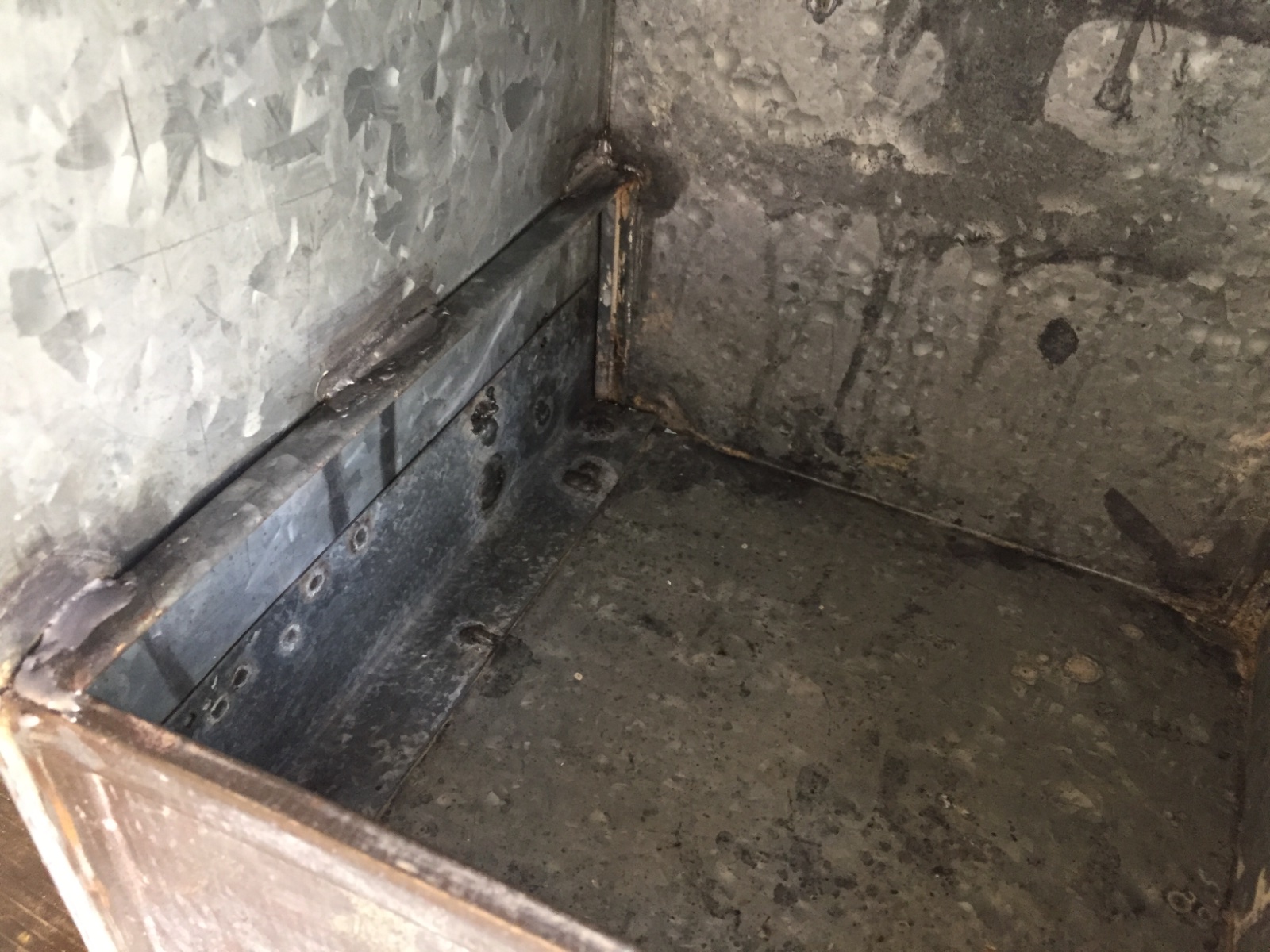

I appreciate all the wonderful comments!
Jim Patrick, Thanks for the advice on the painting. I’ve been working on stripping it down to the galvanized sheet metal.
In someways I like the galvanized look. But I might want to paint at least the inside.
Jiminbartow, I love those gold leaf decals!!! Even though it is not original the gold and black letters could look amazing. Any suggestions on where to find online.
I will have to see if a hobby craft store has the labels I could use.
I also see that there are laser water slip decals. Anyone try those?

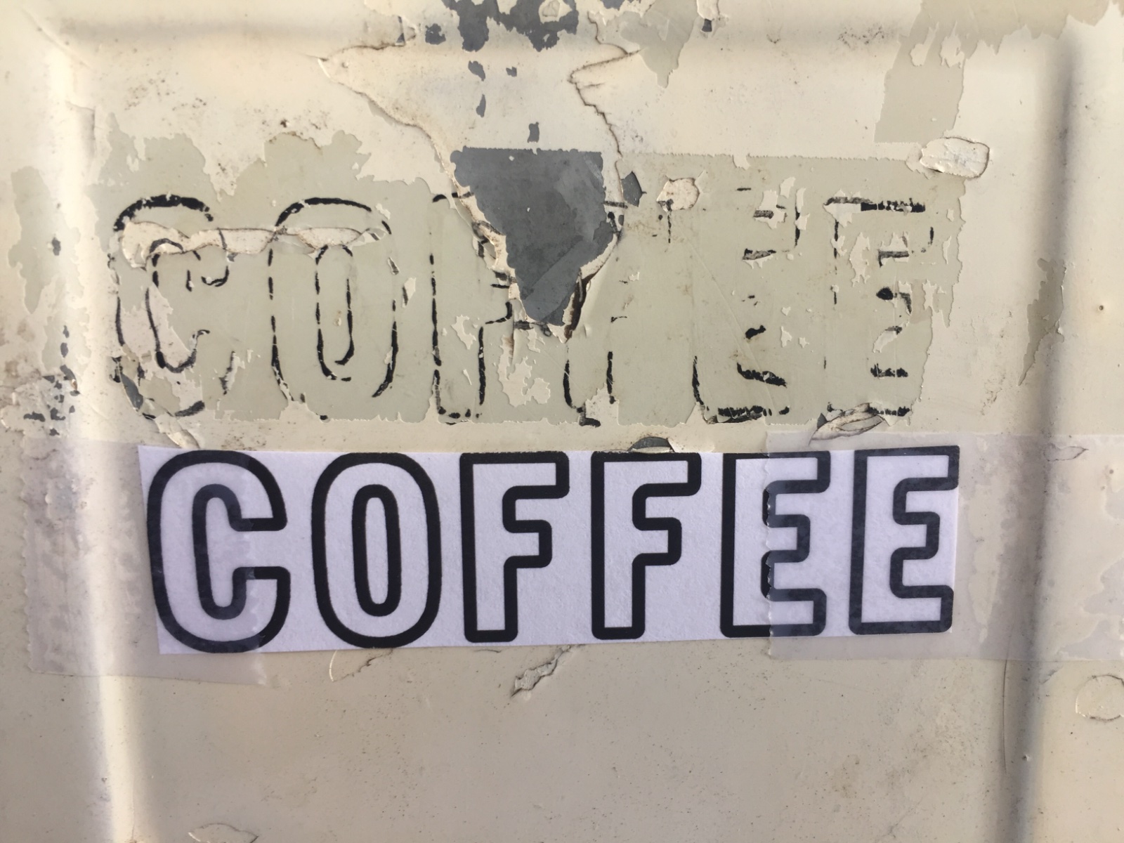

Are they as simple as they seem. This would be black only, but how is color? I imagine color over white should come out okay. I might want to reproduce the manufactures decal.

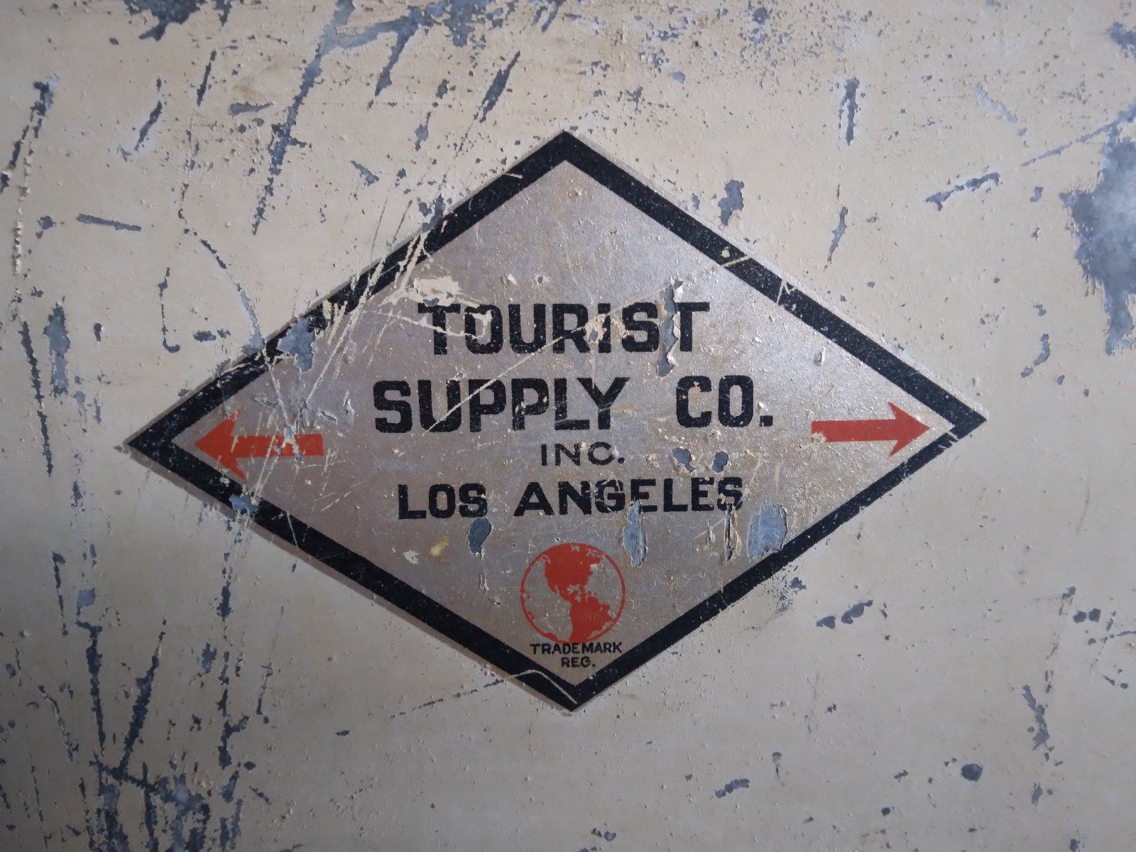

This is what is left of that decal:
It is different than other ones that I find online.
Matt

It’s amazing it lasted as long as it did over the years. There are people that reproduce these types of emblems. If you send a really clear picture to them and the size they can fill in the missing lettering and etc. Or you can do it yourself and then glue on the reproduced emblem.
Check out Radiodaze. They deal with old and antique radios and parts and reproduce similar emblems on antique dials , lettering and etc. There are other sources besides this company that may do it too.

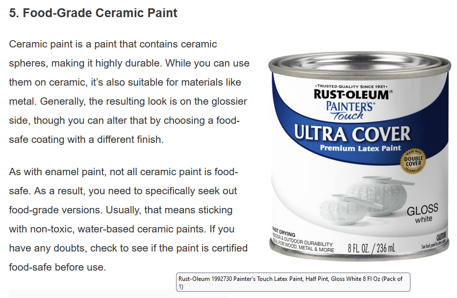

You likely already know but just in case painting over galvanized metal takes some special steps
https://home.howstuffworks.com/home-imp ... -metal.htm
Primers
https://www.rustoleum.com/pages/search- ... l%20primer
Also do the inside & seal it to make it safe
Is Galvanized Metal Safe for Food?
Our galvanized steel buckets and tubs are popular for keeping drinks in their containers cold. However, galvanized steel does not meet USDA food safe serving standards for acidic foods; like tomatoes, pickles, fish and fruit juices. Galvanized metal is not safe for cooking or storing food. Foods with low acidity do not react with the galvanized steel and, according to the USDA, are safe to serve on galvanized steel.
We recommend when serving food from galvanized containers, line your galvanized tray, bucket, or tub with wax paper, parchment paper or plastic wrap. This way you do not have to worry about properly identifying your food as a high-acid or low-acid food.
The acid in some foods will react with the zinc coating to form salts. An excesses consumption of these salts could cause a mild sickness. Although these salts are readily absorbed by the body, we recommend getting your daily dose of zinc directly from the foods you eat: try pumpkin seeds, garlic, dark chocolate, sesame seeds, or chickpeas.
Zinc toxicity symptoms begin 3 to 12 hours after ingestion and include: diarrhea, vomiting, fever. Milk should be given immediately to an individual with zinc toxicity and professional medical help should be sought. Milk helps neutralize the digestive tract with too much zinc.
If your heart is set serving food from a metal bucket, try our food-safe easy to clean 13 quart stainless steel water bucket is rust and scratch proof, odor-free, hygienic and dishwasher safe.
Is It Safe To Cook With Galvanized Metal
Cooking vessels, utensils and food storage containers are generally not made out of galvanized steel. There are, however, the infrequent accounts of galvanized containers like trash cans and tubs being used for big cookouts or parties. People do it. But is it safe?
Zinc fumes are set free when galvanised steel is heated. These fumes are very toxic to breathe. Deposits of zinc from the fumes accumulate in the food. Utensils like ladles and galvanized-surfaced pails should not be used for food cooking. There are no USDA certified-safe galvanized metal cooking surfaces or containers.

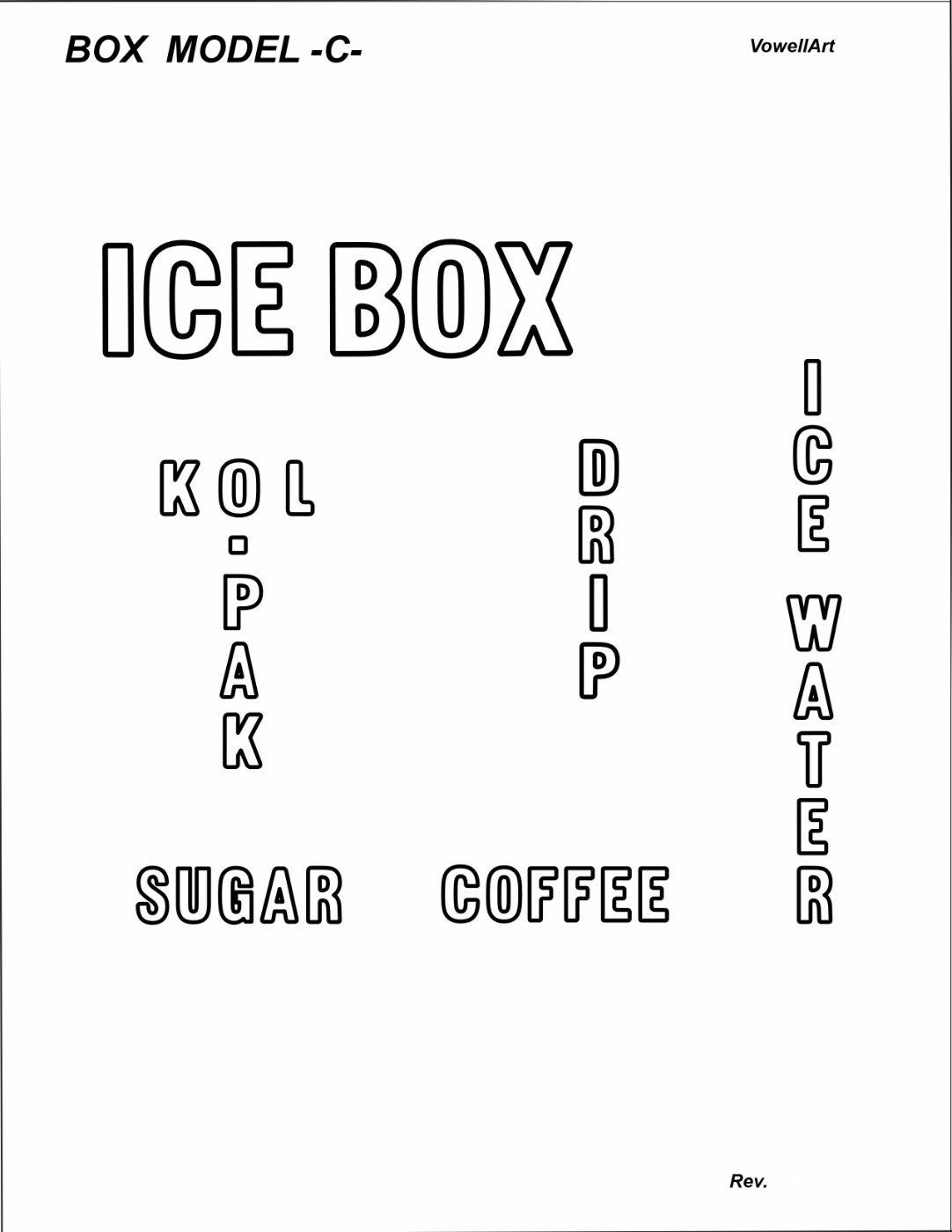

Post by VowellArt » Thu Aug 31, 2023 7:17 pm

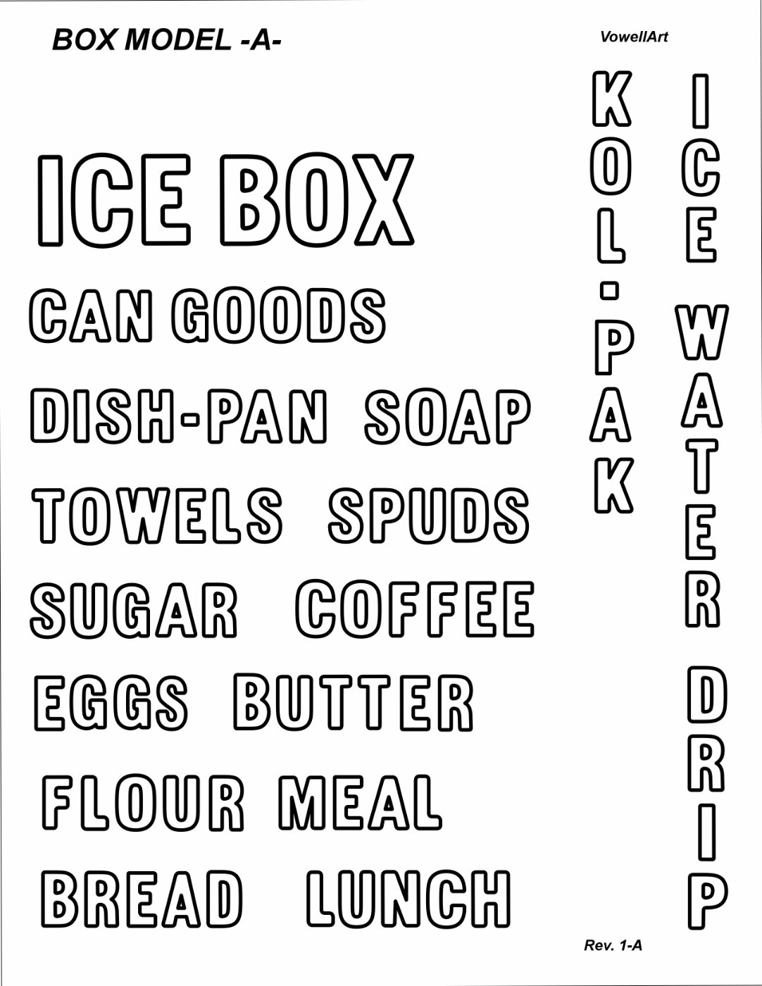

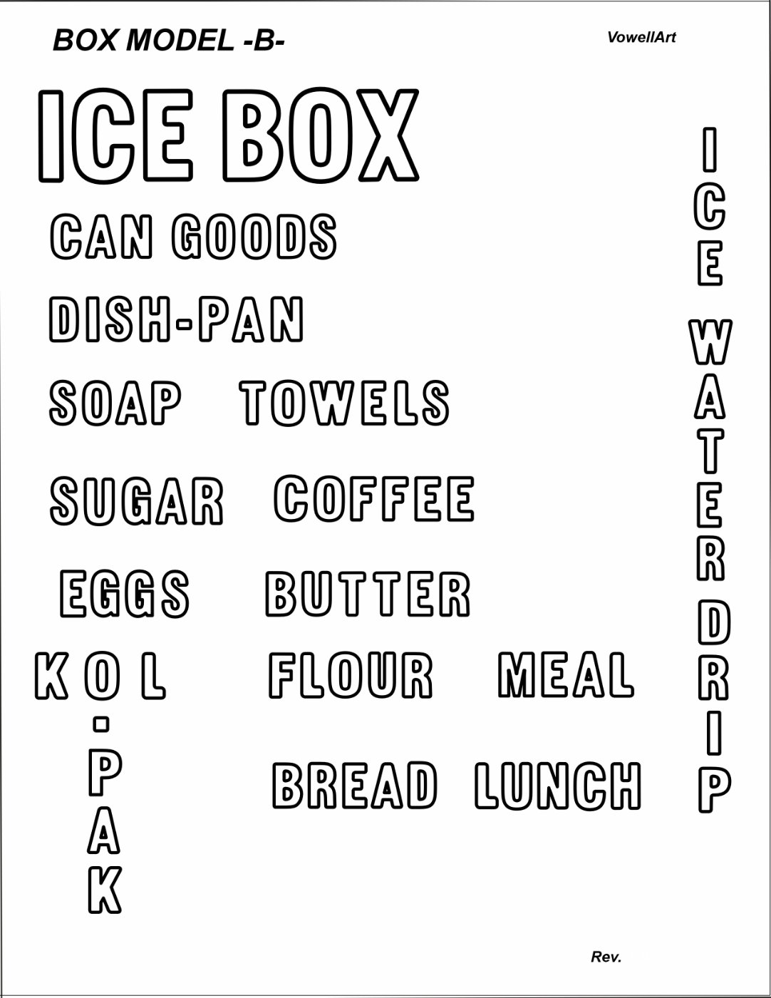

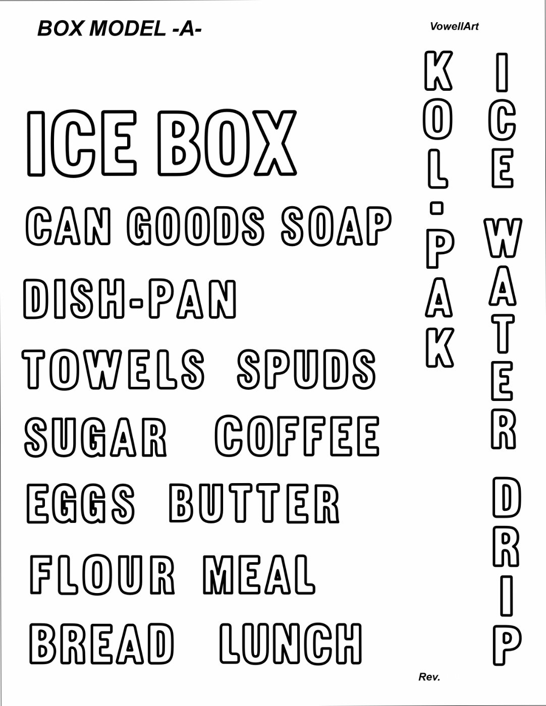

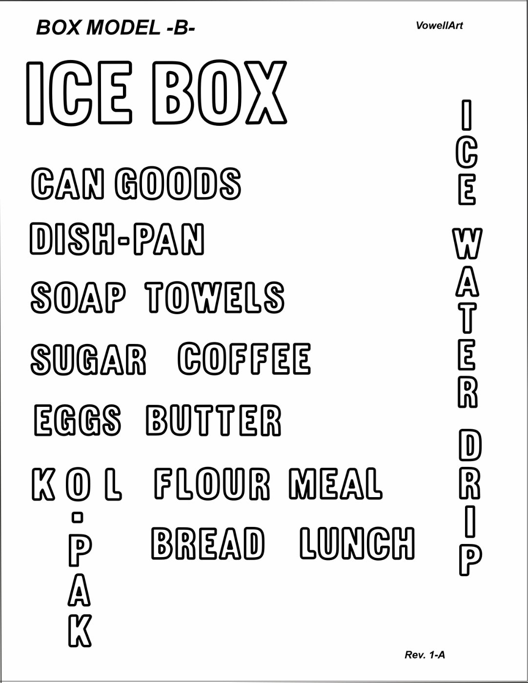

Your text is known as Gothic No13 BT in the "True Type" font case. It's a condensed font, but needs a bit of modification for the middle of the E and the lower arm of the F and the letters have to be outlined not solid. These were probably a "Varnish Transfer" like you see on Piano Fallboards. They would be applied with a thin coat of same color paint and transferred (your pictures seems to suggest this, because the centers of the letters appears to be slightly lighter shade than the rest of the drawer). It takes about 2 seconds to do each drawer that way and the position indexing onto the drawer would be absolute with no possibility of smudging.
I could set this up for you, it would be pretty easy. I have over 1200 fonts available to me and if I can't find it (like if it was a "hand laid font" I can copy it and put it into any format you like. I can even do the lids logo art too. After all, this is what I do kiddies!
Fun never quits!

Paining zinc- I am aware of the issues. That is in part why I was considering not painting.
Zinc and food- I was not aware of the concerns. I know in industrial settings only stainless steel is acceptable. Even painted metal in contact with food is not considered acceptable... For me I was intrigued by the novelty. I plan to keep food not in contact with the metal. I am surprised no one brought up the lead solder joints.

I was thinking this was purhaps rubber stamped paint too. But Martynn seems to be an expert...
Martynn,
I would love to get your help. You are amazing to recognize the correct font! Here are the words on my box (some variation to other ones listed here.)
  • ICE BOX
  • TOWELS
  • BREAD
  • DISH-PAN
  • CAN GOODS
  • COFFEE
  • KOL-PAK (written vertical)
  • DRIP (written vertical)
  • ICE WATER (written vertical)
ICE BOX is 1 inch the rest appear to be 3/4 inch
I would have to research how varnish transfers work, but if you could make this on a PDF I could print and verify size/layout for now.
Thanks everyone!
Matt

Matt, okay so ICE WATER is 1" (72 pt) and the rest are 3/4" (54 pt)?
Ummm, from what I can see, it looks to be all of the drawers may well be 3/4" (54pt), but the 1" (72pt) Is ICE BOX, not ICE WATER (of course if you want ICE WATER that size too, it's your choice). Although I'm not quite sure that the lettering is 3/4" (54pt) of the vertical text is the same as the rest of the drawers, they look a tad short, but who knows maybe it's the angle...just verify those letter heights and give me the length of the vertical text for each string and their line weight (thickness) for both the 72 and the 54 pt type and I'll send you the PDF. Do you want me to post it here or PM you with it?
Oh I noticed on one of the pictures that there are some dots between BREAD and LUNCH, do you want these too? I need to know the size of those dots as well and their spacing. Do you also want the lid's logo? If you do, let me know. It appears be be a paper logo that the paper turned yellow over time (I'm guessing), because of the trim on the border lines and the leftover outside of the line (means it was machine cut and incorrectly indexed) which sort of indicates it to be a paper logo and the paper probably was white, like the unit. The red looks to be Pantone 1797 (Cherry Red) or 485 (Stop Sign Red), can't really tell from a picture though, but either one of those would be so really close to the original....just depends upon how vibrant you want it to be...1797 is more saturate (richer) than 485, being a tad lighter.
I'm going to set these up in CYMK (Cyan, Yellow, Magenta and Black), if you choose to print these on a RGB printer or in Grayscale, let me know because I'll have to change the color register.
I just had a different idea....can you take a full frontal picture of your unit (or if they're not really very visible, just a close up of each drawer would work too? Just their fronts, no angles....don't worry about the size, I'll make the text and fit it to your picture, that way when I enlarge it should the correct (line weights and all).
And send them as Jpgs to my email address vowell@vowellart.com

Frank,
I appreciate your comments. Here are some responses:
Did some searching to find out what paints are food safe. This is a good reference https://painttopics.com/food-safe-paint ... tal-glass/
Looks like Rust-oleum has several acceptable choices, but need to read the labels associated with the pictures to be 100%. The ceramic paint sounds good for the inside of the bins as well as the outside

Post by Matt in California » Sun Sep 03, 2023 12:54 pm
modeltspaz wrote:
Sat Sep 02, 2023 10:16 pm
I used to have one of those running board kitchenettes years ago. I decided that it was just too big for my car, and according to David Woodworth, the one I had was a Model A and the largest one. The Model B was the mid-size and perfect for a Model T running board. Well, enough of that.
Mike, Thanks for the info on the different types of units. Just yesterday I took version of what you described as the model a. It’s a bit of a long story but my brother-in-law purchased it for five months ago when I found it on craigslist near him. For the holiday weekend we met and he made delivery. I remember dad showing no drawers in it and I envisioned it to be the icebox type. It ended up being larger one you mentioned. I don’t think I’ve seen any photos of these on the Internet.
Note: most examples I have seen have a diamond emblem, this has the holes for that, but only used two holes for this rectangle one.
Note: This box was repainted inside and out. The original paint over galvanized metal must have had issues. The repaint of the inside looks really bad, but I like the patina on the outside.
This is 33 inches wide 24 inches tall and 10 inches deep. Icebox that I have is 24 inches wide less than 19 inches tall and 10 inches deep. As you mentioned this style box is much larger. It’s also lighter because it doesn’t have all the drawers and insulation.

Wow! What a wealth of knowledge here on the forum. When I originally posted I was hoping to get some direction to find some ready made decals that would be close enough... It is a learning curve for me to understand making custom decals.
Martynn,
I sent you photos of each decal. I see a few things I misstated above. I thing the photos will answer that. Regarding the paint I saw in early advertising that it was painted with enamel inside and out.

Post by Matt in California » Sat Sep 16, 2023 10:26 pm
We are making great progress with the graphics that Martynn made.
One interesting thing was I found the clear tape would pull off most of the paint showing the original paint. To me it looks like glass antique white would be close.
Yesterday I had a great conversation with Mike. He had an amazing job at the toy company making decals. Hard to imagine that was his full-time job. This was not for production this was for prototypes. As stated in his tagline he really wants to share any knowledge he has. What a blessing for this community and myself in particular!
Mike’s advice was to buy laser decal paper print them out and as he mentioned it will be a multi-step process with the logo. For now, I am waiting for the decal paper. I want to make the decals before I remove all the paint so that I can compare...
Matt

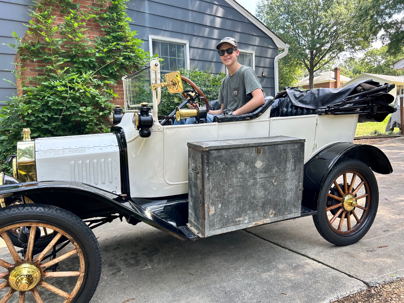

Post by AEyssen » Sat Aug 10, 2024 1:01 pm
We mounted one of our on our 1915 touring. We used a donor running board to avoid drilling holes into our original running board. Fairly sturdy.
1915 Model T Touring

Alex your box looks great! I see you’re is a larger one. Mine doesn’t have much black paint on the outside either. How does the inside look on yours? Feel free to post photos.

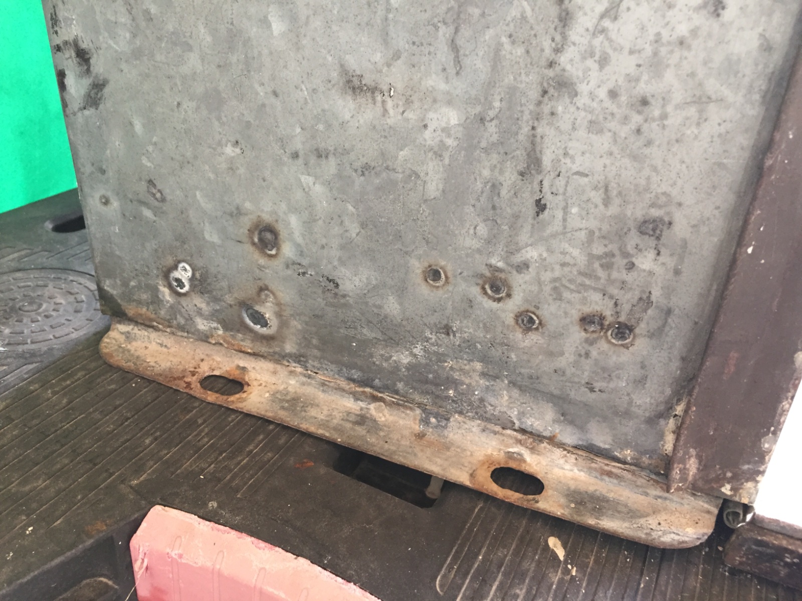

Alex’s post on this thread is timely. Until recently I hadn’t done any work on this since last September.
The hold up has been the need for reinforcing the left side where the bottom had partly torn away, perhaps because someone was sitting or stepping on it.
I was waiting to find a spot welder. When I got one it was only large enough to do the spots close enough. I ended up using my wire feed with a hole drilled in the top sheet then I welded through the hope in the top sheet with a chunk of brass held against the back side as a heat sink to prevent blasting through. The inside space was very tight. But I managed to I got it to hold together.
I then needed to solder back the self that the drawer slides on. I should have ground down the welds, because now that is not an option.
Now the bracket is added.
On the outside it looks fine.

It has been a year and now I have a significate progress photo.
I was able to paint, decal and clear coat the main cabinet. I still need to finish the three drawers and the front and lid. The lid will likely be the last part as I learn how to make a multilayer decal. The paint is not perfect, but I plan to use this, so it will soon get many more defects...
Many thanks to Martynn for the decals. I hope these can be shared perhaps under accessories with the other drawings Martynn made for MTFCA.
Again thanks for all the interest!
Matt

Post by Matt in California » Sat Sep 14, 2024 12:04 am
Before and After
Matt in California
Posts: 786
Joined: Sun Jan 06, 2019 5:42 pm
First Name: Matt
Last Name: G
* REQUIRED* Type and Year of Model Ts owned: 1926 Touring, 1926 Fordor Project, TT C-cab flatbed farm field find, TT dump truck project
Location: California
Post by Matt in California » Sat Sep 14, 2024 12:10 am
More Before and After
Video
Here’s a video I made describing the restoration.
https://youtu.be/_N2BURcOSOo?si=0r_Jk7X9QXmJawBe.
A very special thanks to Martynn Vowell for designing the decals!

Post by AEyssen » Tue Sep 17, 2024 10:05 pm
Here is a pic from last weekend. It got a lot of looks. In looking at the pics of the other kitchens here, I’m apparently missing the inner lids for the ice box and water tank.
I’d love a set of lettering or the source file (I can laser cut them out of vinyl).
We drove 100 miles on Saturday. The kitchen handled great. The lid clasp is missing so I tied the top lid down to prevent it popping up and causing the panel to open up. It’s a fun accessory you don’t see often.

No problem, just tell me what size you need each to be (if you don't know the point sizes, measure their height in inches). I've already got the font set, so I can do them fairly quickly. ;)

Post by VowellArt » Wed Sep 25, 2024 4:41 pm
Did it look anything like this one or the one above?

Post by Matt in California » Thu Sep 26, 2024 12:48 am
Martynn,
I believe the letters are all the same size except for the ICE BOX. I believe 5/8" all other letters. The letter spacing you could do similar to the other words. If you could fit all the words on one 8x11.5 pdf it would be ideal, so anyone could print decals.
Box Model A
ICE BOX
SOAP TOWELS
BREAD LUNCH
DISH-PAN
CAN GOODS SPUDS
EGGS BUTTER
SUGAR COFFEE
FLOUR MEAL
KOL - PAK (vertical)
DRIP (vertical)
ICE WATER (vertical)
Box Model B
ICE BOX
SOAP TOWELS
BREAD LUNCH
DISH-PAN
CAN GOODS
EGGS BUTTER
SUGAR COFFEE
FLOUR MEAL
KOL - PAK (KOL horizonal - PAK vertical)
DRIP (vertical)
Box Model C (I am still looking for an example with all the lettering, but I believe the following is correct)
ICE BOX
SUGAR COFFEE
DRIP (vertical)
In short if you make the words for Model A. The only words perhaps you could make for both is the KOL-PAK both all vertical and horizonal / Vertical.
Thanks!
Matt

5/8" for all the other letters would be pretty small (just a wee bit bigger than 1/2"), you sure you don't mean something a bit bigger, like say 3/4" for those letters. Also not all the letters are the same size....Eggs and Butter for instance are smaller, now they may be 5/8", but the rest of those (with the exception of "ICE BOX" aren't.
Post by Matt in California » Wed Oct 02, 2024 11:45 am
Here are the measurements of the decals you made on my box:
Donnie Could you measure the original decals on your large box to confirm the size?
Thanks!
Matt

Did he measure SOAP, TOWELS, BREAD, LUNCH and DISH-PAN? They look a bit larger than those other letters...it may be an optical illusion and I might be a bit over cautious, but I'd like you to check and make sure, if you could please. :?
Oh and did you also want that diamond logo on the under side of the lid too? If so, just send me a picture of it and give me a measurement of it (length, width).
Post by VowellArt » Mon Oct 14, 2024 12:22 am
Ok, look at these and tell me if they're correct or not.
Camping Box A 1 inch "ICE BOX" and all other letters "5/8" inch.
Camping Box B "ICE BOX" is 1" and all other letters are "1/2" inch.
Camping Box C 1 inch tall "ICE BOX" and all other letters are "1/2" inches tall.
Fun never quits!
Martynn,
Donnie is on a excursion with camping set-up. When he gets back he can get in touch to confirm. But here is my response:
- Donnie asked about the diamond logo and if you could help with that, so he needs do get that to you.
- To me all the line weight looked the same on mine.
- The font size should be the same for everything except the ICE BOX
- Donnie can print the logos and compare (like I did in the photos above)
Thanks so much for your help. I believe others will use the letters because the paint hasn't lasted on many of these for 100 years.
Matt

Post by VowellArt » Mon Oct 14, 2024 7:33 pm
Matt
Made a revision, some of the letters looked a bit narrow for the type face, so had to change them a bit, also added more curves on F and M, also took out the "muddy" look of the letter M (too many extra nodes, which made superfluous curves that just ruined the structure of the letter in comparison to all the other letters). Also changed the line widths back to 0.04 on the Boxes B and C. Having changed some of the letter widths, it changed the parameters vs line width, so, I was able to change them back to the original width without the probable "fill-in", (I hope).
Box A didn't change line width wise, but the letters themselves did (the C, G, D, R, E, F, M, A and S), so got numbered Revision 1-A.
Box B, no changes other than their line widths back to 0.04. Revision 1-A.
Box C, no changes other than their line widths back to 0.04. Revision 1-A.
After looking at these, compare them to my first posting and decide which line width you like better and I'll make the correction. ;)
Fun never quits!

Post by VowellArt » Mon Oct 14, 2024 8:25 pm
Matt,
You mean the diamond shaped logo, like the one here?
That's a metal plate with a silkscreen (and the idiot assemblers put the bloody rivets in the wrong place, they're supposed to be on the outside of the lines, not inside. The image is never supposed to be compromised that's what the curves on the points is for, to locate the rivets OUTSIDE of the image).
There are two ways of doing the logo (maybe one other, but the registration would be really critical and probably impossible).
1) Dye Sublimation, on a piece of white coated aluminum). The image lasts a really long time and is scratch resistant. It's really good for both black and or full color imagining (I used to make Christmas ornaments and funerary remembrance plaques with it, (dye sub my image off on a piece of Nickle Brass, then roll it onto an Engraving Lathe drum, then make any words in black and print on a printer, mount that to the copy drum of the Lathe. and it cuts the black image onto the Nickel Brass, it remove the Nickel from the plaque, revealing the bright brass beneath. The result was a really fancy Christmas Ornament or Funerary Plaque, custom made in full color with gold lettering and or detail imaging like Rosaries, Crosses whatever the client wanted).
2) Laser engrave on a piece of white/black "Rowmark" plastic, any engraving store will have it available and be able to cut it for you (and probably drill the holes for the rivets too), from any file format including Jpeg.
And then there is the 3rd way....print it like you did these other decals you've made. And if you make the 2 color version, you'll have to run it off on a color copier (preferably a laser color printer).
Fun never quits!

Martynn, Sorry for the delay. I finally got a chance to check the measurements. Here is what I found.
1. All small letters are 5/8 inches tall on all three sizes of Kitchenettes. But they can vary in height up to +1/32. The letters even vary on the same Kitchenette. No letters were less than 5/8 inches tall. But most of the +1/32 taller letters were on the medium type B Kitchenette.
2. The words EGGS and BUTTER are 5/8 inches tall but narrower fonts.
EGGS letters are 1/4 inch wide and overall length of word is 1-5/16 long.
BUTTER letters are 1/4 inch wide except the tops of the Ts are 5/16 wide and overall length of word is 2 inches long.
EGGS and BUTTER are on the large kitchenette.
I will post a photo of the EGGS BUTTER drawer and the drawer below it to show the difference in the font spacing.
3. The photo of the silver diamond logo is on the inside of the large type A kitchenette lid. It is 4-1/4 inches long, point to point, and each side of the diamond is 2-1/2 inches long.
4. The photo of the gold logo is on the inside of the medium type B kitchenette lid. It is 3-1/2 inches long and 2-1/2 inches tall.
5. The photo of the front of the small kitchenette shows the letters I was able to reveal with lacquer thinner and steel wool. It is possible to read all the words except the ICE WATER tank letters. But it is reasonable to assume that is what was used on the tank as the other two sizes also used ICE WATER letters.
I believe the best thing to do is to make all the letters 5/8 inches tall except the ICE BOX letters that are 1 inch tall. and make the EGGS BUTTER letters and words to the scale mentioned above. Since the letters are not consistent in size, 5/8 inch seems to be the best compromise. I assume that the spacing of the letters will be what looks good for each word??
Let me know if you need any more info

Matt
After looking at these, compare them to my first posting and decide which line width you like better and I'll make the correction. ;) [/size]
Martynn,
Thanks for your patience in my response. I was talking with Donnie and offered to print him out the decals. But then I realized I needed a PDF version to get the resolution. Is it possible that you could add that here on the forum? If not feel free to email it to me.
Thanks!
Matthew

Post by dobro1956 » Thu Jan 16, 2025 2:35 am
Matt and Martynn, the rev-1a drawings look good to my eye except eggs and butter on the type A do not look like the "scrunched together" letters in the photo of my type A. I believe they have to be "scrunched together" on the type A, to fit into the shorter recess caused by the area for the finger pull handle. As long as the overall length of those words is the same as I mentioned in my post above, I think everything should work OK. It appears that they "scrunched" them to keep the end margins the same or similar in both lengths of recesses to match or appear similar to the two drawers below the eggs/butter drawer. The eggs margin is bigger but probably is a compromise to keep the font the same in eggs/butter words.

Post by Allan » Thu Jan 16, 2025 10:55 pm
Martynn, you're a bit harsh on the "idiot assemblers". The rivets they were given have heads larger than the reliefs in the artwork outline. Perhaps the blame lies with the designer who made the reliefs for the rivets too small. ;)

Post by VowellArt » Wed Mar 05, 2025 7:02 pm
Allan, you're absolutely right, probably not the assemblers fault at all! Probably the Designer/Engineer who drew up the assembly in the first place (I've had my "beat head against wall" moments with a good many of those folks in the past), but even after all the checks and rechecks that their department does, their department heads would send the designs to the "Visual Communications Department". A rather fancy term for Photo, Art, Reproduction and Book Binding....my department , knowing full well that if there was any mistake(s)...we'd find it (and we always did). However it never hurts to have extra sets of eyes on any project, something that Henry Ford left most times to everybody from the engineer who designed whatever part it was on down to the customer who would either fix it themselves or drag it back to the Dealer to scratch their heads over to figure out how to fix whatever it was.
I'm thinking that the reason for rivets of that size is because whatever is on the other side of that lid needed them to affix it firmly to the top of the lid....like a handle to open the lid with, maybe? So maybe what they should've done was make that stupid logo bigger (since they went through the expense of make a silk screen anyway).

Okay, Donnie and Matt; I've had a spot of trouble with my program (the subscription ran out), so I've had to resort to "free trial" versions. The one I'm using currently is the basic one and is seriously limited in what I can do and or how I can do it and since it is a "Free Trial" I've got a limited amount of time to use it (currently 12 days). So what this means is that I've got to finish what I was working on when things went ka-blooy on me and quit. Then I can make whatever corrections you need, post them here for your approval and then translate them into PDF's and send them directly to you guys, how's that sound? I'll also post them here on the Forum as well, but they'll be in JPG format.
If my trail copy quits on me, not to worry, there are 3 different versions of this program and the other two offer a "Free Trial" as well, I'll offload the one I'm using (and would never buy anyway because of it's "limitations" design-wise) and load one of the others and continue on as I've already suggested. One way or t'other we'll get this stuff done! ;)

Post by Matt in California » Fri Mar 07, 2025 11:49 am
Martynn,
I hope all is going well for you. Sorry to hear about your PDF headache!
Donnie and I both agree what you have come up with looks great! I would just need the PDF. (I tried to print what is in the gallery here on the forum and couldn’t seem to get that format to work.) I believe the PDF will keep the crisp lines and size.
Thanks so much!!!
