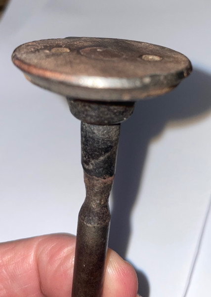

- Posts: 4479
Re: How often do 2 piece valves come apart?
The head does not typically come loose. The stem breaks off, usually due to being necked down from corrosion. Heads are also known to crack and break off chunks.TXGOAT2 wrote: ↑Thu Aug 22, 2024 8:50 amAll 2 piece valves are very old, and most have been abused and many have very high hours on them. Corrosion can get between the valve head and stem when an engine sits idle for long periods, and when the engine is run again the heat will burn out the corrosion and leave the head loose. I wouldn't trust them in an engine that I meant to use. New one piece valves are lighter and flow better and have superior metallurgy and heat flow characteristics.

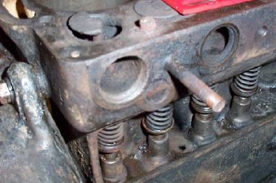

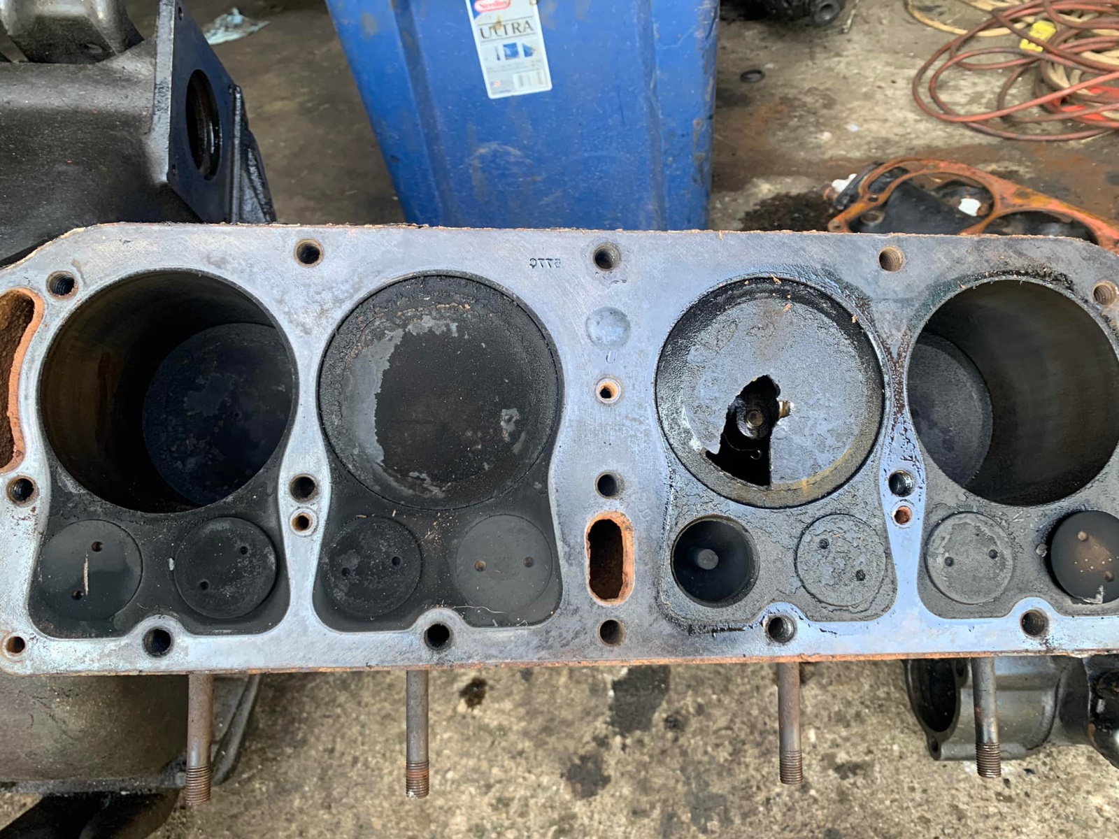

- Posts: 5599
This is what can happen ! I found the rest in the muffler !

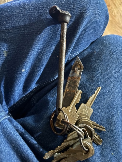

The two holes in the valve head are a indication they are two piece valves but not a guarantee they are. I had one break in my speedster
sitting @ a red light ( idling ) the valve head ended up vertical and broke a hole in the combustion chamber. Found the valve head in the
water jacket of the head. The valve stem was badly eroded from many hard miles so it was weakened. I would defiantly pull the manifolds
& look to verify they are two piece & look at the stems before just doing a valve job for fear of a valve coming apart. I just sent a set of good
looking two piece valves to a friend to put in a engine that had the worst looking valves I've ever seen that none of broke. He has been
running Model T's for a long time & never had a valve break & has no worries about running them. I know of people that will not run them
( two piece) for fear of them breaking as well as some that remove the magnets for the same reason. I know this doesn't help much if you
are looking for a do it or don't answer. Hope it gives you some info on the subject.

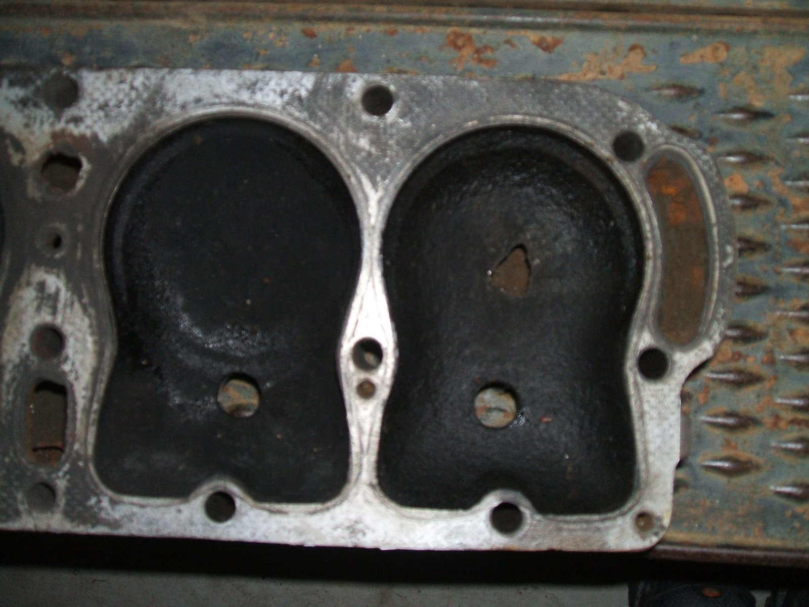

If the valve head just breaks, that's one thing. It's when the broken piece punches a hole thru the top of a piston that things go downhill quickly.
- Posts: 4090

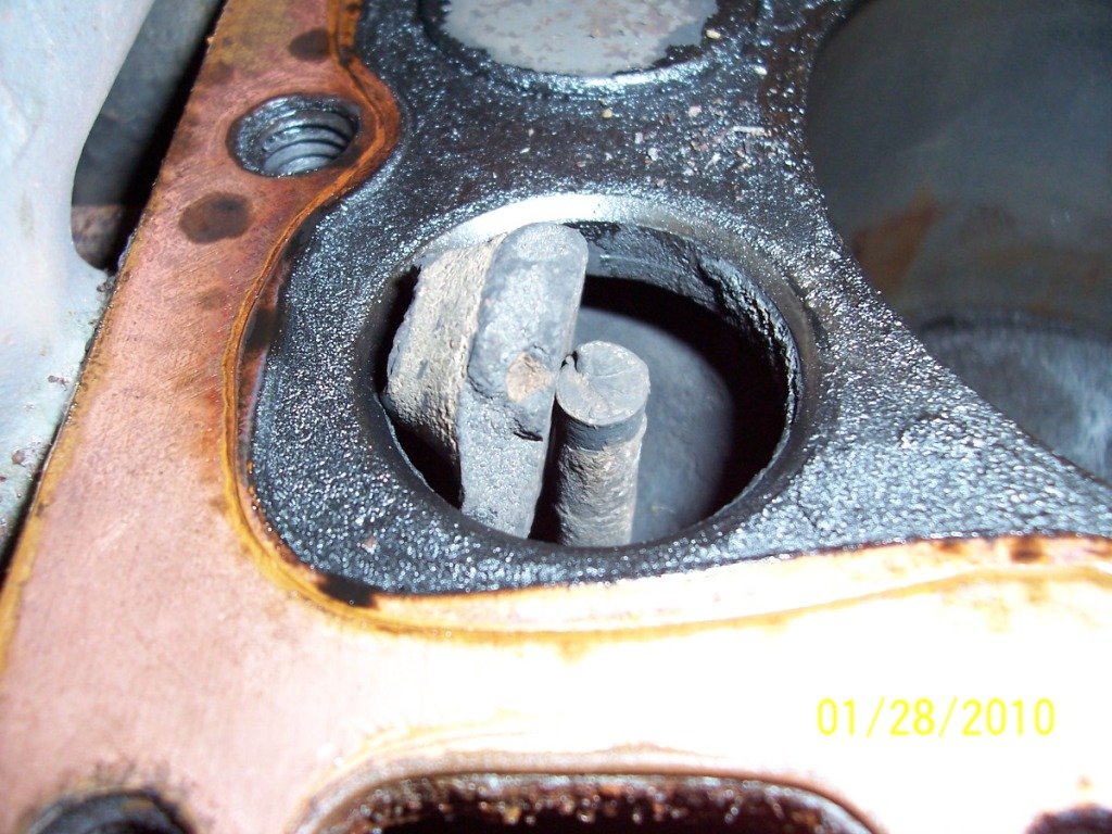

Quite a few photos have been posted on the Forum over the years showing such damage. Those old iron head, steel stem valves should come out, always, if you want to save yourself some grief.
Steel stem burned away by intense exhaust heat, that iron head resisted though, may be because the higher quality iron used for the 2-piece heads, better than the iron used in the blocks?
Another stuck 2-piece, at #4 , cracked off from the grinding recess holes. Also ran a while to ruin the seat. Hot exhaust.

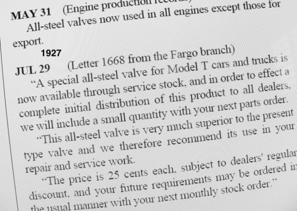

- Posts: 8663
Very late, as I recall. There is a service letter or dealer letter somewhere that discusses it. I don't remember all the details. Unusually, Ford advised dealers to return unused stocks of any of the 2 piece valves on hand and to use the new one piece ones for service as soon as they were available.
The info is online, here or the Cimorelli site, or another well-known one.
- Posts: 4090
TXGOAT2 wrote: ↑Sat Aug 24, 2024 3:41 pmVery late, as I recall. There is a service letter or dealer letter somewhere that discusses it. I don't remember all the details. Unusually, Ford advised dealers to return unused stocks of any of the 2 piece valves on hand and to use the new one piece ones for service as soon as they were available.
Very late indeed

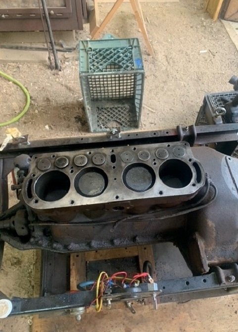

My engine was completely rebuilt but had not been started when we got the '21 Touring in 2016. After about 10-12 hours running time a small pie piece shaped chunk of the #1 exhaust valve head broke off. It made some minor pock marks on the top of the piston and head. The piece(s) apparently went into the exhaust pipe or muffler. I replaced all eight valves with new one piece valves. I had my local machine shop shorten the stems because our engine has been fitted with adjustable tappets. It has ran great for another 8-10 hours.
NoelChico
Topic author - Posts: 312
- Joined: Tue Jan 08, 2019 10:42 pm
- First Name: Noel
- Last Name: Chicoine
- * REQUIRED* Type and Year of Model Ts owned: 1920 roadster, 1923 Touring, 1926 Coupe
- Location: Pierre, South Dakota
After a week of travel and other duties, I pulled the intake on the 16 with the 26-27 engine and watched the valves as my pretty wife hand cranked the car. DARN! It has the 2-piece valves.
Now for more decisions, but nothing solid until after the OCF with the Gumbingers.

The #4 exhaust valve broke in my 1914 right after I’d gotten it running in 1994. I didn’t know this was common so I just replaced the one and made a keychain. I’ve ran it since with the other 7 still there but I’ve got a new set of valves for my speedster engine I’m working on now.

Been there - done that. I'll never hessitate to replace the 2 part valves. It costed me a head.
Ford Model T 1914 Touring
