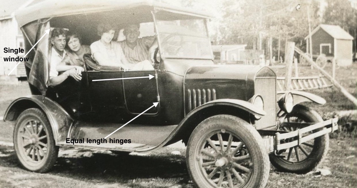

Re: Manufacture date of my wife's Touring Car?
Good to have a mystery solved
Here is simple way to i.d. the 1925 model year Ford. Single pane rear window. Equal length hinges on the front door., '24 and earlier have longer length lower door hinge.

- Posts: 4481
Here’s a 25 door hinge to look at closer opened up. You can see that it’s straight as Dan says.
First, there are no numbers stamped on the frame rail.
Second, both upper and lower door hinges on the passenger side measure 1.75". Provided the car is not a "put together", it's a '25. Right?
My goal is not to prove the year the car was manufactured, I have a PA title from the previous owner stating it's a 1925 model. I'm just attempting to find out if it's a '25 that was assembled in the last months of '24, If that is the case- the car is 100 years old, almost.
I may be mistaken, but I think the '25 models produced in 1924 also had the equal door hinges?
Another thing most people don't know, is the 1925's used the clipped patent plates just like the 1926's. There are many more features.
