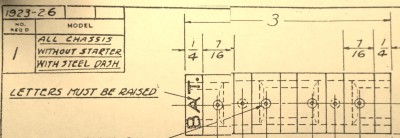

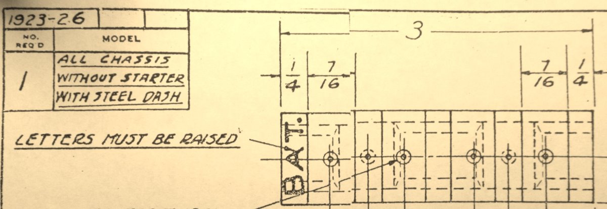

Would the later non-starter car, those with the firewall terminal block, have an electric tail light as shown in drawing #3? Or would it just be the oil tail lamp?
Rich C.
Rich C.
- Posts: 4099
Re: Model T Electrical Schematics Available
As noted by Bob:
After 1916 there are overlaps and many exceptions as to which drawing applies to what year and what model.
As everyone in the Model T community knows - for every absolute fact there are at least three exceptions.
An oil tail lamp would be supplied with non-starter open T's, as there is no storage battery. But in the later years, when the T was around a while, many owners installed storage batteries, so even Ford knew that. The terminal block shown is the 4 lug, and the left side was reserved for BAT, in case an owner installed a battery. This terminal block is for the steel dash, '23-'27 open car non-starter.
1926 runabout, non-electric, would have magneto head lamps, and you can see the oil tail lamp. And non-demountable clincher wheels
Open car / bare chassis, non-starter terminal block for steel firewall
