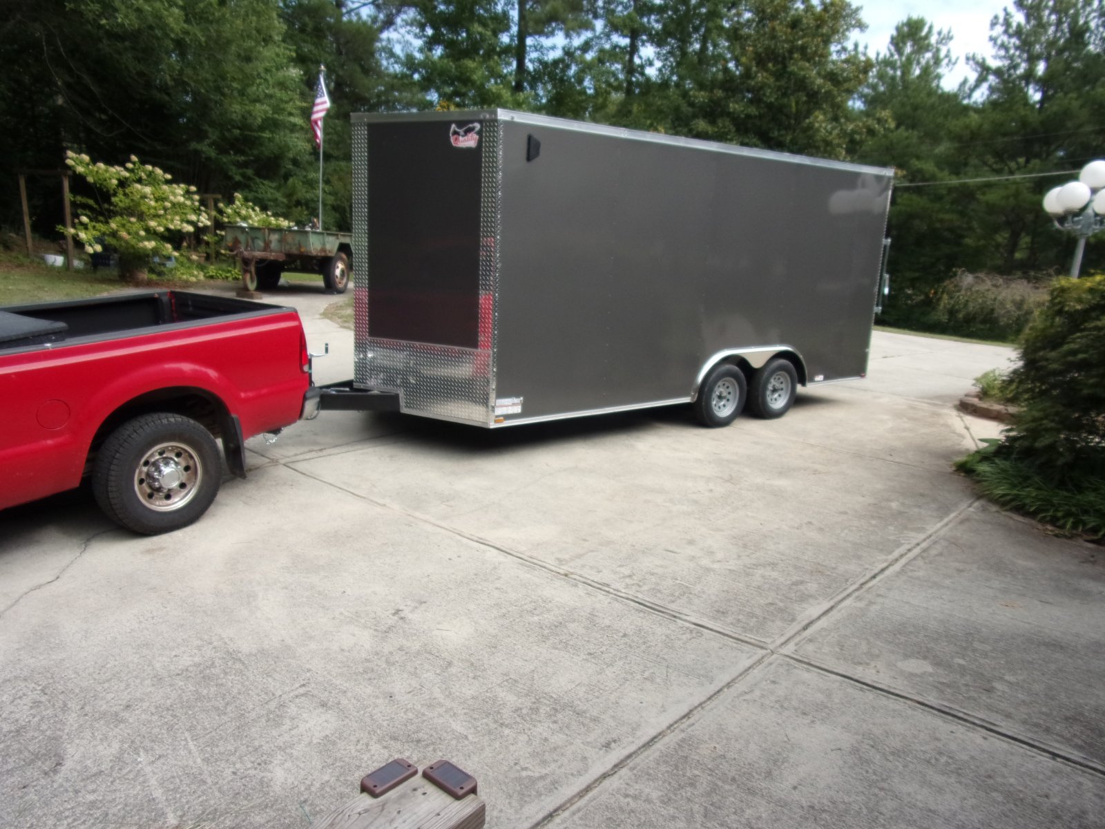

After constructing WWI ambulance project to the Ford plans, my overall height was 81" and the top is permanently attached. So, no issues until I start to look for enclosed trailer to transport and store this thing. Seems most standard enclosed trailers are not tall enought for most Model T's unless the top is lowered and the windshield is removed or moved out of the way.
So, it took a custom built enclosed trailer with a rear door height opening of 87", an interior height of 7.5 ft, a length of 18 ft and a width of 8.5 ft to allow me to enter the ambulance from the interior of the trailer to steer in and out. It will get winched in and out of the trailer and the floor of the trailer is slanted at the end to allow for shallow ramp door angle.
Mounting winch and painting plywood floor this weekend. Looking forward to loading and getting all the strap points figured out. I've been reading forum posts on winch cable attachment and tie down points.
Just didn't figure on a custom trailer, but at least I didn't have to take an ax to my garage door bricks like Henry did.

I had the trailer scratch built from my requests and it was ordered last Friday and picked up this Friday, so a seven day build. Polycor panels and I had them weld in a winch plate up in the V nose to the trailer frame. They wanted $1,500 for a winch and I can purchase a 12k winch for under $300 and purchase a battery and ABS battery box and install the winch myself. Keyless remotes on the winch will allow me or my wife to sit in the T and winch ourselves into and out of the trailer.

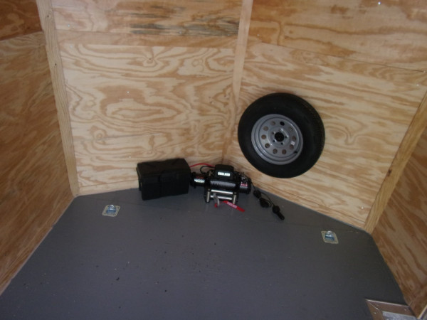

Spare tire mounted up in the V nose, but not much storage room left over. I'm designing in my head two 10" deep storage cabinets to mount up in the V nose area to hold tow straps, tie downs, spare tools, etc.
Trailer Plus wanted over $14k for this trailer and a six week build date and I paid less than $8k for this trailer out the door.
It's only been one day, but I'm a happy camper with it.

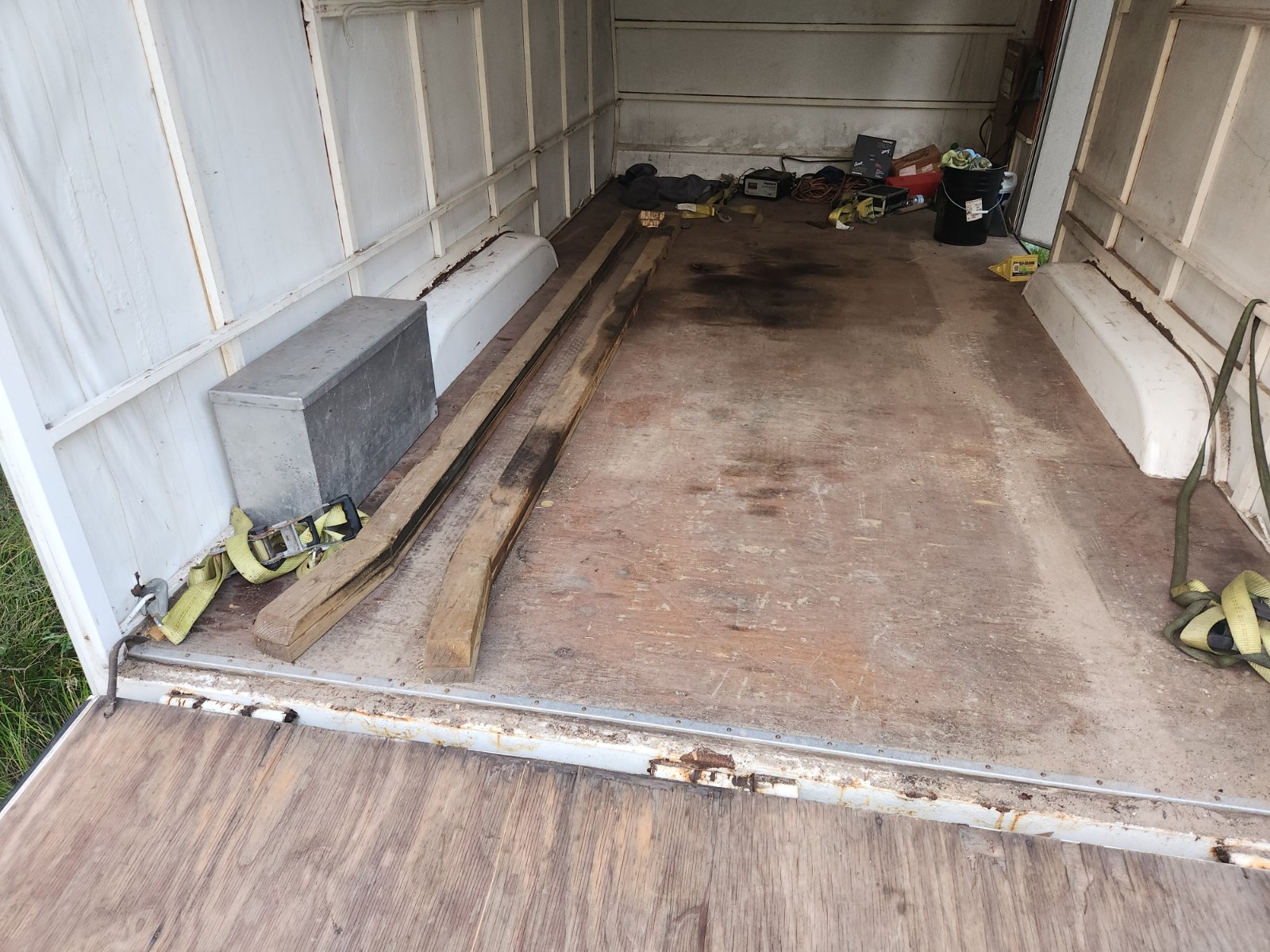

I've seen boards screwed to the floor to secure a car as noted above, seen one gentleman trip over them, getting hurt falling against the wall and debris stored in trailer.
Also was at a large tour and was there when a gentleman opened his trailer and found his car against the side wall, damaged. He had crossed his straps one of the front ones came loose, the other went slack to that side and car bounce to wall.
My opinion two straight forward two straight back. One comes loose still pulling straight.

I purchase a 9,000 lb winch to mount inside up near the V nose along with a ABS marine battery box to bolt down to the trailer floor to hold the winch battery. I also want to wire in some led lights running off this winch battery as the trailer interior lights only use the tow vehicle power and the truck lights need to be on for the interior trailer lights to be on and I'd like to have some lights that operate independantly for when strapping down and getting the vehicle ready for transport without running the tow vehicle or it's battery.
I want to connect a trickle charger to the winch battery and run the power cord out through the bottom of the trailer so that I can plug it in from outside the trailer and not have to open the trailer up to charge the winch battery.
After winching the ambulance in for the first time I want to look at some storage cabinets or ammo box storage to hole straps, tie downs, tools, etc.

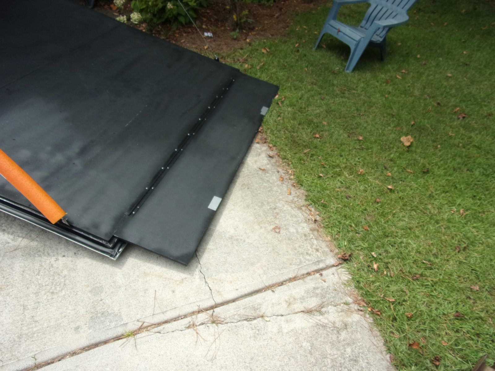

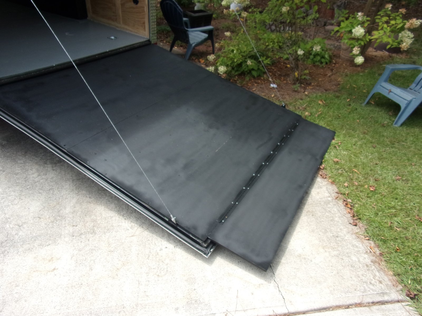

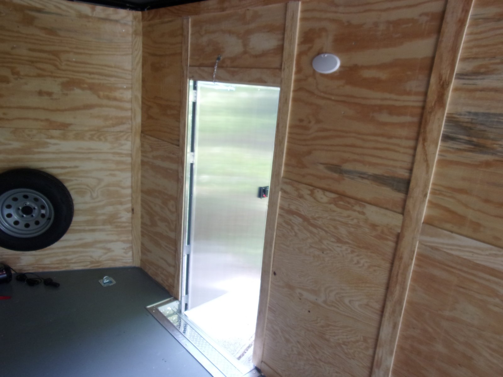

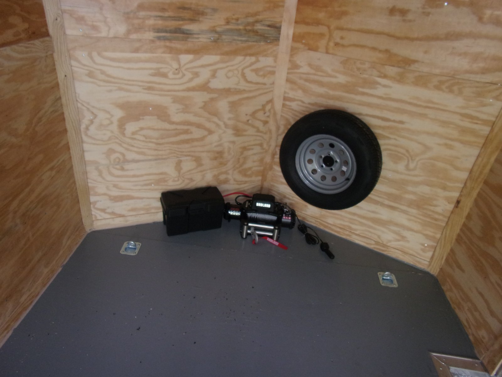

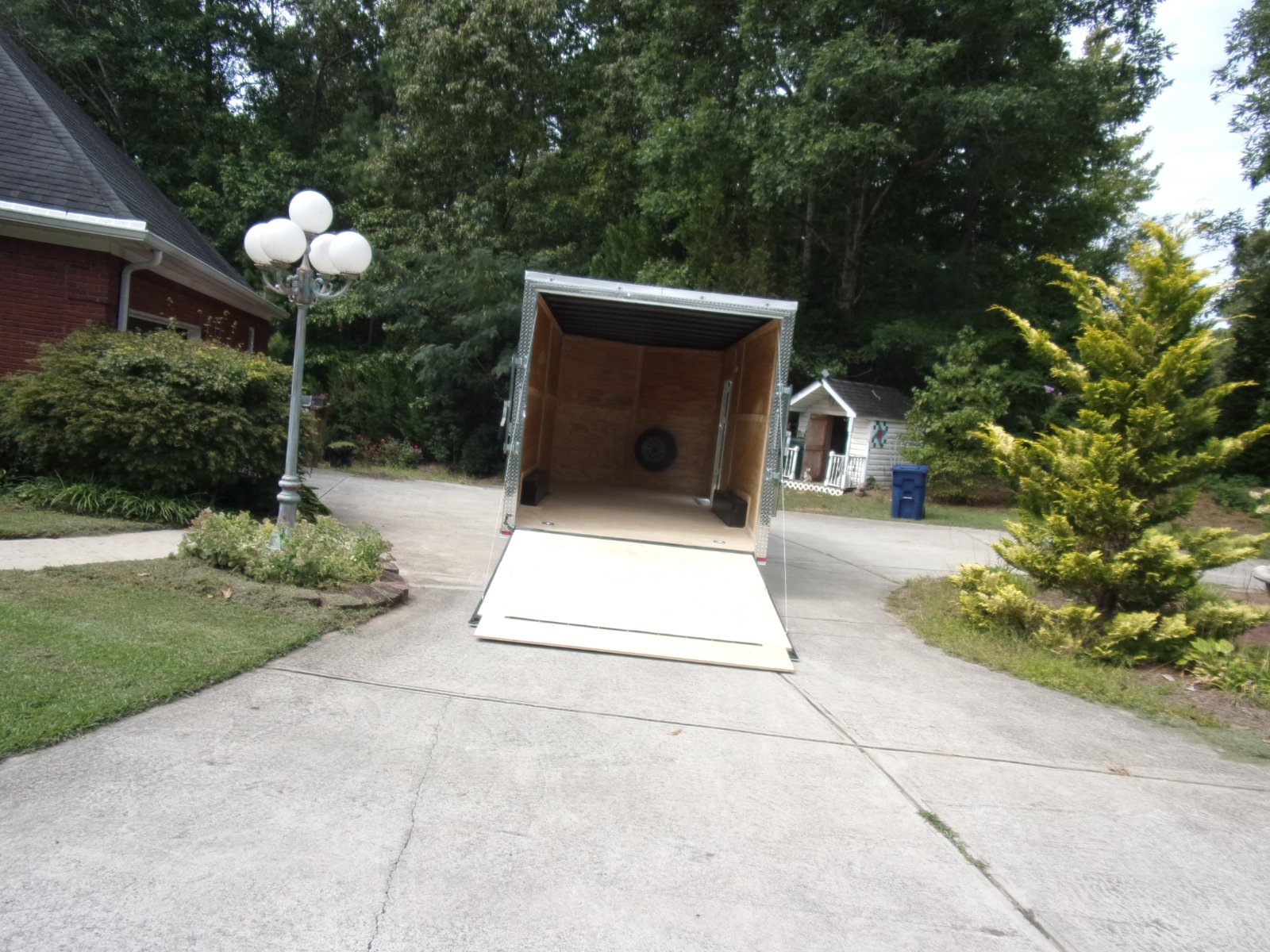

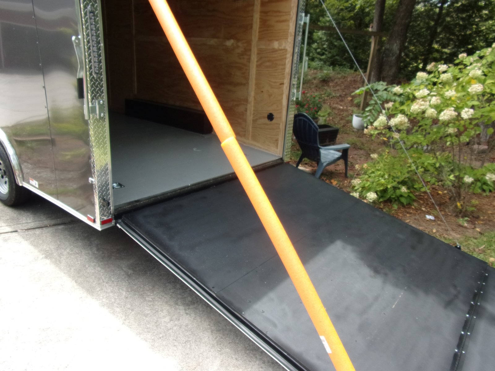

Just an update to kind of wrap this thread up...still need to actually winch ambulance into this trailer, but no better time to take some pics.
Rear tail gate ramp and extension were coated with bedliner. Duct tape at end indicates tire initial line up position and pool noodles over rear door cable keeps me from walking into them.
Interior floor is porch/deck grey enamel. After checking out interior lighting, we may paint interior walls gloss white.
9,000 lb winch on 12v battery. Winch bolted through floor and through winch plate welded to frame tongue.
Side door is nicely located to, hopefully, ease into and out of the passenger side of the T.
I'm holding off on Etrack for now, a couple of concerns. I'll just go with the four corner D rings attached to frame rails for now. Short trips to and from car shows and local display events. Not planning on long road trips.
I've got to come up with some storage for straps and tie downs. They are all in pick up truck tool box for now, but I'd like to come up with something interior, but looks like walls of V nose section is only available space
Thanks to all for input and suggestion s on this investment.
