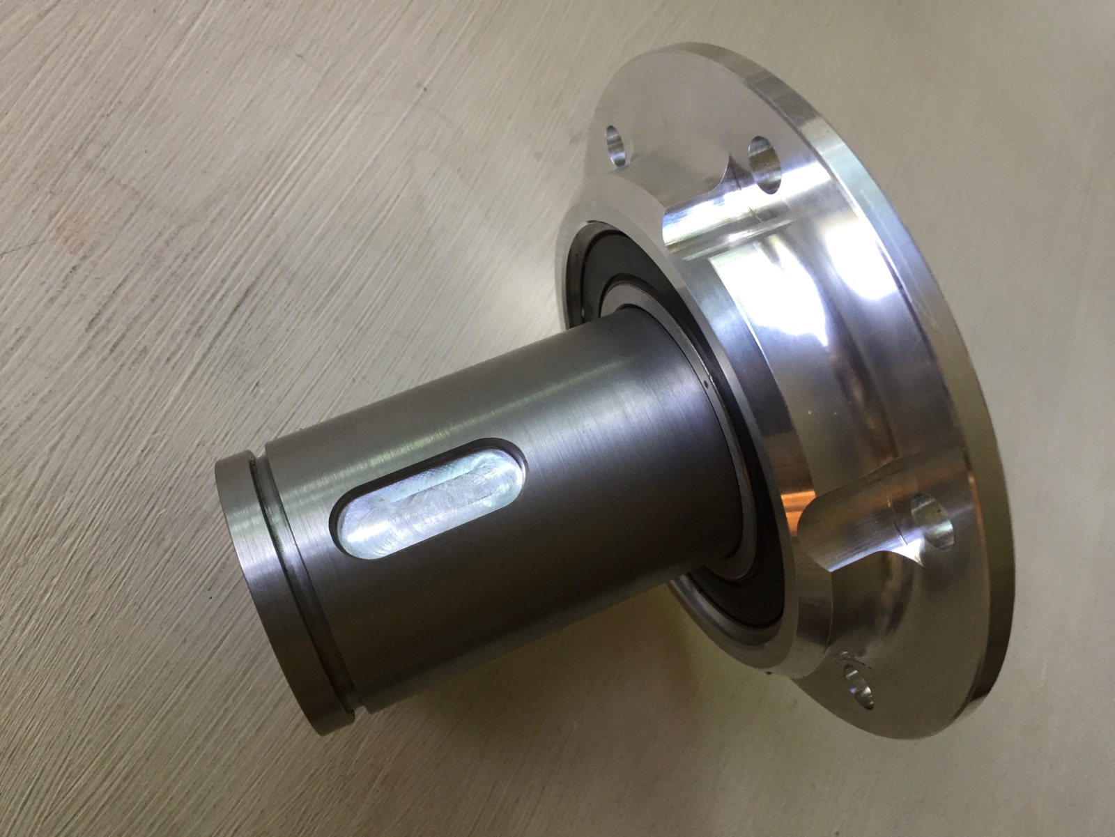

- Posts: 1642
- First Name: Kevin
- Last Name: Pharis
- Location: Sacramento CA
Re: How are your floating hubs (from years ago) holding up?
Yup, made up a handful of sets for myself and few of the local strays a while back. They were based upon a sketch from an old T club magazine (‘70’s) my dad has. Not exactly a “safety” hub as the bearing is not fully retained to the spud, but I did stake the bearing to the spud to prevent it from coming apart in the event of axle failure. No problems yet…

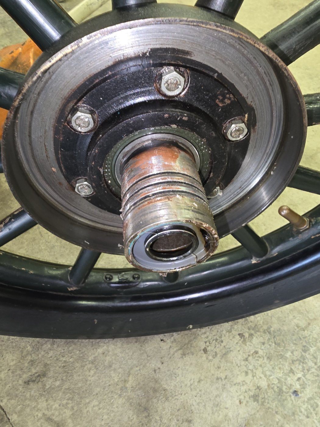

- Posts: 4694
The idea is good, however your drum looks like the brake shoe was scraping inside. Either something wrong with the shoe or the wheel was pushed in too far. That problem should be addressed if you are going to keep those floating hubs.
