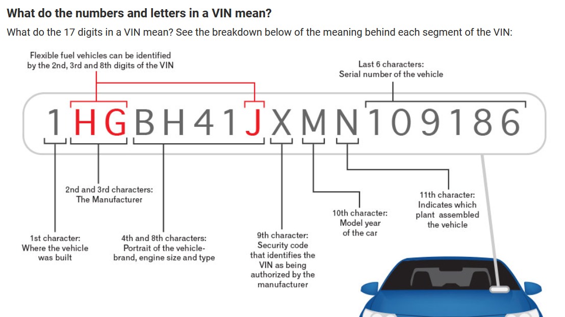

I agree with the above except for defaulting to using the engine number. If you would sell your car the VIN number on it needs to match a number on the car somewhere.. The Title indicates who owns the car described. Back in the day, Make, Model and serial number (engine number or body number) were used by various manufactures. State filing systems used all three attributes.Steve Jelf wrote: ↑Fri Aug 30, 2024 3:32 pmBeginning December 10, 1925, the VIN is stamped on top of a frame rail under the floor board, usually on the right but sometimes on the left. Before that date the engine serial number stamped above the water inlet is the VIN. Adding a separate tag, on the firewall in front of the passenger will do. Your additional tag should have the engine serial number, unless special circumstances dictate otherwise.
Today the VIN serves as the car's fingerprint, as no two vehicles in operation have the same VIN. A VIN is composed of 17 characters (digits and capital letters) that act as a unique identifier for the vehicle. Now if you look at your Title the values in the VIN field likely begin with just numbers.
But now A VIN displays the car's unique features, specifications and manufacturer (except for pre 1954 cars). So there's the rub, if owners of pre 1954 vehicles use just the serial number (engine or body) there is a chance of a conflict where some Chevy was already registered with the same number 8077073.
