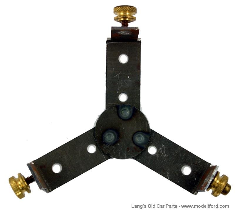

When mounting a Jno Brown carbide generator to the running board (on a 1912), is there a bracket that is used (like the E&J bracket shown in the Lang's picture) or does the carbide generator bolt directly to the running board? If no bracket, is there a pad or something underneath the carbide generator or just bolt straight to the running board?

Prolly shouldn’t reply with a 1913 answer - no clamp, bolt directly to the running board. Maybe ‘12 is different ?
