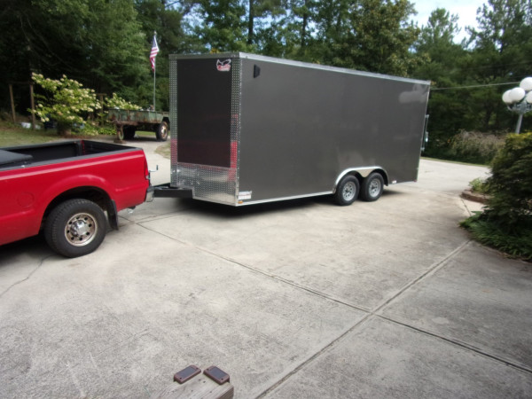

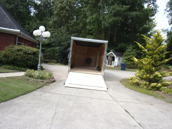

Now I Know How Henry Felt. Enclosed trailer thread.

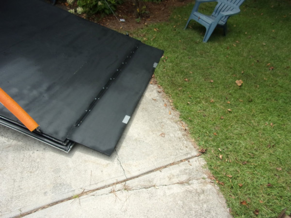

After constructing WWI ambulance project to the Ford plans, my overall height was 81" and the top is permanently attached. So, no issues until I start to look for enclosed trailer to transport and store this thing. Seems most standard enclosed trailers are not tall enought for most Model T's unless the top is lowered and the windshield is removed or moved out of the way.
So, it took a custom built enclosed trailer with a rear door height opening of 87", an interior height of 7.5 ft, a length of 18 ft and a width of 8.5 ft to allow me to enter the ambulance from the interior of the trailer to steer in and out. It will get winched in and out of the trailer and the floor of the trailer is slanted at the end to allow for shallow ramp door angle.
Mounting winch and painting plywood floor this weekend. Looking forward to loading and getting all the strap points figured out. I've been reading forum posts on winch cable attachment and tie down points.
Just didn't figure on a custom trailer, but at least I didn't have to take an ax to my garage door bricks like Henry did.

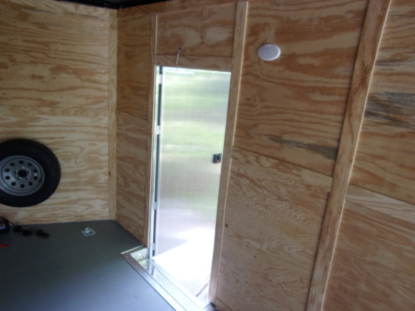

Re: Now I Know How Henry Felt. Enclosed trailer thread.

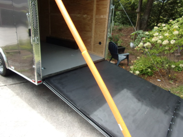

I had the trailer scratch built from my requests and it was ordered last Friday and picked up this Friday, so a seven day build. Polycor panels and I had them weld in a winch plate up in the V nose to the trailer frame. They wanted $1,500 for a winch and I can purchase a 12k winch for under $300 and purchase a battery and ABS battery box and install the winch myself. Keyless remotes on the winch will allow me or my wife to sit in the T and winch ourselves into and out of the trailer.
Spare tire mounted up in the V nose, but not much storage room left over. I'm designing in my head two 10" deep storage cabinets to mount up in the V nose area to hold tow straps, tie downs, spare tools, etc.
Trailer Plus wanted over $14k for this trailer and a six week build date and I paid less than $8k for this trailer out the door.
It's only been one day, but I'm a happy camper with it.

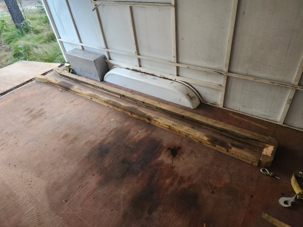

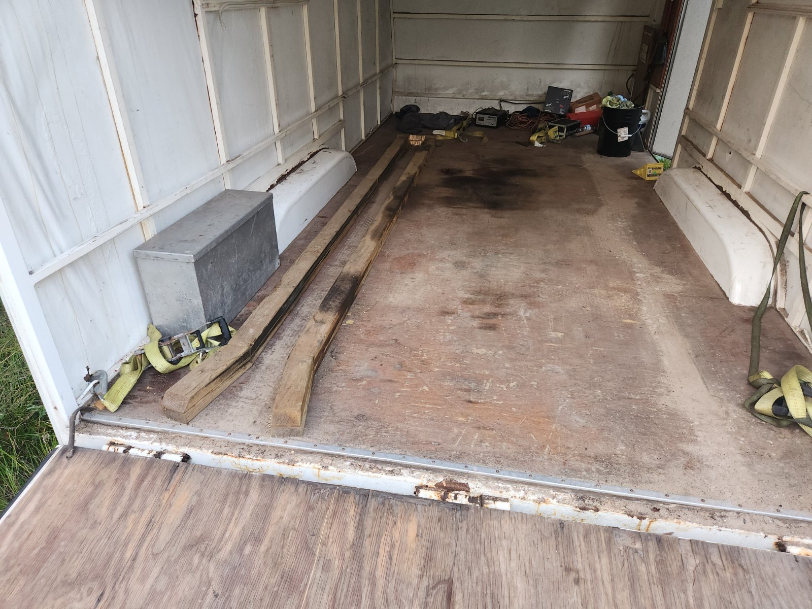

Here's what I did, so that I can haul the 27 Fordor. The 30 Fordor is a bit longer, so I removed a bit of the front wheel-stop. I thought it would make it un handy to use the trailer for hauling lumber and furniture, but it's no problem.

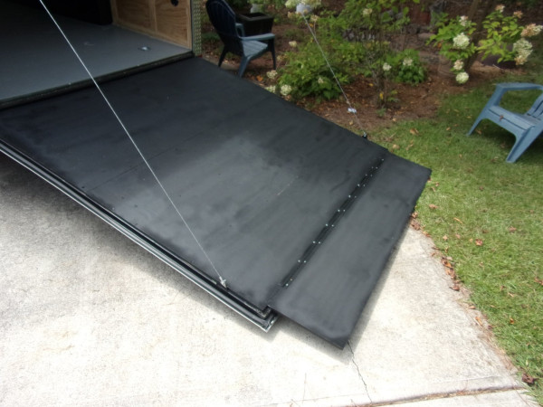

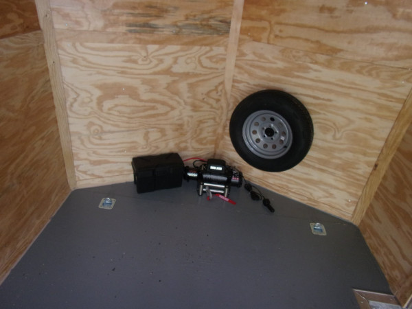

My ambulance is 6/5 ft wide and my trailer rep suggested the 8.5ft interior width. It is almost recommended for all 18ft long or longer trailers anyways, so I went with it. It is a car hauler floor configuration which means the rear floor slopes down towards the rear and the drop down ramp door does not have to angle all the way up to the flat cargo floor. So easier loading and unloading and less strain on the door. But, the fender wells do come up into the interior floor and reduce the width between them to about 7 ft, so be mindful of that. My wheel axle width is not the width of the T as the fenders and, in my case the side wooden guard rails stick out past the wheels and tires, but it is at a higher level than the fender wells.
We are painting the interior flooor with porch and deck paint today and tomorrow and then rollling on bedliner material on the door ramp and ramp extension for grip and moisture protection.
I purchase a 9,000 lb winch to mount inside up near the V nose along with a ABS marine battery box to bolt down to the trailer floor to hold the winch battery. I also want to wire in some led lights running off this winch battery as the trailer interior lights only use the tow vehicle power and the truck lights need to be on for the interior trailer lights to be on and I'd like to have some lights that operate independantly for when strapping down and getting the vehicle ready for transport without running the tow vehicle or it's battery.
I want to connect a trickle charger to the winch battery and run the power cord out through the bottom of the trailer so that I can plug it in from outside the trailer and not have to open the trailer up to charge the winch battery.
After winching the ambulance in for the first time I want to look at some storage cabinets or ammo box storage to hole straps, tie downs, tools, etc.
Looked at Harbor Freight Etrack parts and pieces as well. Maybe down the road. If I haul two different vehicles with two different tire widths, it looks like I'd have to install Etrack for both vehicles as the tire cages line up with the tires and Etrack. Things to ponder...

Just an update to kind of wrap this thread up...still need to actually winch ambulance into this trailer, but no better time to take some pics.
Rear tail gate ramp and extension were coated with bedliner. Duct tape at end indicates tire initial line up position and pool noodles over rear door cable keeps me from walking into them.
Interior floor is porch/deck grey enamel. After checking out interior lighting, we may paint interior walls gloss white.
9,000 lb winch on 12v battery. Winch bolted through floor and through winch plate welded to frame tongue.
Side door is nicely located to, hopefully, ease into and out of the passenger side of the T.

I highly recommend painting the walls white. It makes a huge difference inside.
