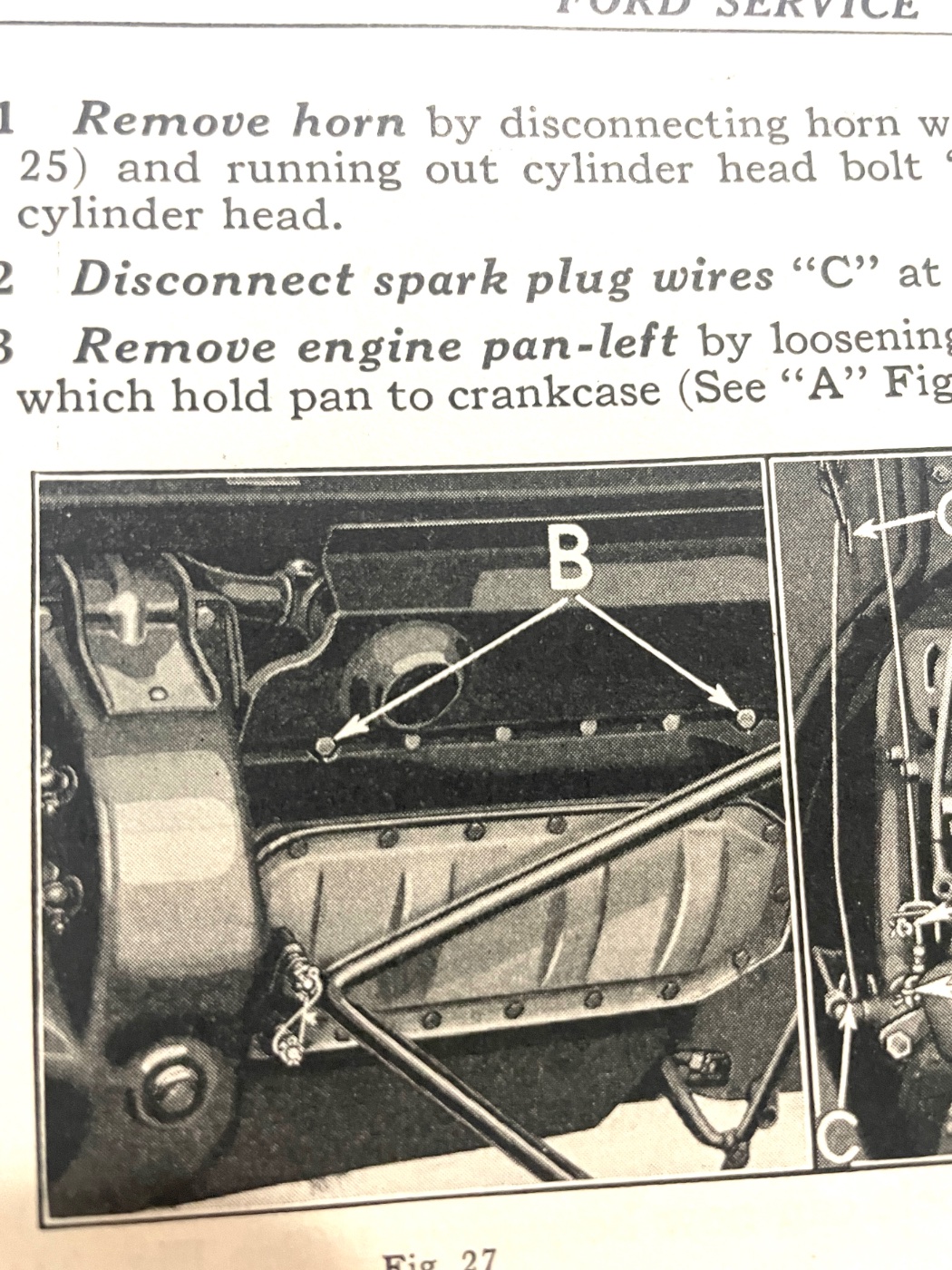

Looking to install my recently acquired pans.
Do they sit on the bottom rail of the chassis or underneath?
Any insight much appreciated.
Thanking all in advance!

Our '19 Centerdoor has them attached to the bottom rail - underneath.

Post by DanTreace » Tue Sep 10, 2024 6:04 pm
RajoRacer wrote:
Tue Sep 10, 2024 10:56 am
Yep. Ford Service shows good pic of the pan against the underside of the frame rail.
