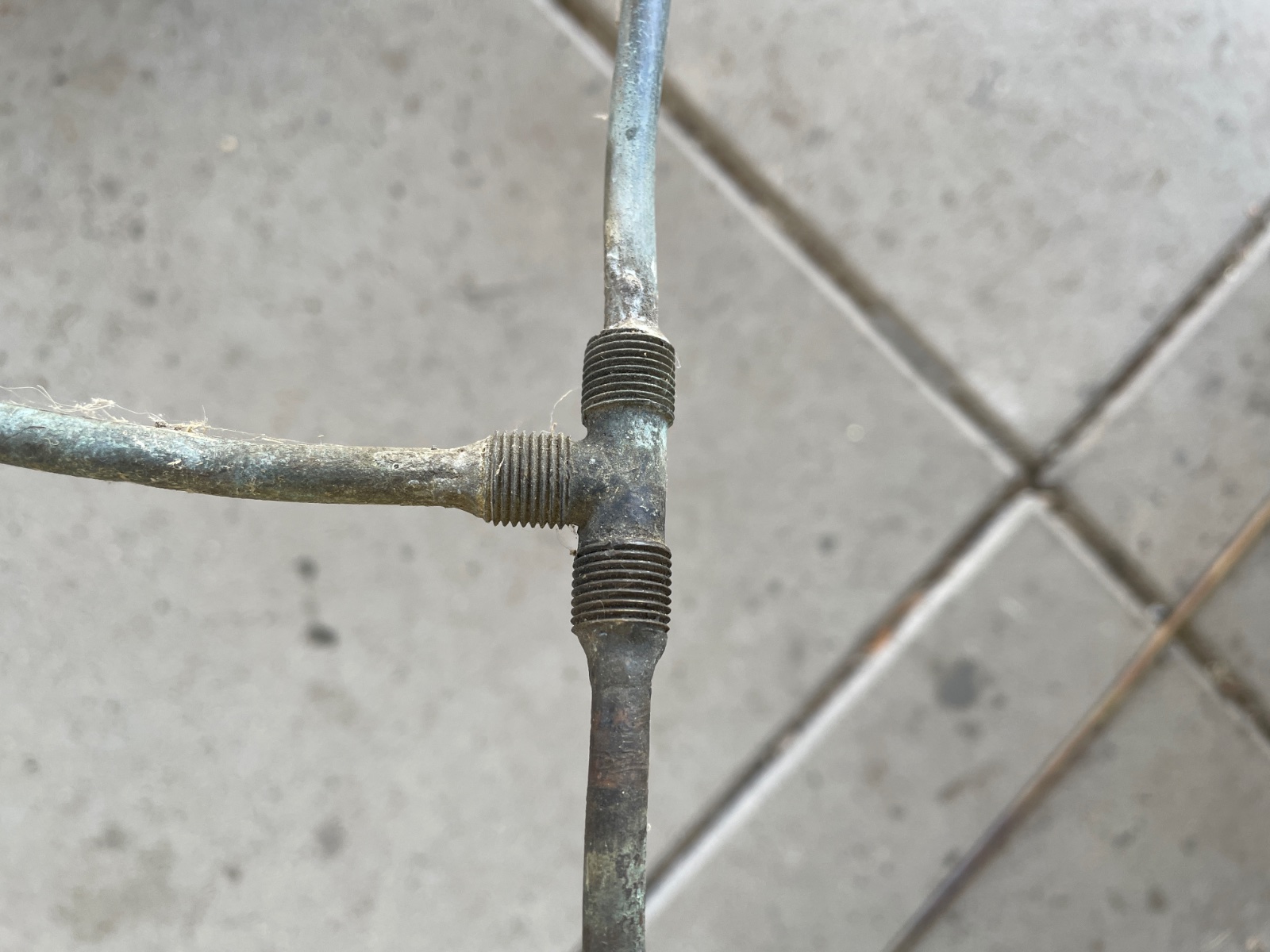

Post by ryanpad » Thu Sep 12, 2024 1:30 pm
Thanks for all the great input.
Here’s some pictures of the acetylene line and the end of the fuel one that I need to replace.

Okay so dimensionally they are the same but the fuel line that came on my car is brass and the acetylene line is copper.
Posts: 4407
Re: Tubing
Post by Wayne Sheldon » Thu Sep 12, 2024 6:25 pm
That "copper? colored line could be in fact a copper colored brass. The color of brass is dependent upon the specific mixture of the brass alloy. Brass is mostly copper and zinc, but sometimes have other metals or chemicals also to give it different working characteristics. The amount of copper versus brass makes a big difference on its color.
Bright brass was used for its appearance on the radiators and lamps as well as some other visible pieces. Darker copper colored brass was often used on items that appearance wasn't so important. The early brass top coils for instance, were originally stained flat black. So the color of the brass didn't matter. A large percentage of them were originally copper color. People today of course like to leave them polished brass color and some have even brass color plated the ones that were originally a copper toned color for the look they want.

Thanks Wayne, So where I’m at now is I’m reusing the gas pipe ( fuel line ) that came on the car. I’ve trimmed back both ends that presented a potential leak path removing 1” +\- and added in a petcock just at the carburetor per a well respected club member’s advice. Kind of a two birds thing. I do now have an acetylene line that’s up for grabs. It seems to be made to go under the radiator? Free to a good home.
