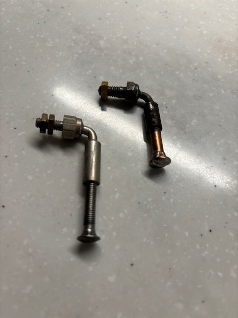

If I correctly understand the terminology in Larry's original post? If not ignore this!
Attached is a photo of an original Ford spark and throttle rod end swivel (depicted at right) AND reproduction rod end swivel (at left).
The male and female ends threaded ends on the original Ford item are 12-32. You can find this same thread on the ignition coil four point mounting bolt and nut hardware. Not uncomon to me
The reproduction swivels (depicted at left) (which are currently available) are 10-32 thread on both male and female ends can be found on the coil point gap spring adjuster/lock nut bolt . Some can be found with a hole on the male end for a cotter key.

Thanks for posting the correct thread size! I couldn't find tap or a die in my stash!
