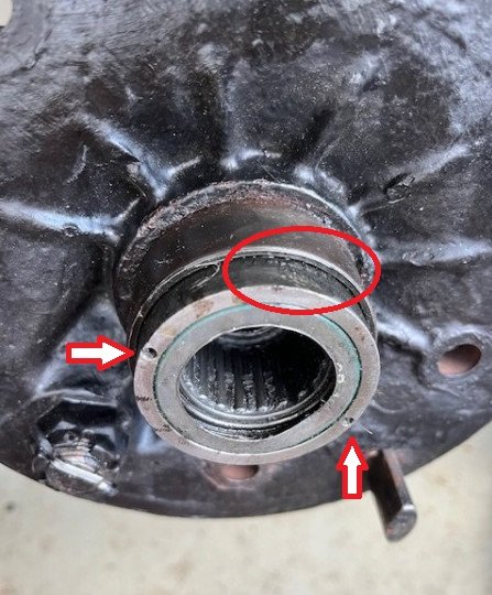

I am in the process of restoring my Ruckstell rear end. I had to replace many parts including the axle shafts. Now I tried to install the left (the Ruckstell) axle housing to the axle shaft. This did not work as the diameter of the modern axle bearing in the axle housing is smaller than the diameter of the axle shaft. When I tried to do that, I destroyed the inner seal and two of the three inner sleeves came out. One was stuck on the axle shaft but we could remove it with a hammer. Now I wish to remove this modern rear bearing but I do not know how. I wish to use the original Hyatt bearings.
I asked a question on a facebook side and got important information. Maybe the axle housing was machined to fit the modern bearing. If so, I could not use Hyatt bearings and I have to use the existing modern bearings (of which one is partly destroyed).
Before I try to remove the modern bearings it need to know, if the axle housing is machined. I could not measure this exactly as long as the bearings are in the housing.
Therefore I like to know, which kind of bearing I have and with this information somebody could tell me if machining is necessary to install that kind of bearing.
Therefore I need to identify the kind of my modern rear axle bearing.

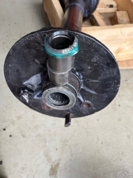

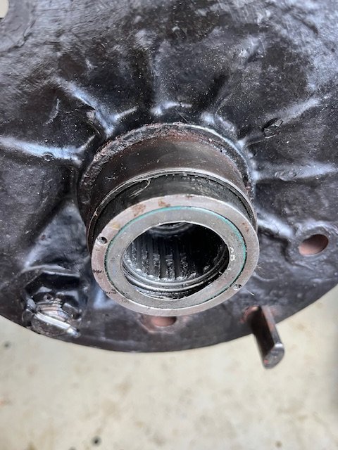

That doesn't appear to be a Hyatt bearing but a caged needle bearing. I have not seen a replacement bearing set like it before.
It appears the bearing unit presses into a stock or lightly modified housing. I see in the last 2 pictures that the unit is partly out. Keep pulling.
Is there an anchor screw in place of the original grease cup location?
You can measure the OD of the section sticking out to determine if the housing was modified & not reversible.
The OD is hopefully axle dia.(1.062") + hyatt rollers (2x.500") + 2x sleeve thickness + a few thousands for clearance.
Good luck.

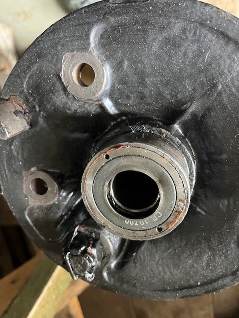

I search for information about modern outer rear axle bearings for a Model T. Pictures of what Synder's, Lang's & Model T ranch all look different and not like your either. I was wondering if the holes on the outer edge are threaded. If they are then they would allow a method for extraction.
Also there appears to be some lettering on the outer surface of the cylinder (re oval in picture). That might help to get an answer.

It is likely the sleeve was machined to take the smaller diameter roller bearing on the inside and the outside was machined to fit in the axle housing, which means the axle housing is likely not machined from standard. With your new axles and original hyatt bearings and sleeves, you should be free to go back to standard. Altogether, the best way to go.
The threaded holes in the sleeve are most likely there so the sleeve can be pulled.It looks to be 1/2" out already. There is no need for it to be a press fit, so it should come out relatively easily.

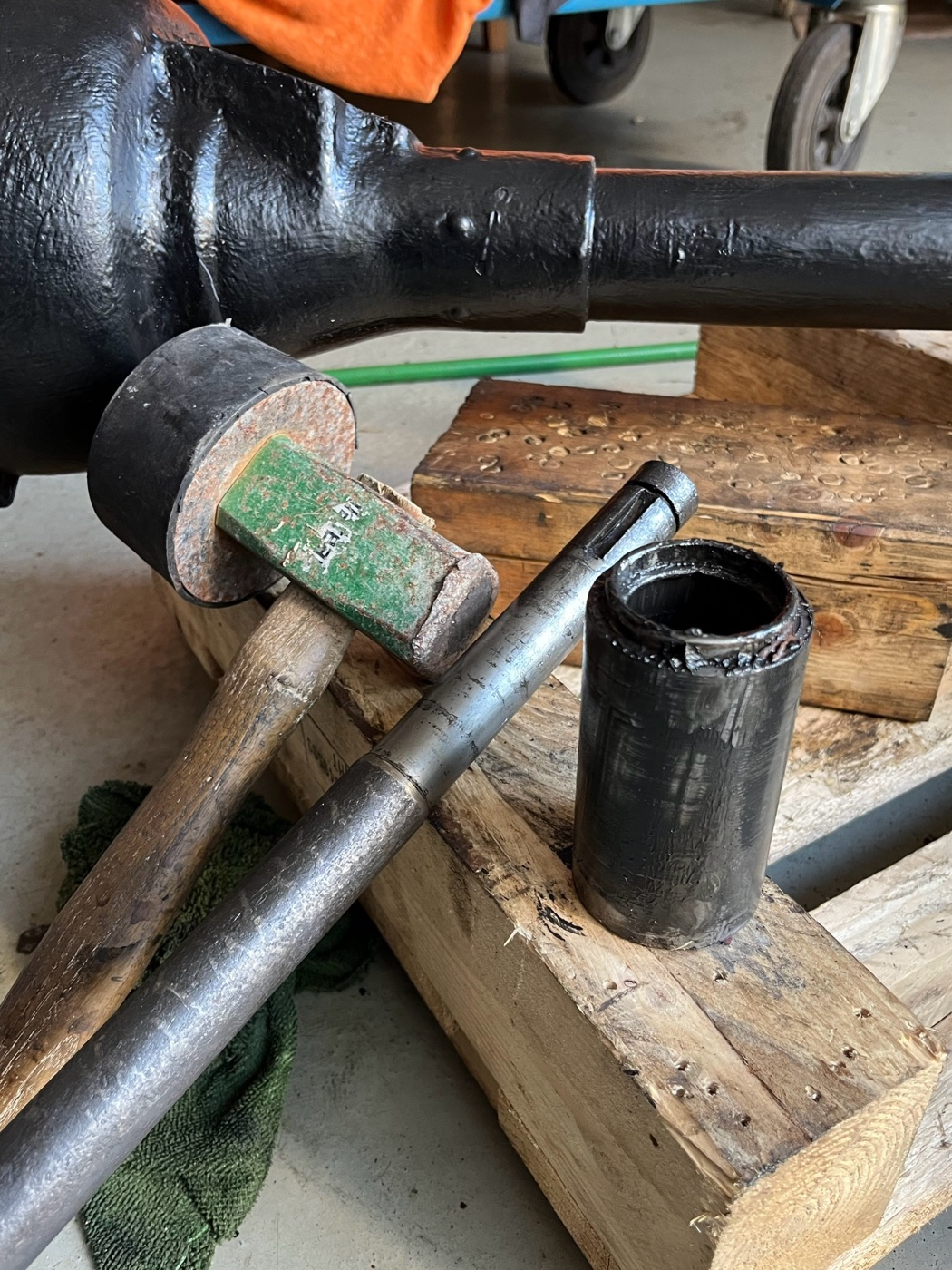

I tried to measure the inside diameter of the axle housing. It was the standard size, about 2,21 inch. I hammered the bearing out with an old axle shaft. Modern Bearing is removed and housing is ready for original sleeve and Hyatt Bearing
