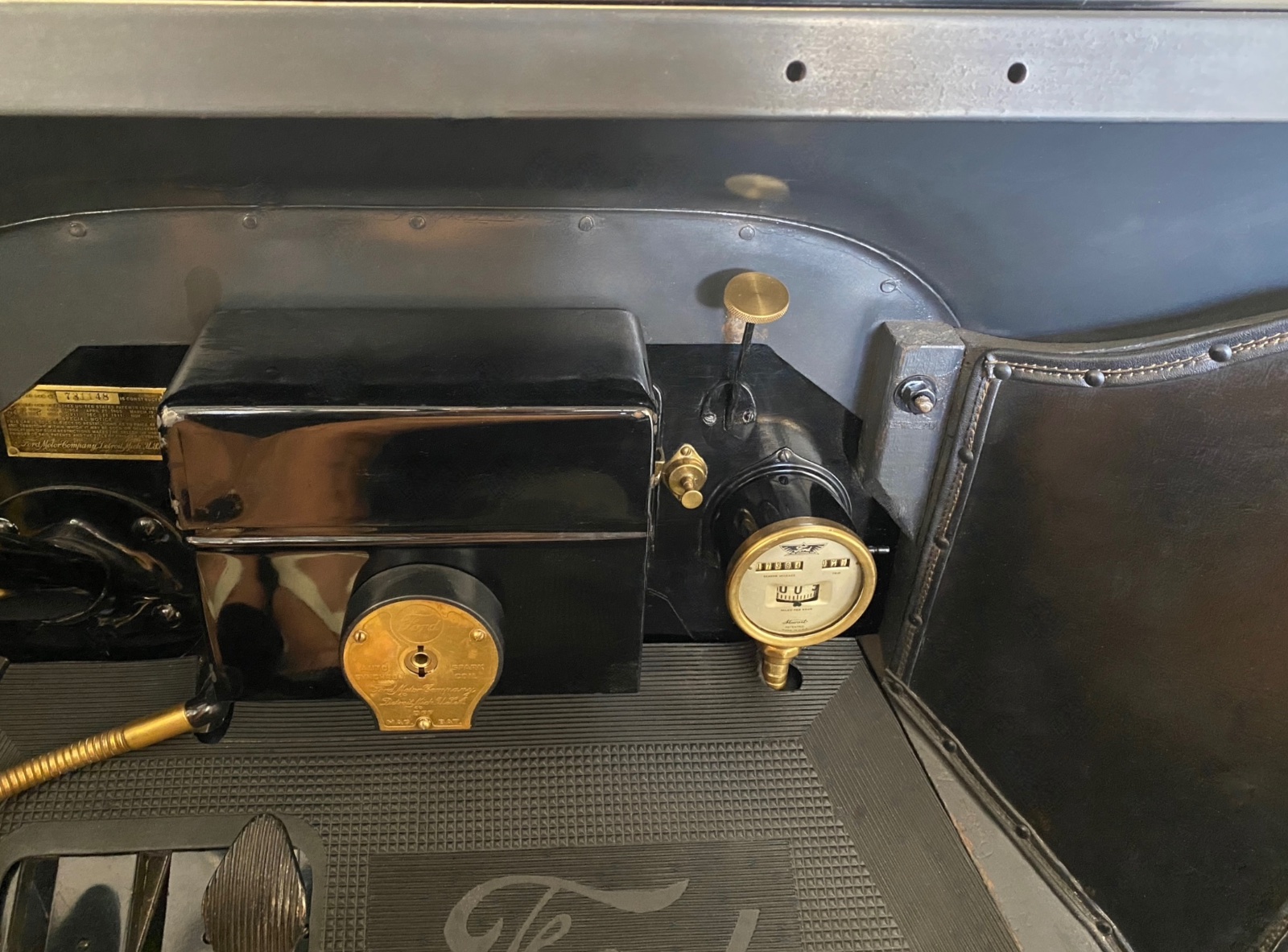

The Ghost has a pair of holes drilled into the metal trim piece just below the windshield, 3 3/4" apart and approximately 5/16 in diameter on the right hand side of the car.
The only thing I could find in the 1915 Apco catalogue was a dash light, but I don't know if it would fit. Any ideas or things that would match those dimensions?

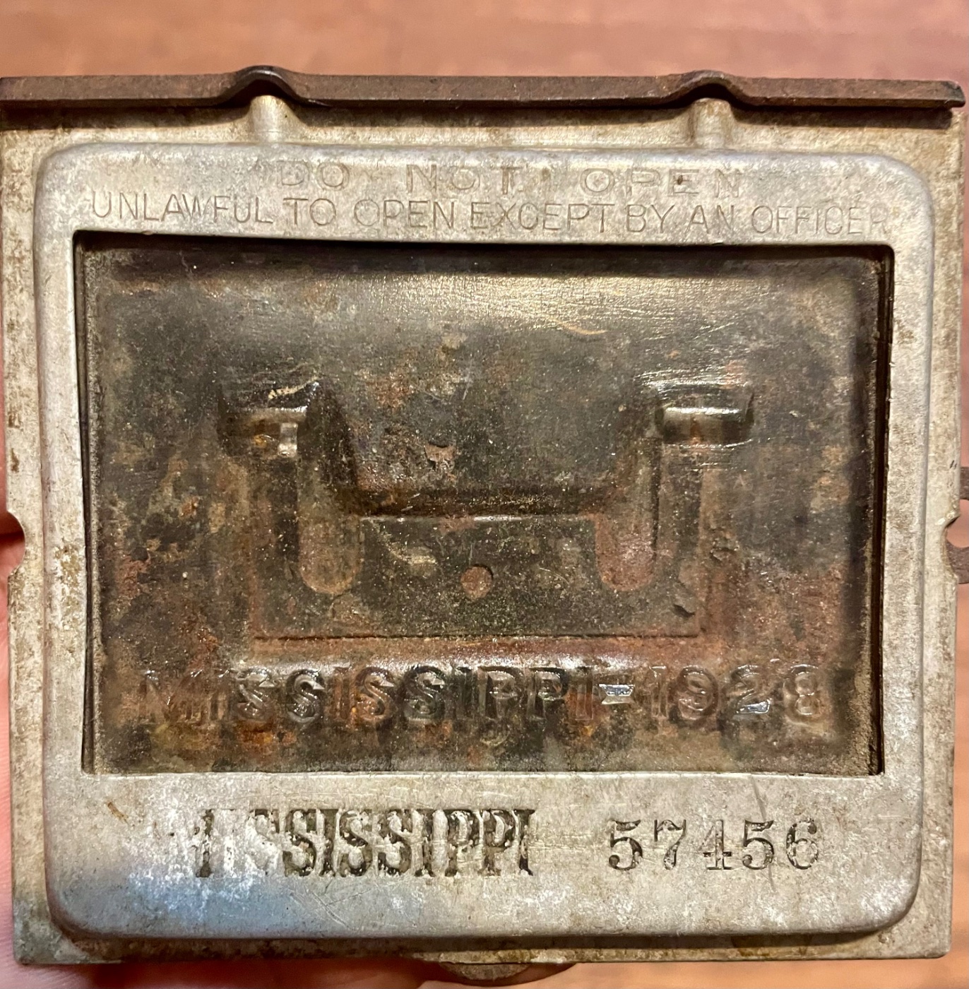

In Mississippi we had a metal registration holder that was supposed to be displayed inside the car. I can’t find the 1916 holder but I did find the 1928 holder. It has 2 tabs in the middle of each side for mounting. The neat thing is the ominous warning stamped on the top edge. Tab holes are 4 3/4” center to center. Best John

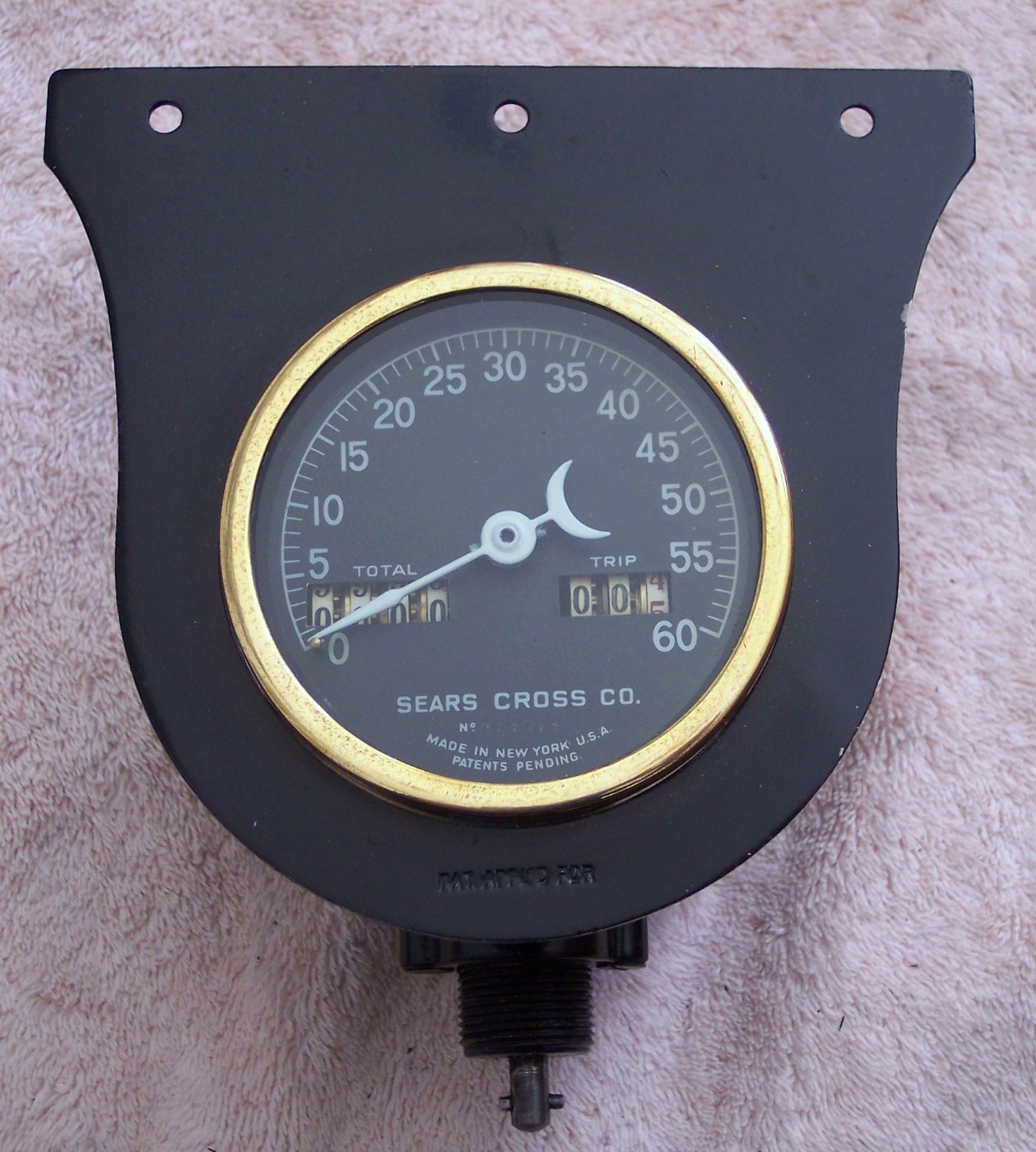

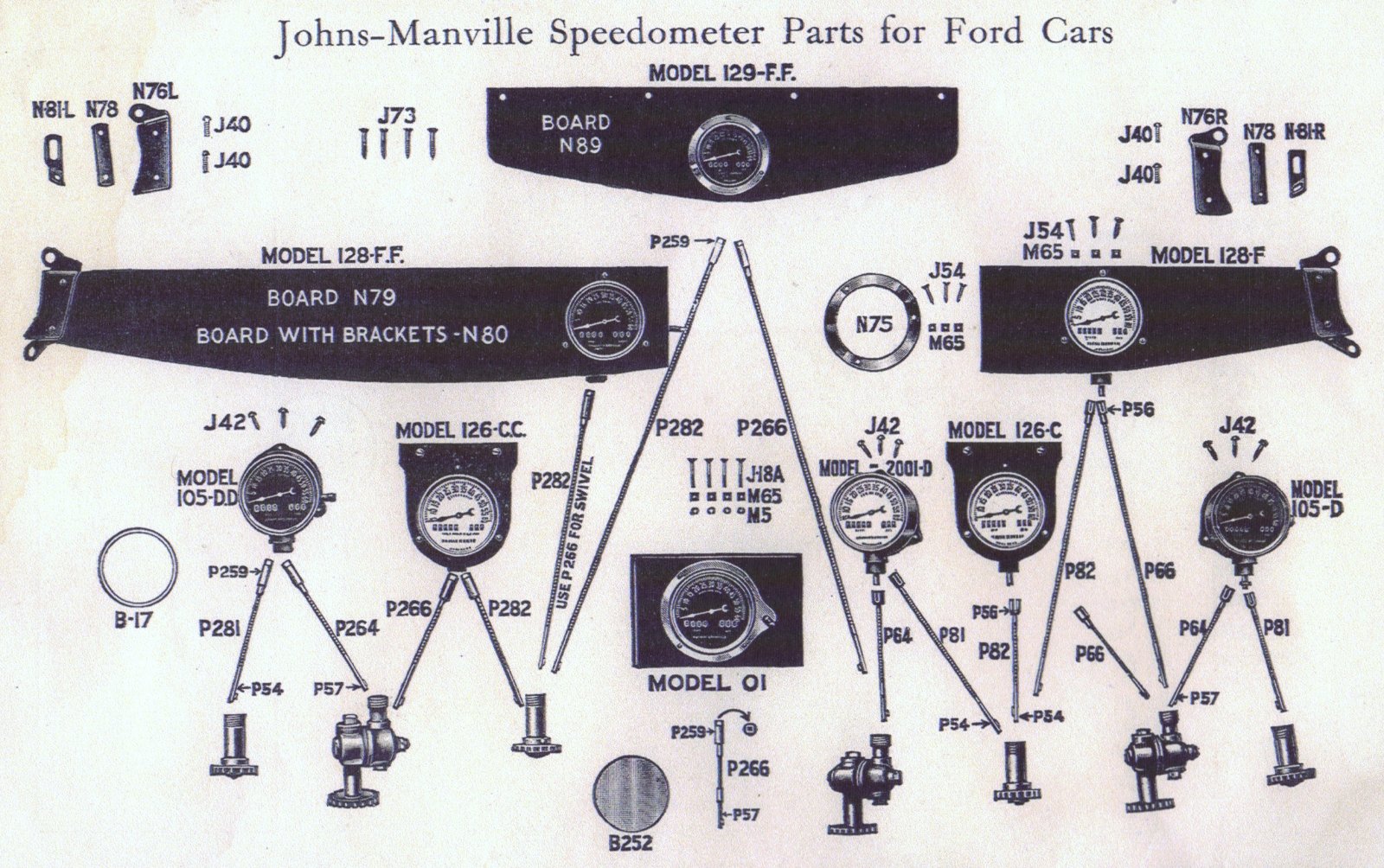

Here is just one example of a speedometer that was mounted to the cowl.. This one is a Sears-Cross. Following July 1915, Ford did not install speedometers in thier cars. Consequently, the same manufacturers that provided the "Ford Special" speedometer continued to sell speedometers to the Ford owner. Attaching the speedometer to the cowl is just one option available to the Ford owner. I have seen examples from Stewart (Model 150-D), Sears-Cross, Johns-Manville (Model 126 as seen in the parts photo) and Standard Thermometer. I hope this helps. Russ Furstnow

Russ, thanks, it helps a lot. Something like the Model 126 would fit very neatly.
