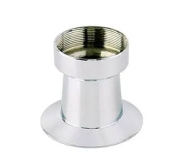

I bought a neck with a flange from Speedway - problem is, it has a large groove in the flange around the tank opening so there isn't as much surface to solder to. You'd also have to cut off part of the flange because the neck is so close to the front of the tank. I also have the ability to install aviation-quality pop rivets into the flange that would help.

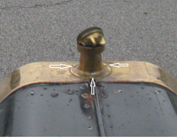

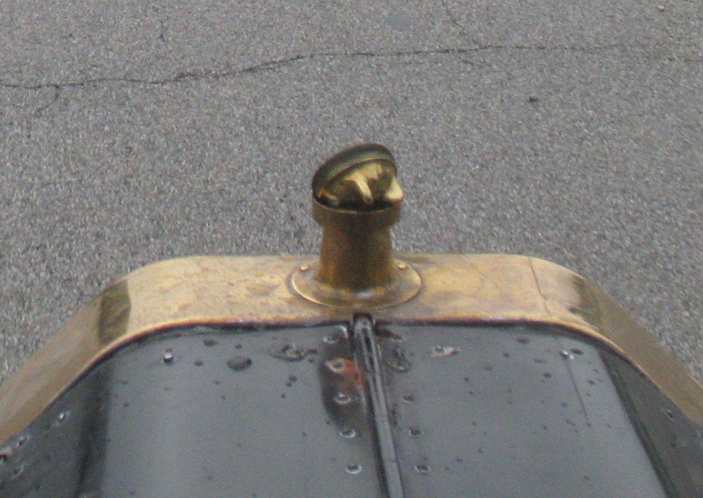

Did you notice the rivets on the base of the water neck. That should keep a soldered one from working loose

Tim you have a black T correct? This would mean you have a shroud covering your radiator so the combination of silver solder & rivets most likely will not be seen because of the shroud.

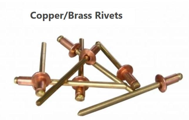

Sounds like that would be the solution if the radiator neck that is pictured is the style you have. Use a quality flux on a clean surface, rivet in place and solder, the flux will pull the silver solder in. You’ll only be heating the flange so wrapping the a wet cloth around the neck will help as a heat sink & prevent you changing the polished finish.
- Posts: 7264
Re: Brassworks "Low" radiator
Flux will help get the solder between the tank top and neck but better still is to tin both components prior to fitting. This will ensure that there are no spots where the solder will not take. Rivet the neck on and then sweat the two together, and add solder as required.
The rivets will add a mechanical attachment to the solder joint. Your flanged neck will add greater take area for the solder.
