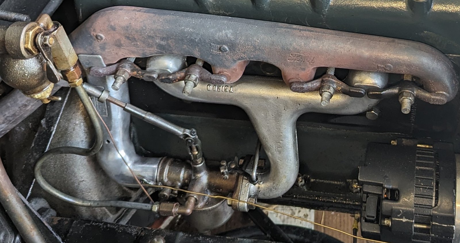

I have one of these on the '23. It was on the car when I bought it along with a Z head. The motor ended up with a new block, new crank, some rods and an E-Timer. While it was apart I found out that it had an older Chaffin "driver" cam and I had 351 Cleveland valves installed by the fellow who set up the lower end. This is a peppy T and was never last on club tours.
Now I'm working on a '19 engine in a '14 Touring. That motor seems a bit weak to me and I'm not sure if it is tired or if it is just a stock motor pulling a heavier car along. I see no smoke out of the exhaust nor excess fumes coming out of the throttle rod passage between the cylinders. I have not run a compression check yet.
I'm not interested in speed and have been told the '23 cruises at between 35 & 40 mph by people who were following me. I would like a little extra poop on the hills. The '14 seems to slow right down when climbing.
I have both a Pruss head & a 280 Prus cam for eventual installation in this motor.
I went ahead and ordered one of the high flow manifolds as these are supposed to be on this year car even if it doesn't match the motor year. I have heard this manifold may need some grinding to fit, we shall see.
It has been said that not all "speed" equipment is suitable for all applications. That makes sense. The hi flow may work great at WOT but not so well at partial throttle. Sometimes the rough surfaces may actually help with atomization of the fuel mixture. Not knowing the details I'm wondering if the high flow manifold is a boon to a stock motor? It certainly doesn't seem to hinder the '23 but that is no longer a completely stock motor.
Has anyone had real experience with the high flow manifold on a stock motor?

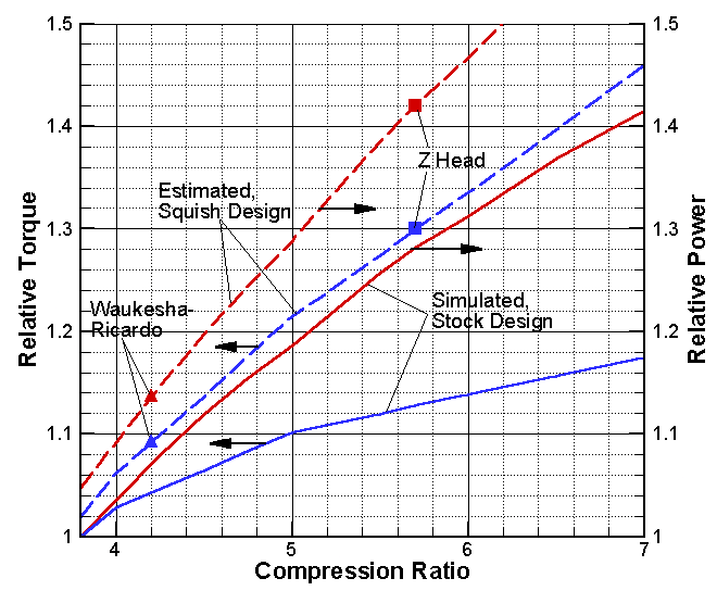

One thing about the earlier Fords was the "Low Head". It had higher compression than the later heads. From what I read in the books about the T is that during WW1 the octane of the fuel dropped and the higher compression would cause a knock, so the high head was installed and remained until the last Model T's.
- Posts: 6531
Re: High Flow Intake Manifold?
Head Compression how high is "High Compression" vs "Low Compressions"
Torque measures the turning force produced by a vehicle's engine and the engine's ability to perform work, horsepower measures how fast the engine can perform the work. Therefore, high torque makes an engine accelerate faster from a stop, and high horsepower makes for higher top speed.

As I had begun to suspect, this is not a simple matter of "bolting on horsepower." There are many other considerations which include the condition of the motor and the other equipment added. I am currently running an NH on both cars. The real problem is comparing results. I have rarely ever driven a T other than my own. The Museum T I drive is only in parades and it is in such poor shape that at anything much over parade speeds the front end shimmies. No valid info to be had there.
I value sweet running & tractability over power but would still like some help on the hills and we have plenty of those here in this mountainous area. My home is up at 4200' which saps power even more when those hills are encountered.
I have been working on this car off and on all summer and now its fall with winter right around the corner. I had jumped to buy this high flow manifold to install while the manifolds were off the motor hoping to do this job just once but had second thoughts once a pal from the Orange County club expressed his reservations. I have it now but may just set it on the shelf and decide later about using it.

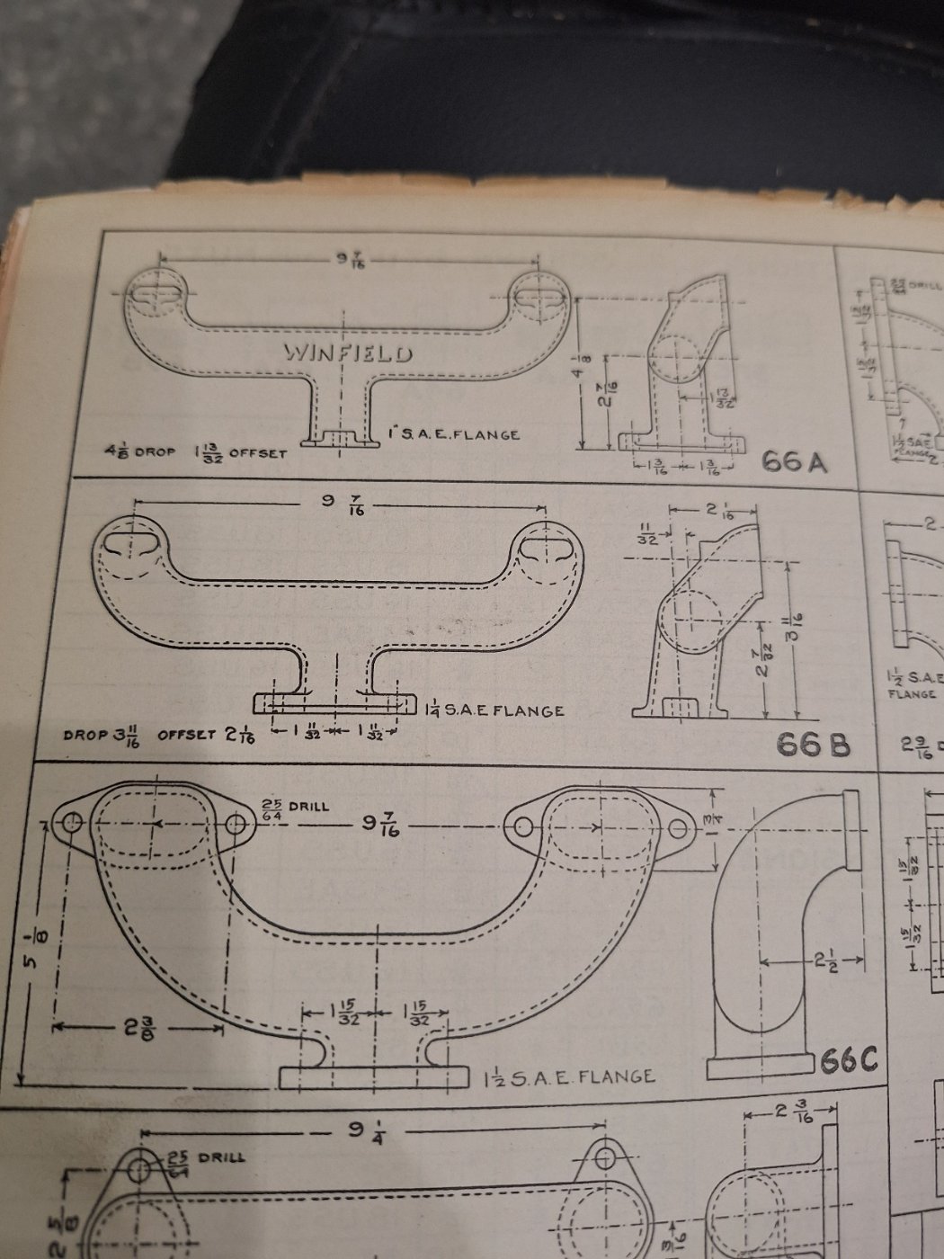

big2bird
- Posts: 718
- First Name: Jeffrey
- Last Name: Hausey
- Location: Anaheim, Ca.
Try a Winfield MA on a Winfield manifold.
I have an MB, but that matching manifold is unobtainium.
Been looking for 50 years.

Sadly, the choice of metal made them very suseptible to damage. They are fragile. I wish Kevin would make a batch.ModelTWoods wrote: ↑Fri Sep 27, 2024 9:00 pmIn my neck of the woods, Winfield carburetores in working condition are make of Gold and Unobtainium.
big2bird
- Posts: 718
- Last Name: Hausey
Still searching for 66B.

I do not know which bolt on device adds which % boost in both low end and high end performance but my heaviest Model T (centerdoor) runs like a scalded ape! With a standard cam, I wouldn’t trade my Waukesha Ricardo, Simmonds carb and original aluminum hi vol intake.
big2bird
- Posts: 718
- Last Name: Hausey
The Ricardo. Higher compression adds more "thump."George House wrote: ↑Sat Sep 28, 2024 9:57 amI do not know which bolt on device adds which % boost in both low end and high end performance but my heaviest Model T (centerdoor) runs like a scalded ape! With a standard cam, I wouldn’t trade my Waukesha Ricardo, Simmonds carb and original aluminum hi vol intake.
