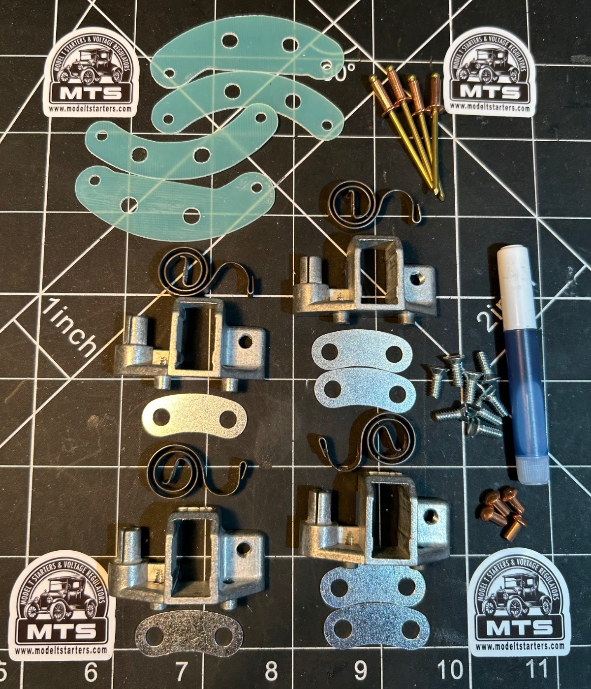

Most folks look at Langs, Snyders, and other vendors websites and peruse the products they offer without much thought of what went into creating all those specialized products for vehicles that are 100+ years old. Passion, time, perseverance and dedication to our hobby invariably went into most everything listed in those catalogs. Created by dozens if not hundreds of people who are dedicated to keeping these amazing cars on the road. Nobody's getting rich off of selling parts to T owners, the cheapest SOB''s on the planet. I should know, I'm one of them!

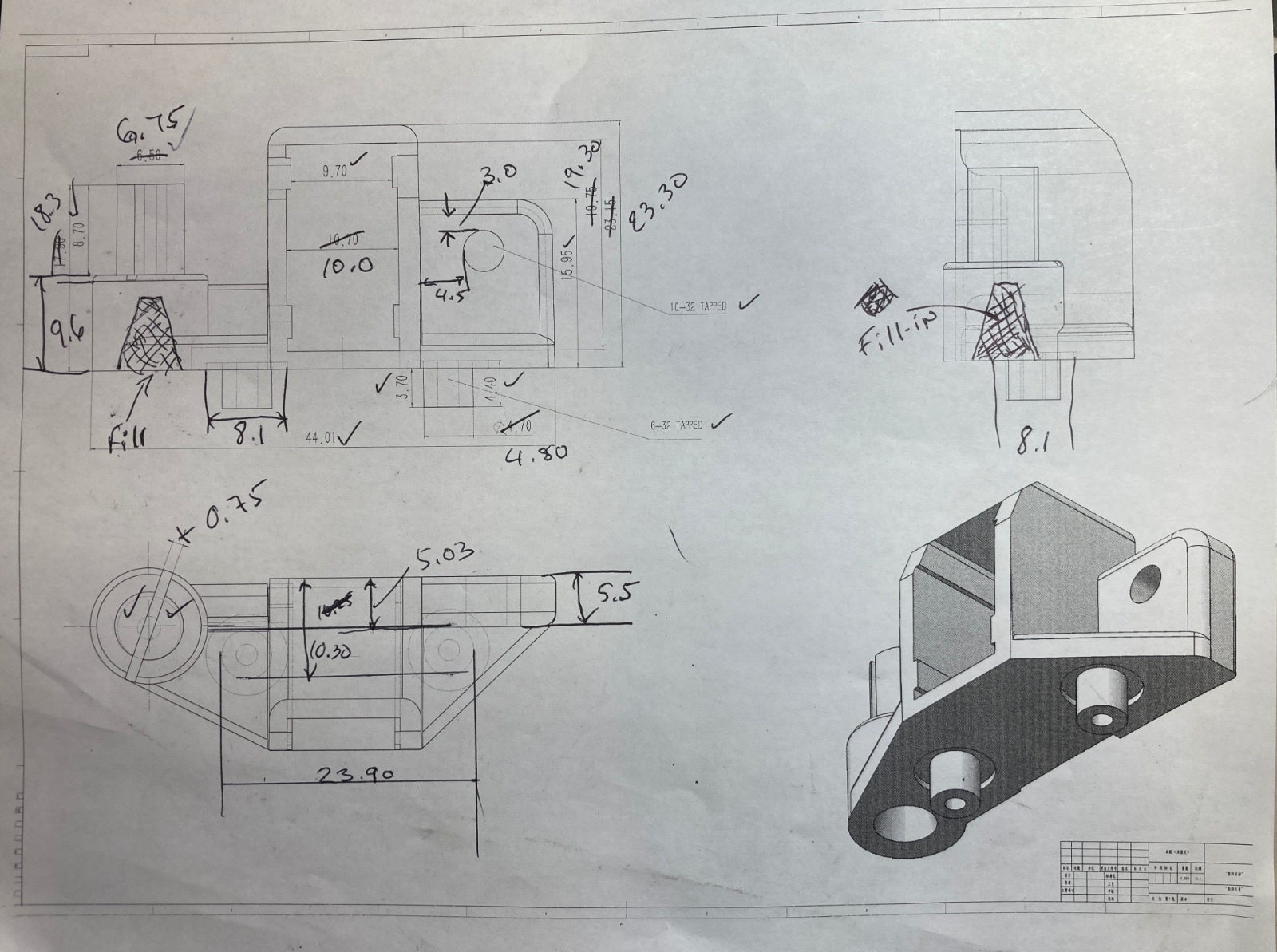

I started this journey in January of this year to create what does not exist. As you all probably know by now, I'm an expert at rebuilding starters and generators having done literally 100's of them at this point.. I often found myself cursing the quality or unavailability of certain rebuild parts for these units.
My first goal is to reproduce all parts necessary to rebuild starter & generator brush holders with ALL NEW components at the highest quality possible. 10 months later and I'm almost done with this first phase. I had no idea at the time just how much work it would take to accomplish this goal. But I persevered and overcame all the obstacles, and there were many. I'm an accomplished engineer and am no stranger to creating engineering drawings and product specifications.
Those are one thing. Getting specialized vendors to produce high-quality, usable parts from them is another thing entirely, sometimes having to start from scratch with a new fabricator. It's not sexy stuff. In fact you can't even see the parts I'm producing for your car. But all cars produced from 1919 to 1927 (and many others) need these parts to keep running, both now and in the future. Somebody had to do it. I'm doing it....

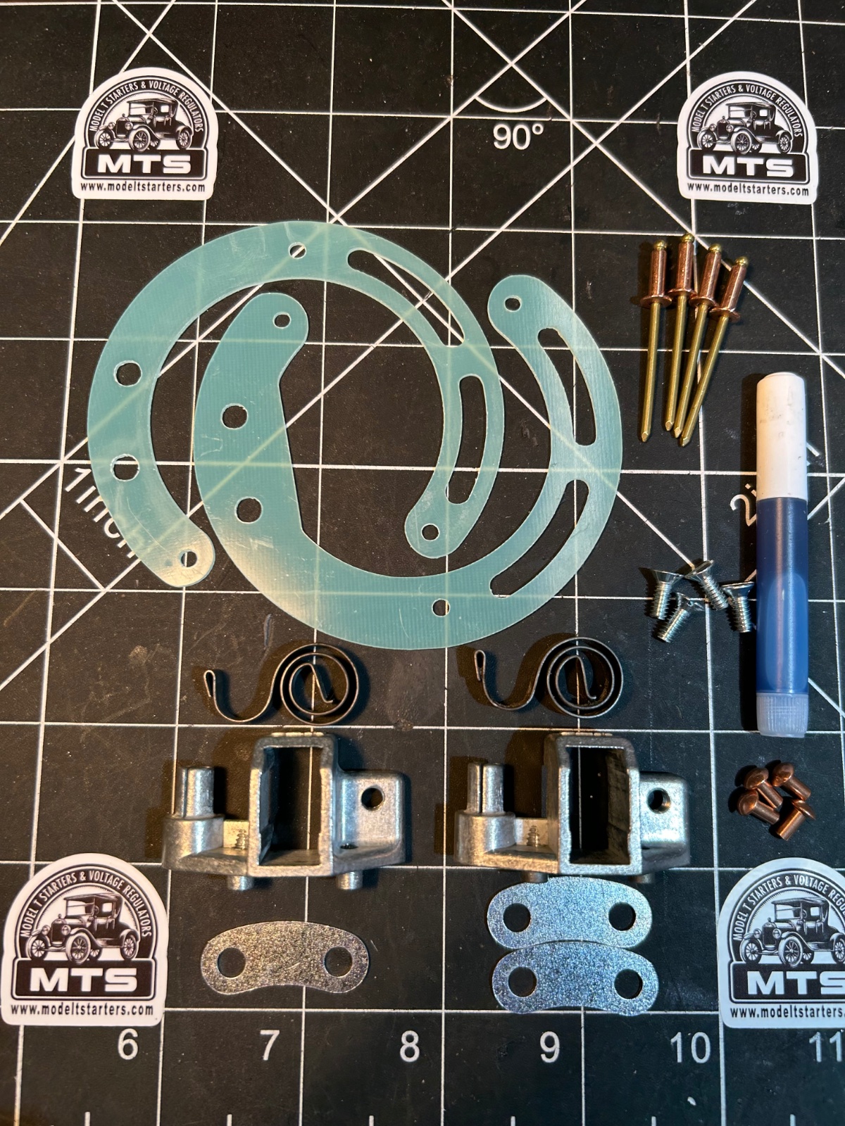

Im creating rebuild kits to refurbish starters and generators with all new parts. Everything needed to rebuild these units. I even sourced 2ml vials of Loctite (have you looked at your dried up Loctite bottle lately?)
  • Brush holders molded and die cast from Zinc (not pot metal as was done in the originals)
  • Brush plate insulators laser cut from FRP that fit perfectly and are 1/32" thick
  • Brush holder backing plates laser cut 1/32" thick
  • Brush holder springs of the correct tension perfectly molded & shaped for both starters & generators
  • All the correct hardware necessary for the rebuild - rivets, screws, Loctite etc

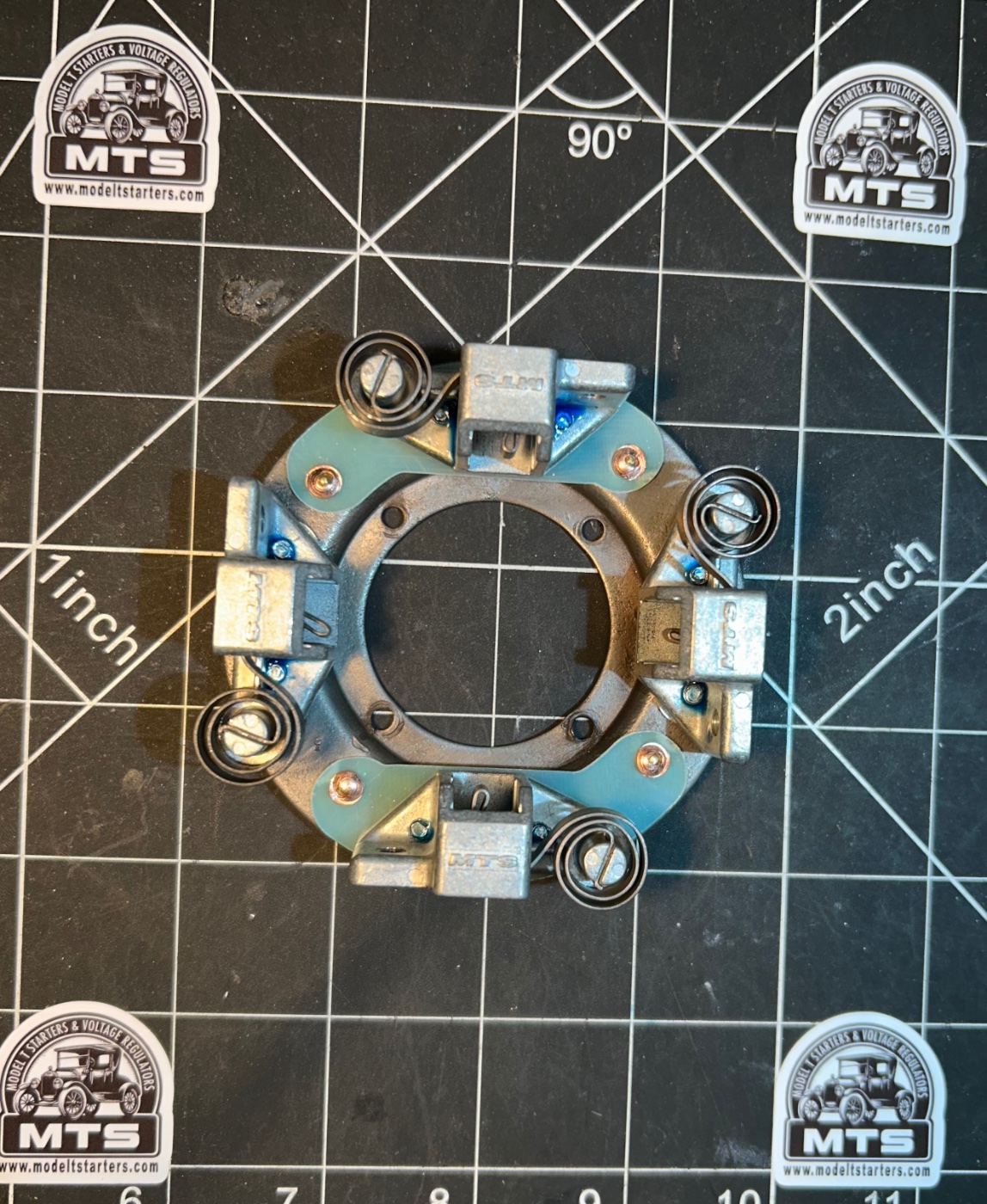

Once implemented, these components produce these completed brush holders - again with ALL brand new parts:
Using the parts I fabricated and starting with a blank starter brush plate it took me all of 10 minutes to fully assemble what you see in the picture above. Anyone whose done this before knows it normally takes a few hours of work to clean & massage all the used parts into a useable rebuild.
All of this work will be coming soon in kit form to a vendor near you.

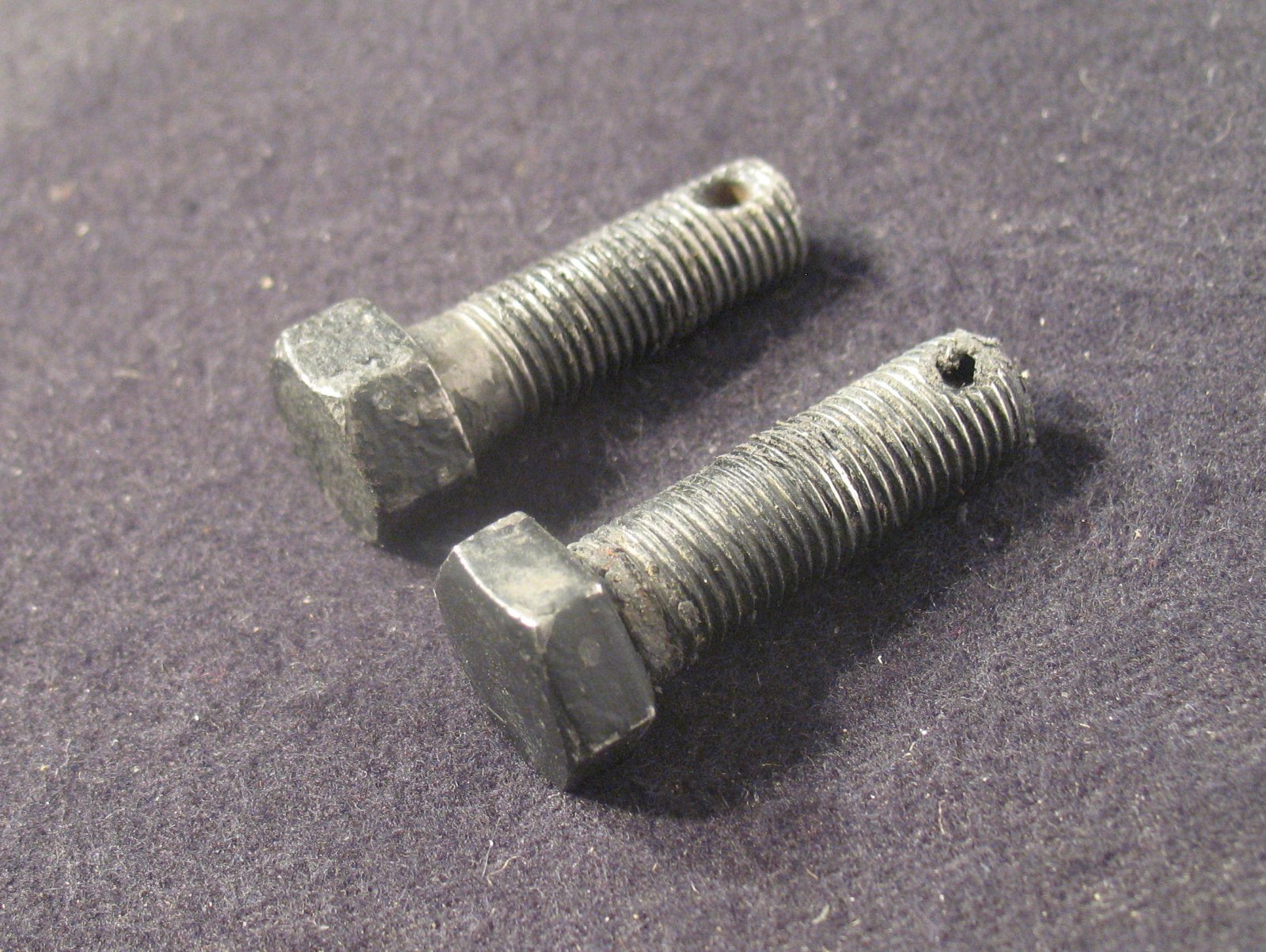

Post by Steve Jelf » Thu Oct 03, 2024 11:06 am
Nuts & bolts. You can buy the modern ones at a hardware store, grind off the markings, drill cotter pin holes, and get something similar that show judges won't notice. But compare an original bolt used by Ford and an adapted modern substitute. The difference is obvious. As far as I know, there is nobody reproducing the originals. Most of us don't even recognize the difference, but once you do it's hard to miss.

No offense Steve..... but I personally have zero interest in reproduction bolts and some judge's esoteric opinions on said topic, but I do care about being able to reliably start your car and actually drive it without breaking down too often! These cars were meant to be driven.
Assistant WebSite Admin

As to Steve's comment about bolts - If my goal was a 100 point Pebble Beach car I would agree with him. That is not my goal, and as long as the bolt head is square where it is supposed to be square, and no Philips screws, close enough.

I think Steve should have a look at the bolts Lang's is selling. I've been buying up originals for years, and was even able to build a car from scratch using all the correct nuts and bolts. It's always been important to me to do this.

I don’t think Steve was saying that making exact reproductions of nuts, bolt and other fasteners is a have to do for a Model T. Steve is right to give advice about how to fabricate modern bolts that closely look like the originals. I’ve done that as well as others to complete a car. Exact duplicate fasteners aren’t necessary for a good running car like a generator and starter is. For me an original generator and starter is more important than a fastner but that’s just me.
I did buy a box full of nuts and bolts though from a guy who had dismantled T engines over time that’s helped me in my own engine rebuilds.
