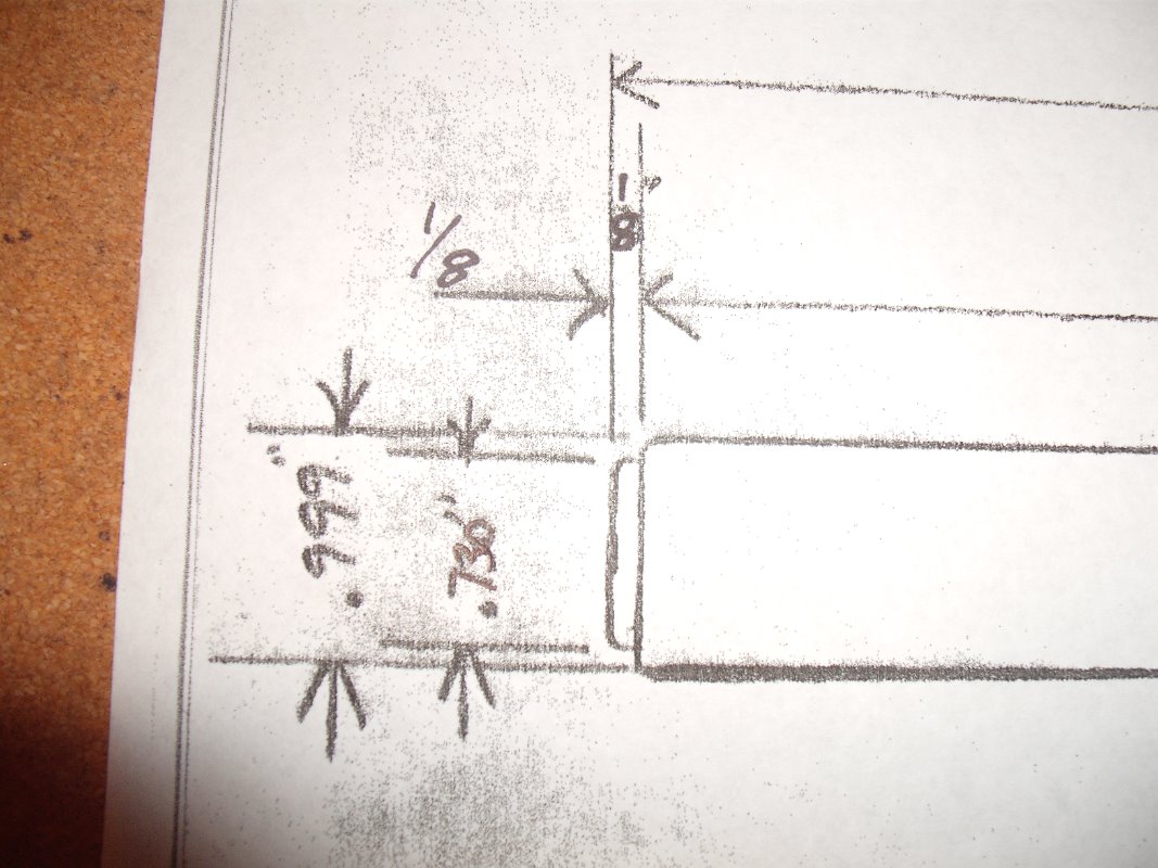

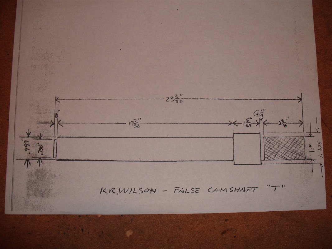

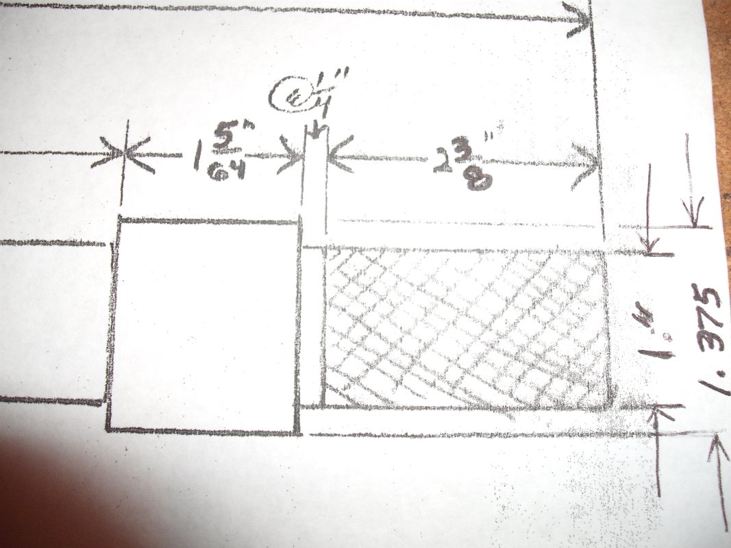

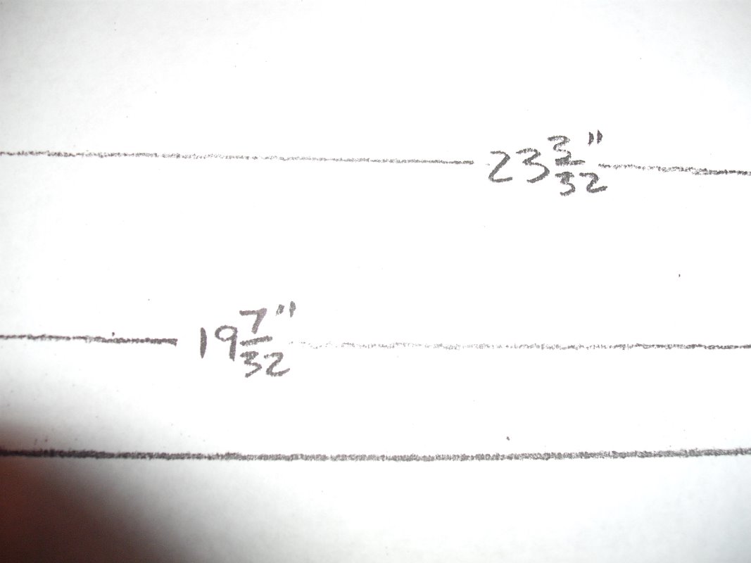

Brent, I found my "somewhere" pretty quick
My scanner is not working so I just took come pics of the diagram. If you can not read all the measurements or need more info, let me know .. These measurements are of a KR Wilson false cam to use with a KR Wilson boring frame. ... other boring frames may use something different

Re: Measurements for a False Cam
Brent, yes they are a simple lathe turned item. The only two critical measurements are the .999 shaft diameter, and the 1.375 diameter of the collar. The .999 is the size of the hole in the rear of the block for the camshaft brass bushing, and the 1.375 is the size of the hole in the block for the front camshaft bearing shell. Those measurements allow for a snug "sliding" fit in the holes. The KR Wilson boring frame is designed with "fingers/tabs" to slide against the .999 measurement and then bolt down to the block pan gasket surface.
