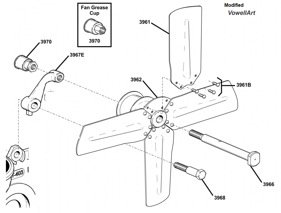

Here is an exploded view..

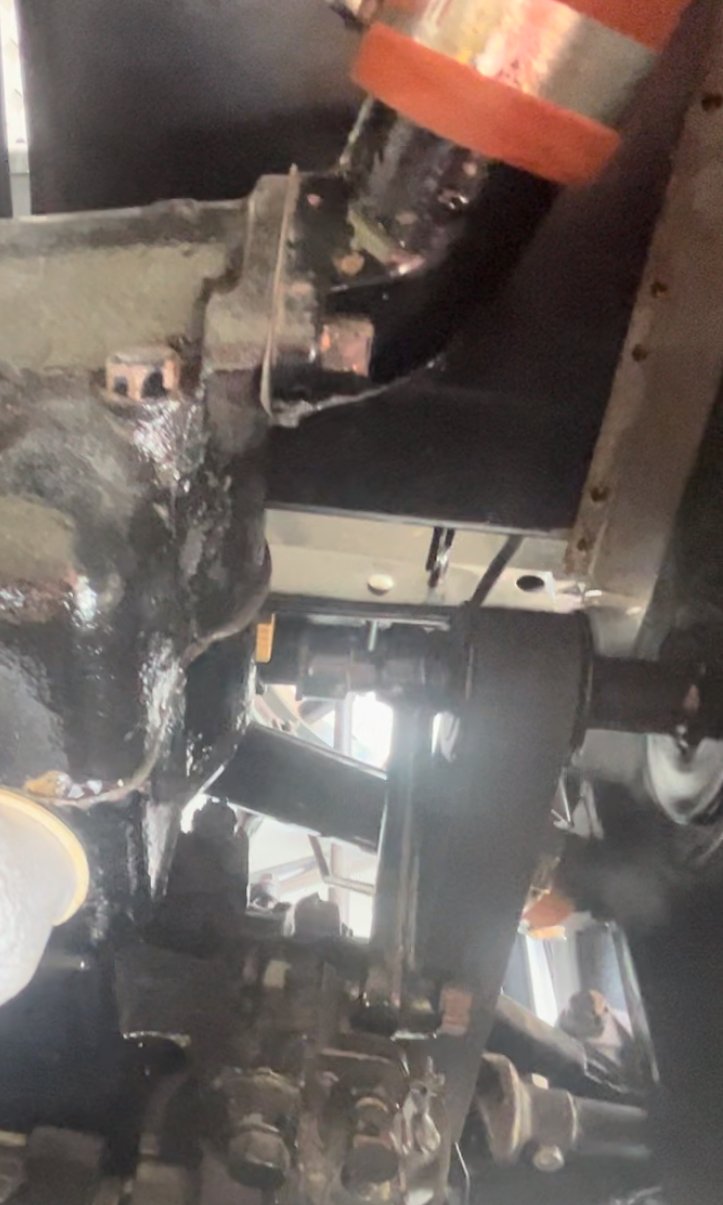

Here is a photo. its a 19 so it has a grease cup not a locking nut,I did fill the inside with grease before assembling it so it could be the grease cup not tight enough,
you can see the rivited fan as well as grease cup

Post by speedytinc » Tue Oct 08, 2024 12:46 pm
You got it figured out now.

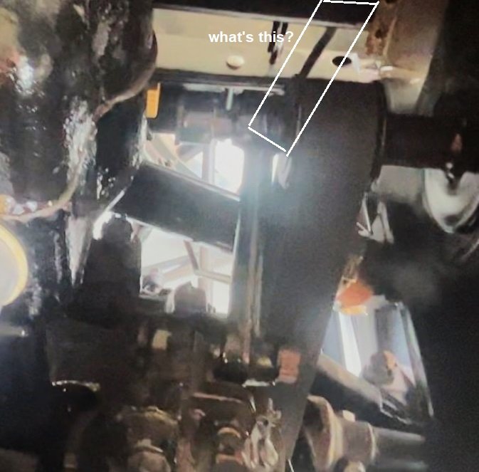

Post by TRDxB2 » Tue Oct 08, 2024 1:19 pm
It looks like you have a mix of parts. The fan assembly T-3962 and a FAN SHAFT Part # T-3966 with a fan shaft 3967B.
So the question is is the fan shaft threading into the fan support arm your using ?

Post by Jonathan.2909 » Tue Oct 08, 2024 1:47 pm
The boxed in black thing that you questioned is a headlight wire, I am bad at managing the wires
