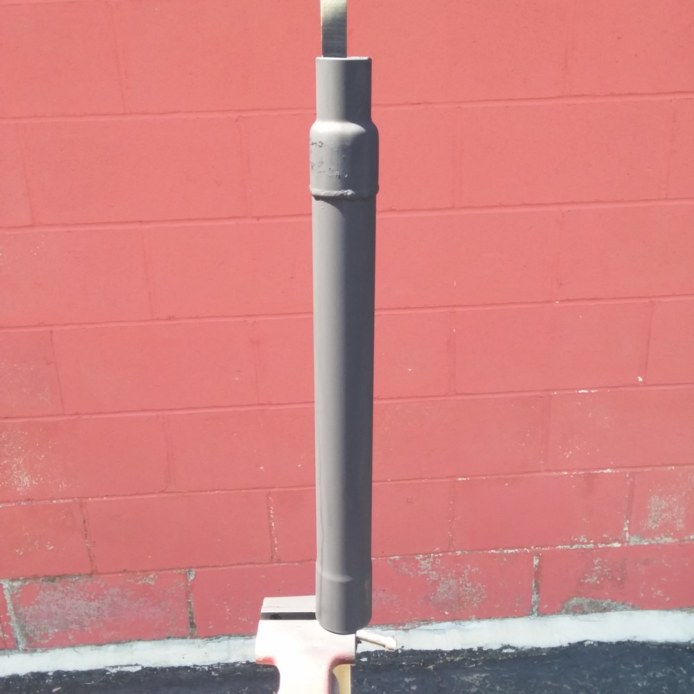

Professor Fate's secret recipe for a straight thru shotgun muffler....
From the stock t exhaust pipe, one inch and a half to two inch flare, welded to eighteen
inches of two inch pipe, with another inch and a half to two inch flare turned around with the small
side inserted and welded to the exit end of the two inch pipe. These three parts
are on the shelf at your local auto parts store. I paid $25 or so for these parts.
I found that this assembly lacked the backpressure needed to climb hills as good as a regular
muffler car. I solved the issue by stacking 3/4 in nuts on a long thin bolt at the exit. Thru
experimenting I found the right amount of exit restriction. Car is loud, and scoots along,
and up hills very well.... the tractor muffler I expect will do the same if you don't want to experiment.
If you run it straight thru you will be lacking power and a ability to climb hills.
I'll dig up pic shortly.
