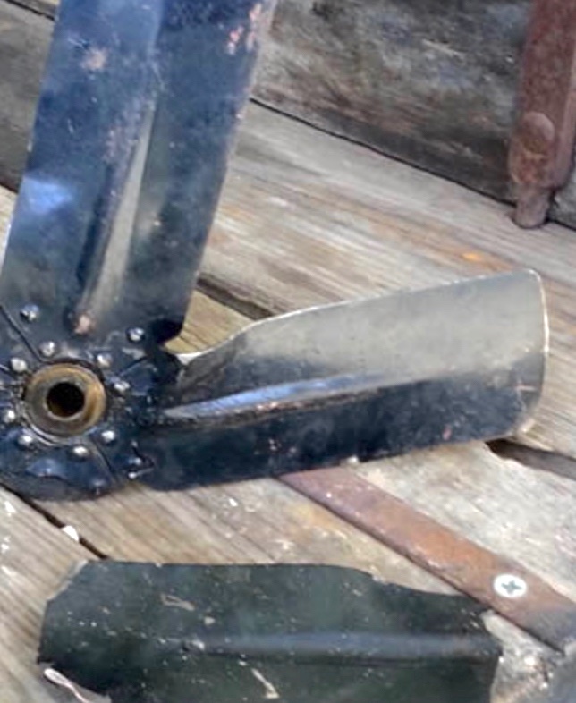

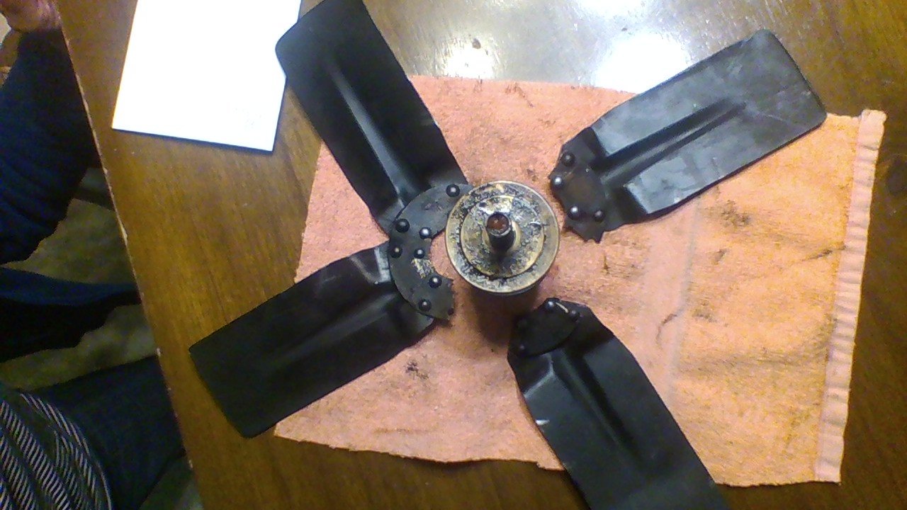

[image][/image]I am not sure how old the fan is but likely very old knowing the history of the car. The hub that the blades rivet to broke in three places. I am trying to send a picture but I am not sure how to attach it.

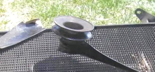

Sadly it did damage the radiator. I am just trying to learn what might have caused it so it does not happen again. Also I am not sure which year of parts to buy.

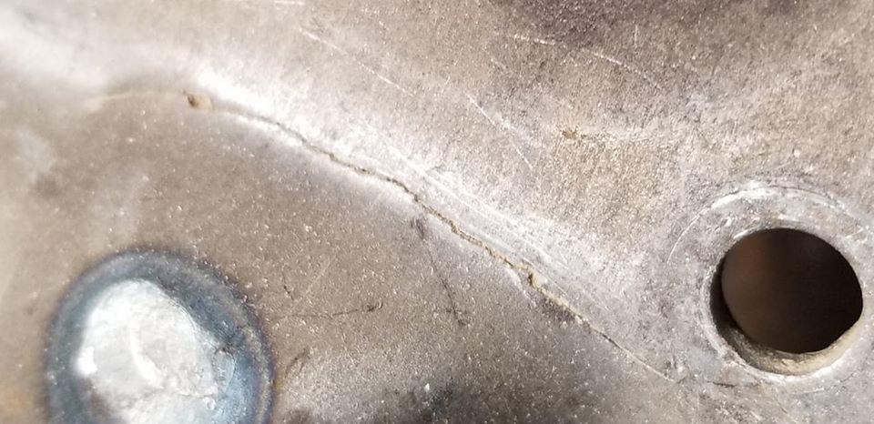

Cracks can develop around rivets, and cracks that propagate to fracture. Anytime an engine is running, a fan blade can fail. Many have done that. A new fan assembly is the best protection.

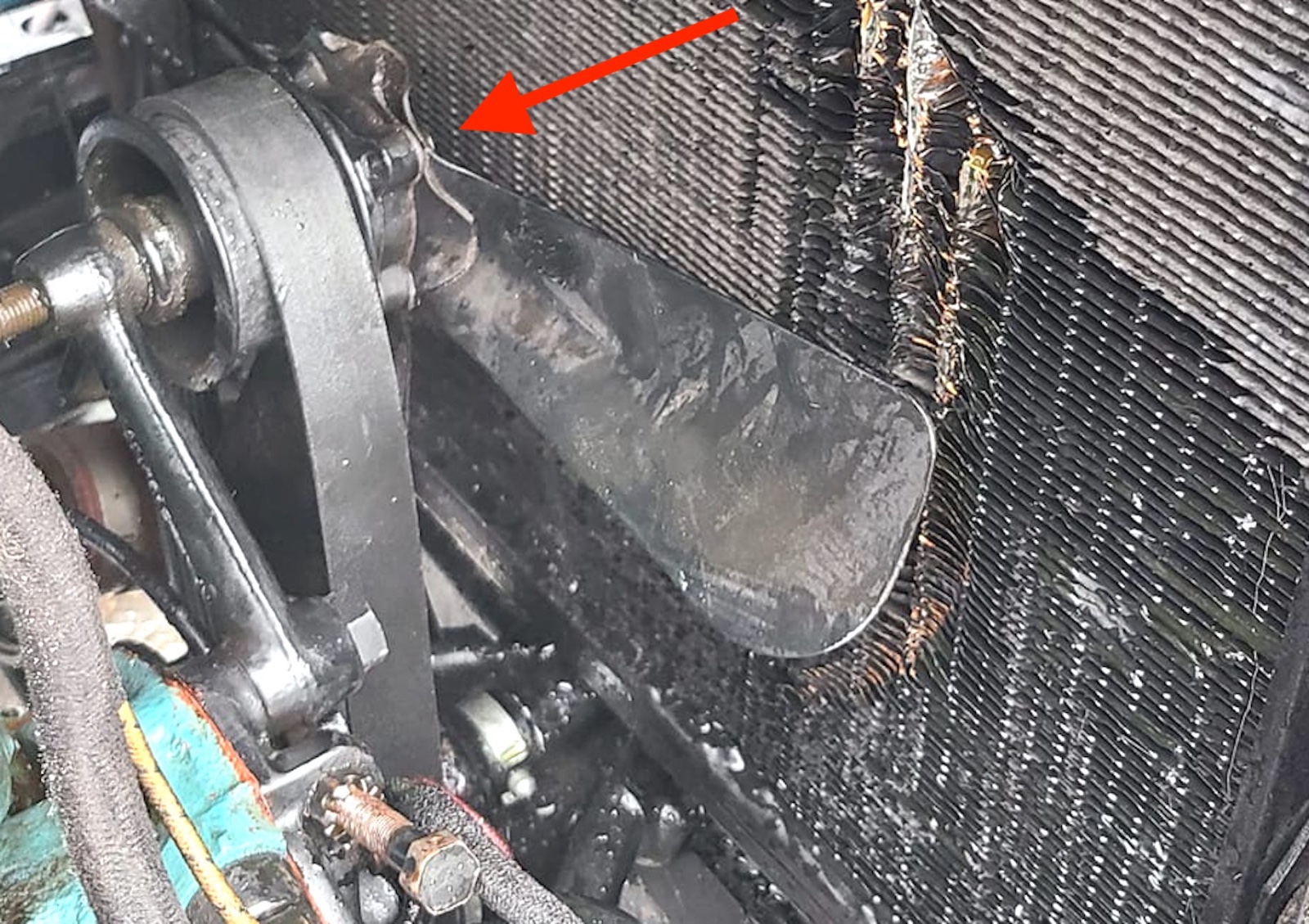

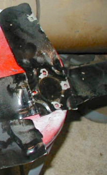

Crack near a fan bolt hole.
Other fan breaks.
Even the Model A two-blade fan can throw a blade!

The brass hub would be on a 1913 T. Later ones with riveted blades had steel hubs. These look correct, and the hubs are not likely to be so worn.

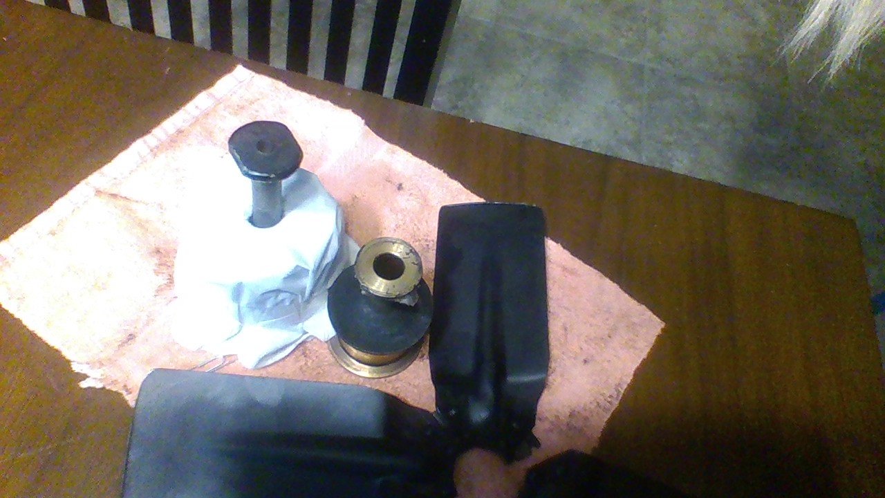

I am have trouble relating to the failed fan assembly. A side profile of the brass potion will help as well as the plate with the attacked blades. It looks like it failed at the neck where the plate has the riveted blades. But it also could have been a crack on the plat between two blades that caused all the damage when things came apart. But the material left inner rivets towards the neck doesn't match up to whats left on the pulley, why?

Does this help? picture of the hub

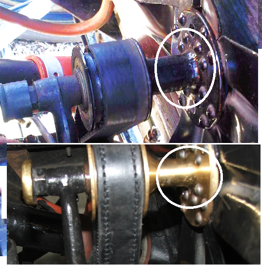

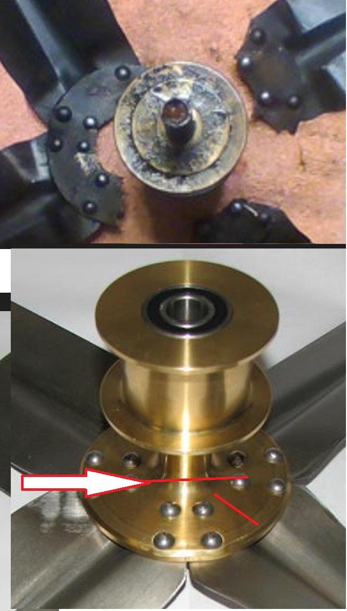

A photo like these (angle shot). The upper one appears to have had the front plate brazed to the shaft. In looking at the picture you sent looks like tha plate with the blades may have been brazed or worse JB Weld

The flange on the front of the pulley to which the blades are riveted is part of a one piece casting. Yours looks like it was fixed to the hub in some manner, and that fixing has failed.
Frank's photo sows a modern replacement, with sealed ball bearings. Rather than a casting, the brass hub is machined from one piece of brass stock so that it resembles the original ones. Its flange is somewhat more substantial than the original ones.
