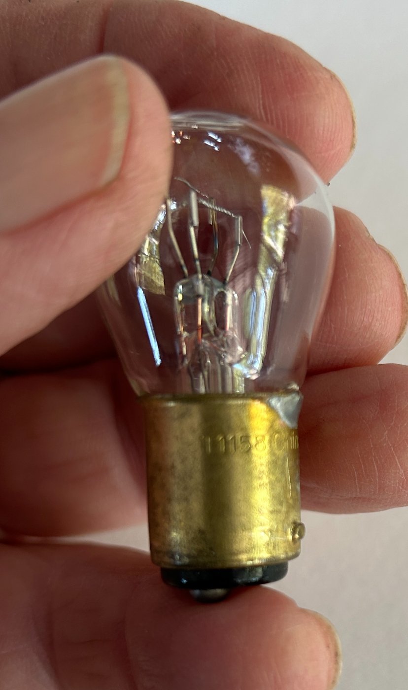

I am looking for a LED bulb that will replace the existing 1158 incandescent bulb. I have 4 Model T’s that use the same tail lights and all use the 1158 bulb. They work but I want brighter. I do not want to change to a modern fixture, I’d like to stay as original as possible. So far, I have not found a LED replacement bulb that has 2 contacts (brake & tail light), non-staggered pins on the side, and operate on 6 volts. Has anyone found such a LED bulb?[image][/image]

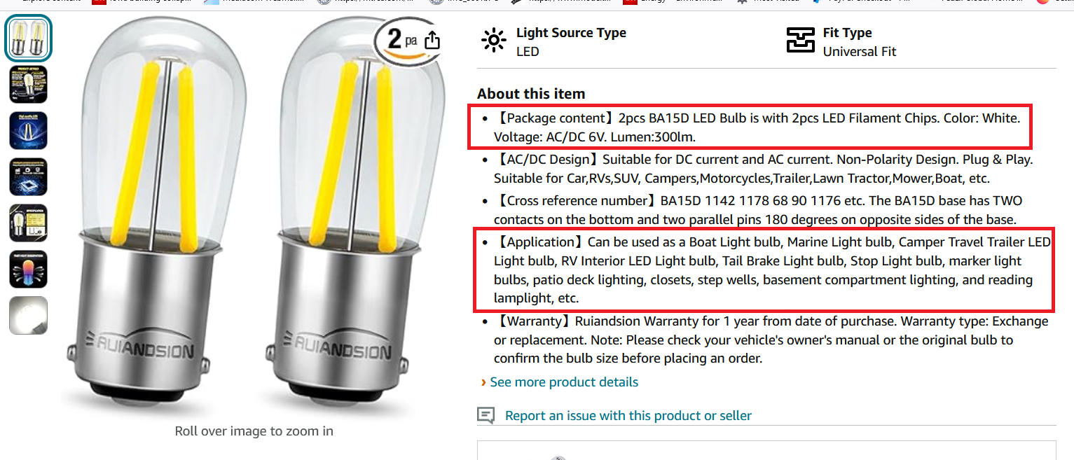

Search using BA15D LED 6v BA15D is the spec for the base with parallel pins and 2 contacts600wt wrote: ↑Sun Oct 13, 2024 12:20 pmI am looking for a LED bulb that will replace the existing 1158 incandescent bulb. I have 4 Model T’s that use the same tail lights and all use the 1158 bulb. They work but I want brighter. I do not want to change to a modern fixture, I’d like to stay as original as possible. So far, I have not found a LED replacement bulb that has 2 contacts (brake & tail light), non-staggered pins on the side, and operate on 6 volts. Has anyone found such a LED bulb?[image][/image]
Just one result https://www.amazon.com/Ruiandsion-Filam ... B0CLD21YLT
Look for lumens output

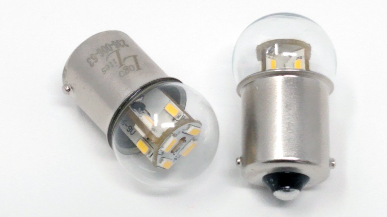

Check the top supplier of LEDs... www.logolites.com. ...... They have bright stop lights, and two types of headlights. Check out their website to match what you need.

Re: Need a replacement LED- help please
As I understand, because of the low power demand of LED's, they don't care if your system is 6 or 12 volt, positive or negative ground. I bought headlights from this company and have been very satisfied.

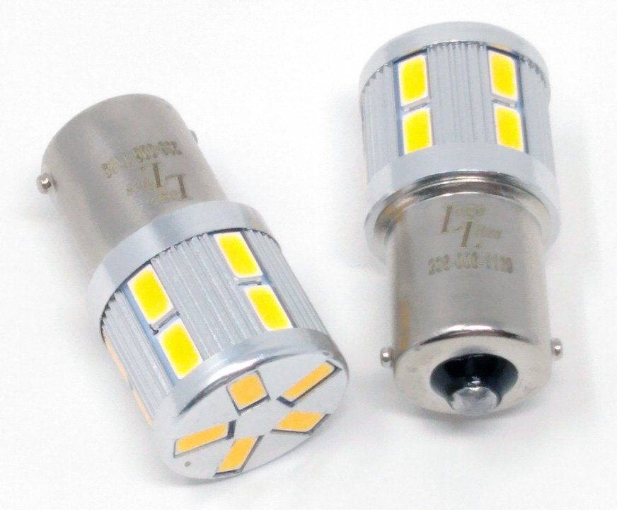

In the website, look under LED bulbs... You will find your non-staggered pins to use on your car..... www.logolites.com. 3407 Duluth Highway 120
Duluth, GA, USA 30096-3341........770-476-7322.....give them a call, they will be happy to answer your questions and help you with the bulb that will work best for you.
