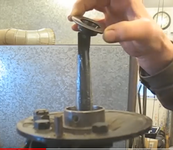

I'm curious about the inner seal. Is it the type that is stamped with a modern neoprene seal pressed into it. I'm thinking that the seal can be
replaced & reinstalled? Have others used these & what results have you had?
Craig.
Craig.

Same questions:
What is the reason the rear axle is being restored to begin with.
How long ago were the Modern inner oil seals installed.
Given the time effort and other part costs to rebuild a rear axle why risk a $17.95 part fail? --
Steve Jelf how to https://www.youtube.com/watch?v=AfxWPsF4KhQ
By Steve Jelf, Parkerfield KS on Monday, June 27, 2011 - 12:14 am:
I agree, no problem. I just installed a set in my roadster. I ran a little bead of Permatex around the outer edge where it fits against the end of the tube. That's not just to keep the seal from spinning, but also to help it seal to prevent leaking. Before sliding them in, I stuck a piece of electrical tape over the keyway just to "soften" the sharp edge to prevent damage to the neoprene, then smeared a little grease on the axle shaft to help them slide. Easy as pie.
