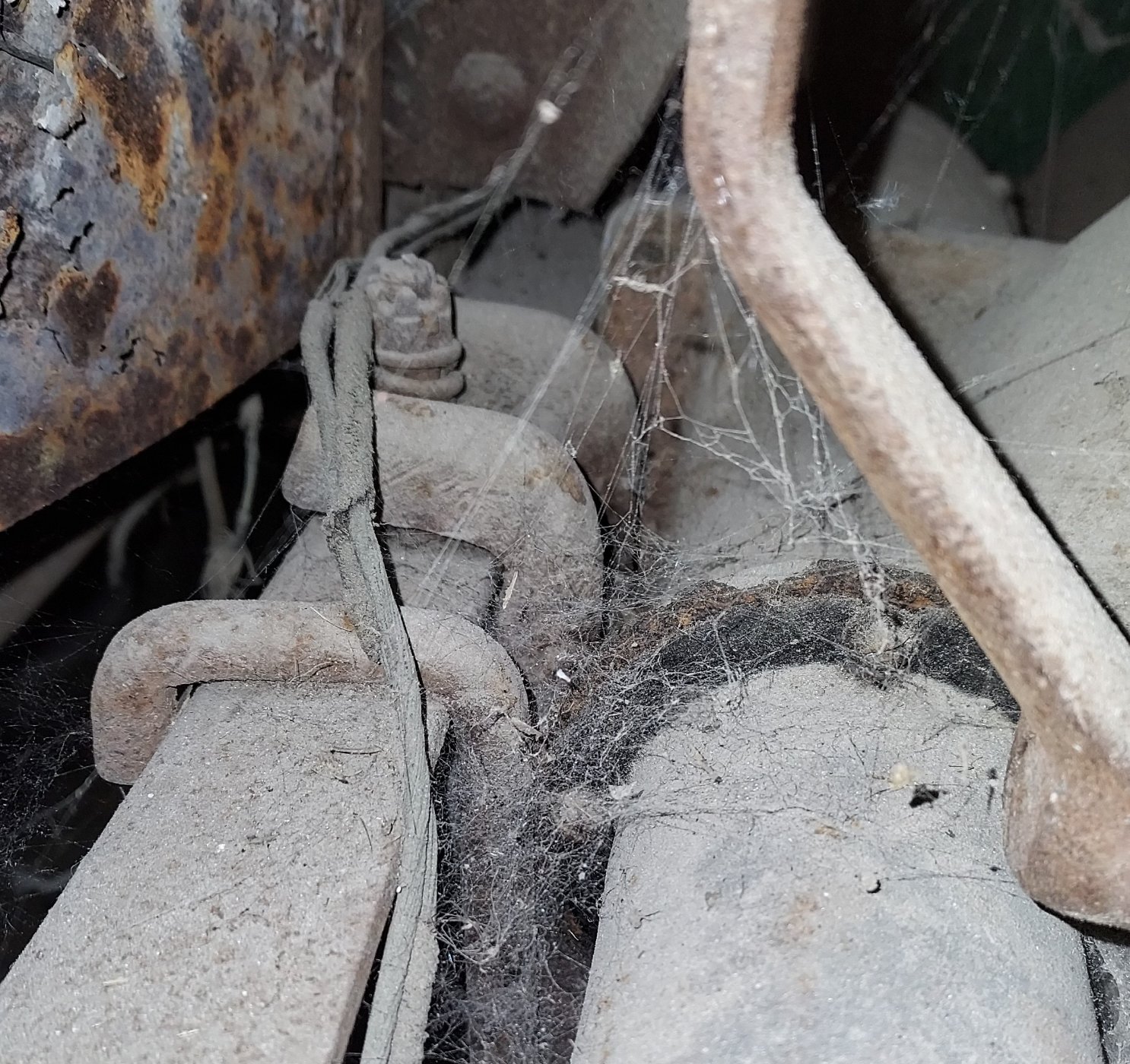

As an owner of an unrestored 1924 TT with the single bolt and spring fastener method, I can attest it did not solve the problem of broken crankcase arms. It is worth noting that Ford never applied the TT mounting method to passenger cars.
The attached photo is a 1924 TT crankcase arm using the long bolt and radiator type spring. The heavy metal hook on the side of the arm is for a belly band because the crankcase arm is broken.

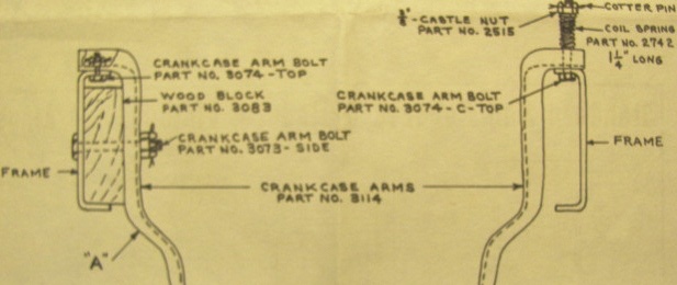

Here is that way to mount, as suggested not by Ford for the T, but by a long time T'er. Do so if you wish.Mike C wrote: ↑Fri Apr 26, 2024 11:03 pmIt says to use the crankcase arm bolt from a TT and using the 1.25" spring as the one used on the yoke to cranckcase connection. I can't find these drilled shank bolts (TT 3074) anywhere. I assume it's a 3/8" diameter. What is the length of he shaft? I'll have to drill a cotterpin hole.

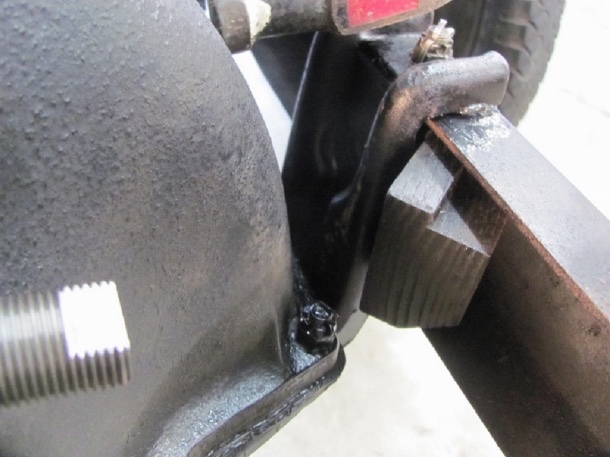

IMO the wood block and std mounting hardware is better for the T. The wood block does help resist frame twist on braking and acceleration. The single bolt, even with a spring can't do that.
That bolt, p/n 3074C is TT CC arm bolt, longer for the TT . The bolt is 3/8" x 24 and is 1 7/16" long.
The wood block, fitted very snug inside the frame rail and against the crankcase arm resists side twists of the engine and frame.
