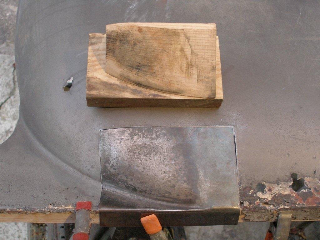

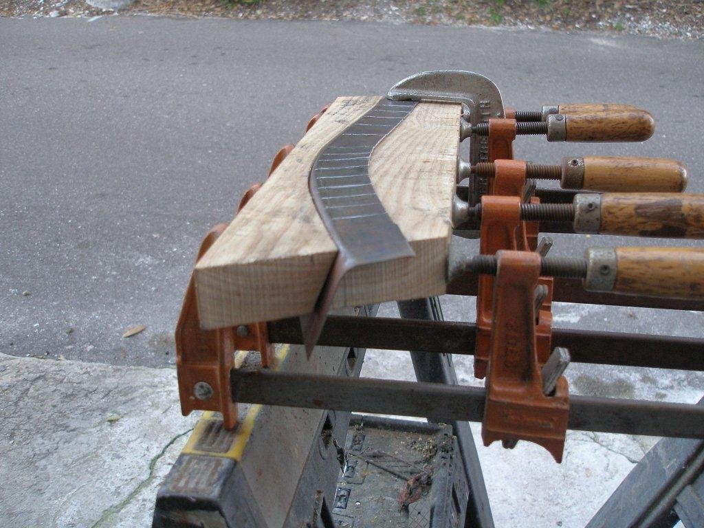

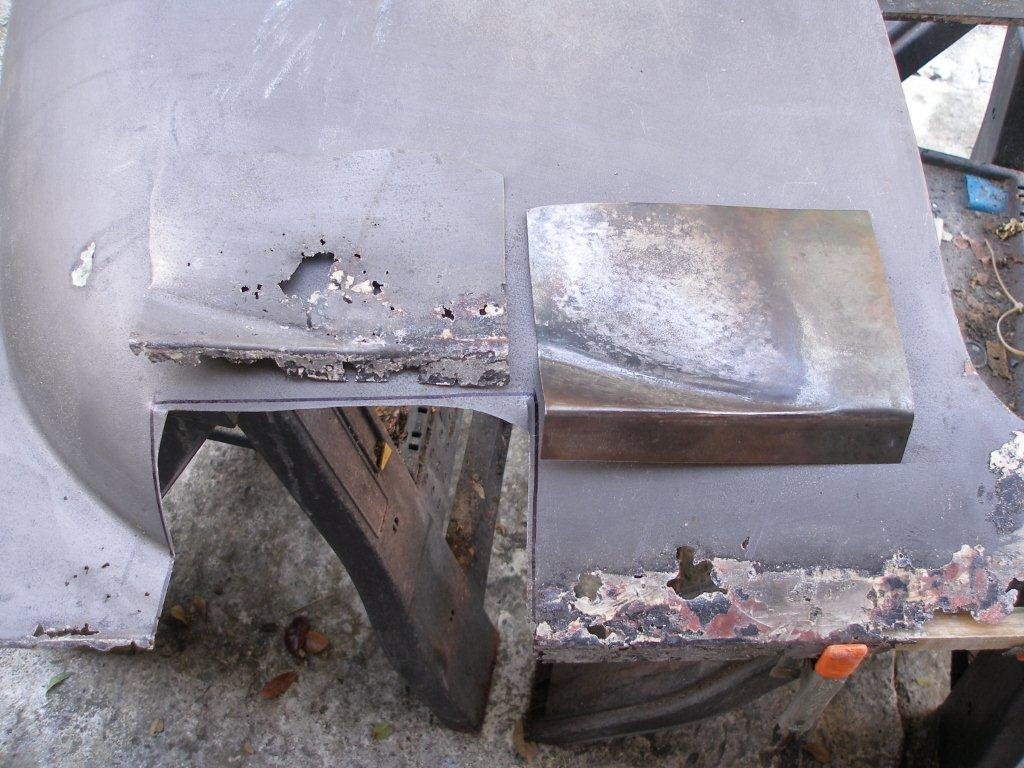

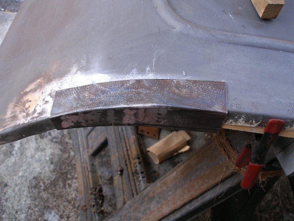

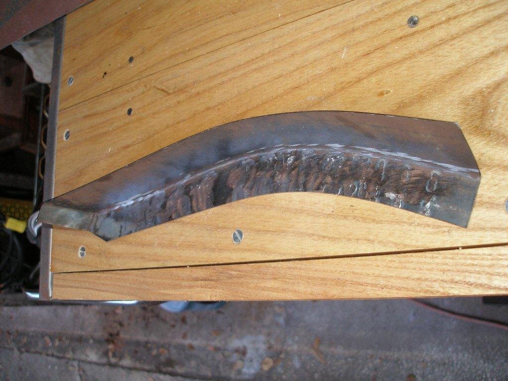

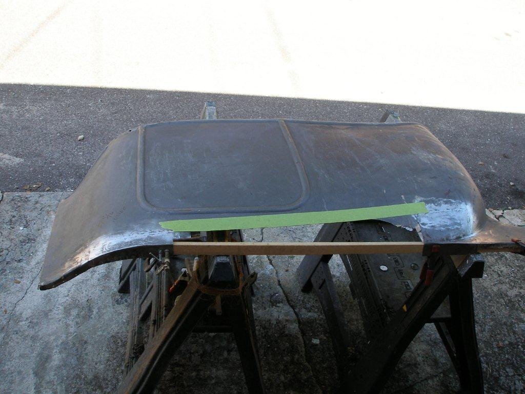

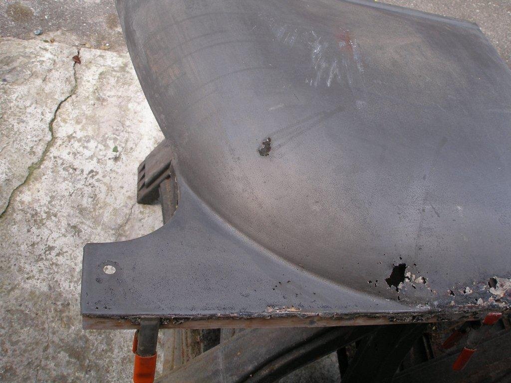

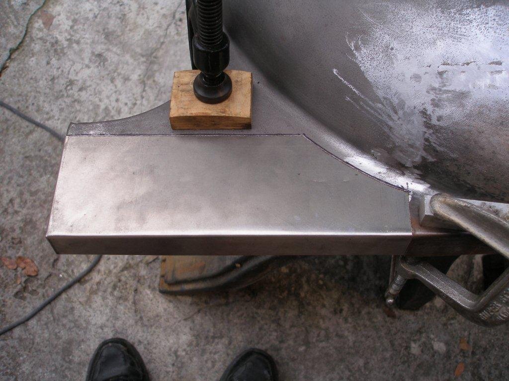

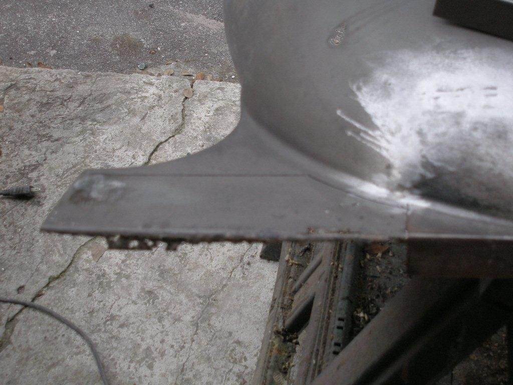

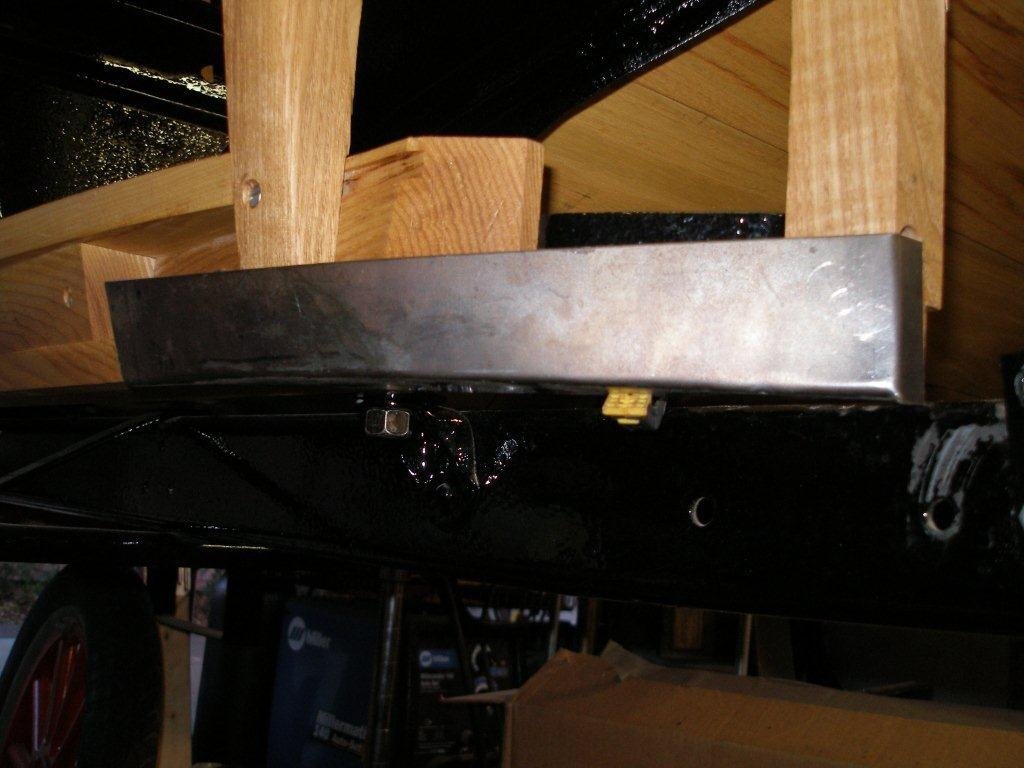

I purchased sections from Langs and found them to fit too poorly to make the effort to use them worthwhile. The entire bottom 6-8" was rotted or just missing from my body. I made wood forms where necessary and formed sections and welded them all together. It was my welding class 101 and I passed. You will put in almost the same effort with the panels you buy, so you might consider saving yourself some money and make your own. My panels are a patchwork quilt but the end result was a body that was metal finished and has no bondo in it.

- Posts: 6720
Re: 1923-1925 touring side panels

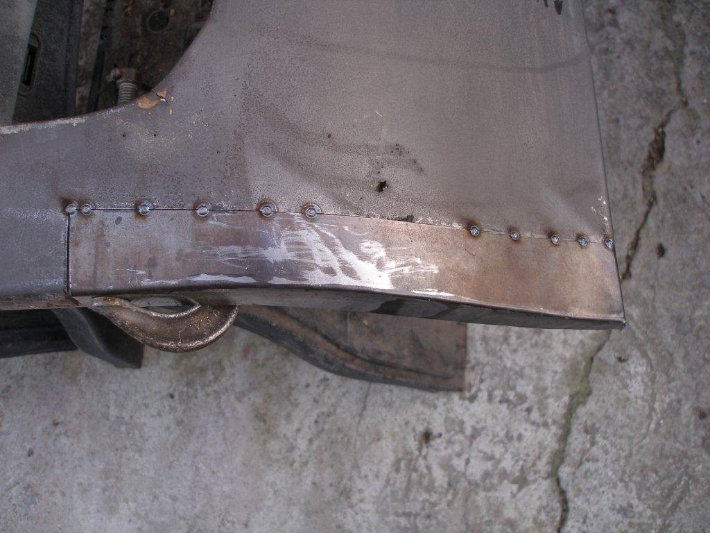

Some more
- Posts: 6720

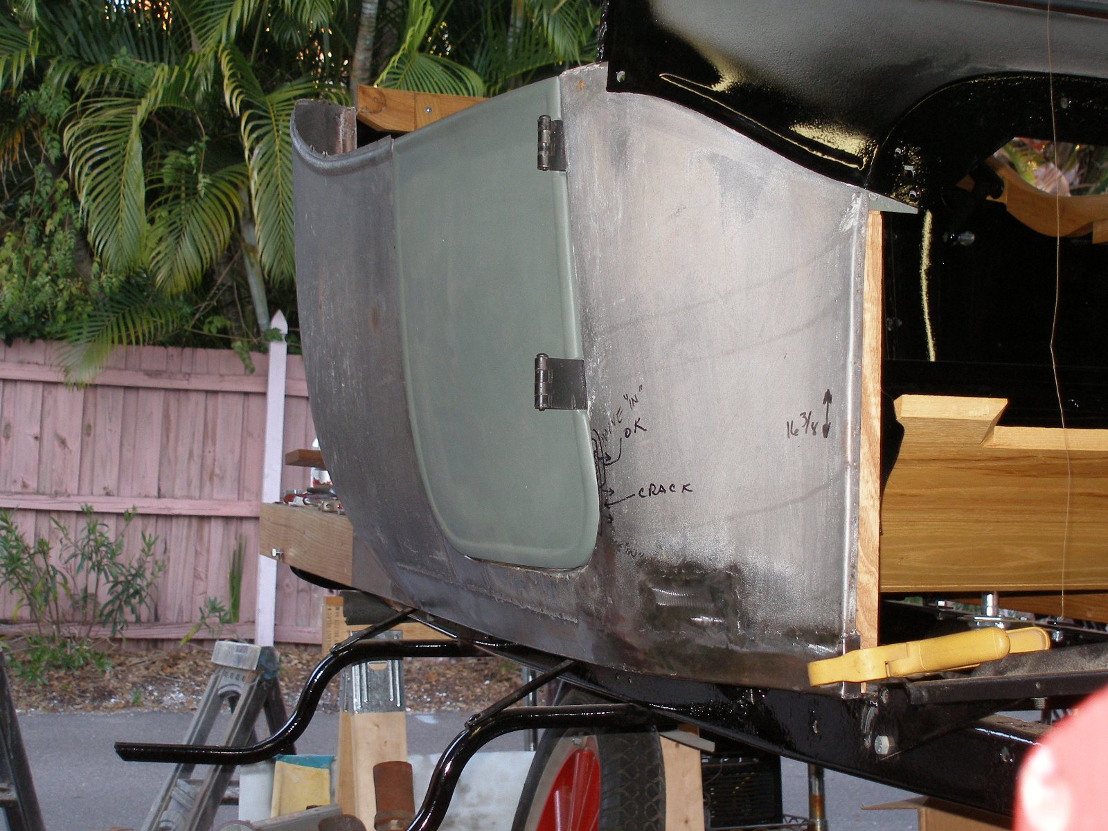

End result:

I credit this to an old book called "Metal Bumping" which was fantastic, a Miller-Matic MIG welder and a supportive wife who said "buy the d**n welder and get started!" I was afraid of the welding, but not the wood work, so the wood sat finished for a year before I got the gumption to buy a welder. No one would ever want to pay me for welding work...as that body represents probably 100 hours spread over 5 months...lots of hours thinking and then 2 hours of welding, then lots of hours thinking, again. I had to visualize the completion of a part before I'd attack it. Once figured out, even the most complex curve can be broken down to a few basic operations, sometimes repeated multiple times. I'd recommend hearing protection...I didn't wear any and I turned a mild case of industrial induced tinnitus to a really good case of constant whistling in my ears due to all of the hammering. Stupidstupidstupid.

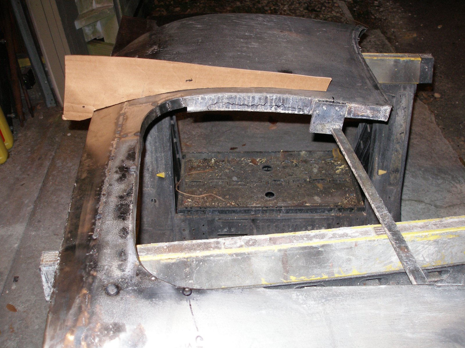

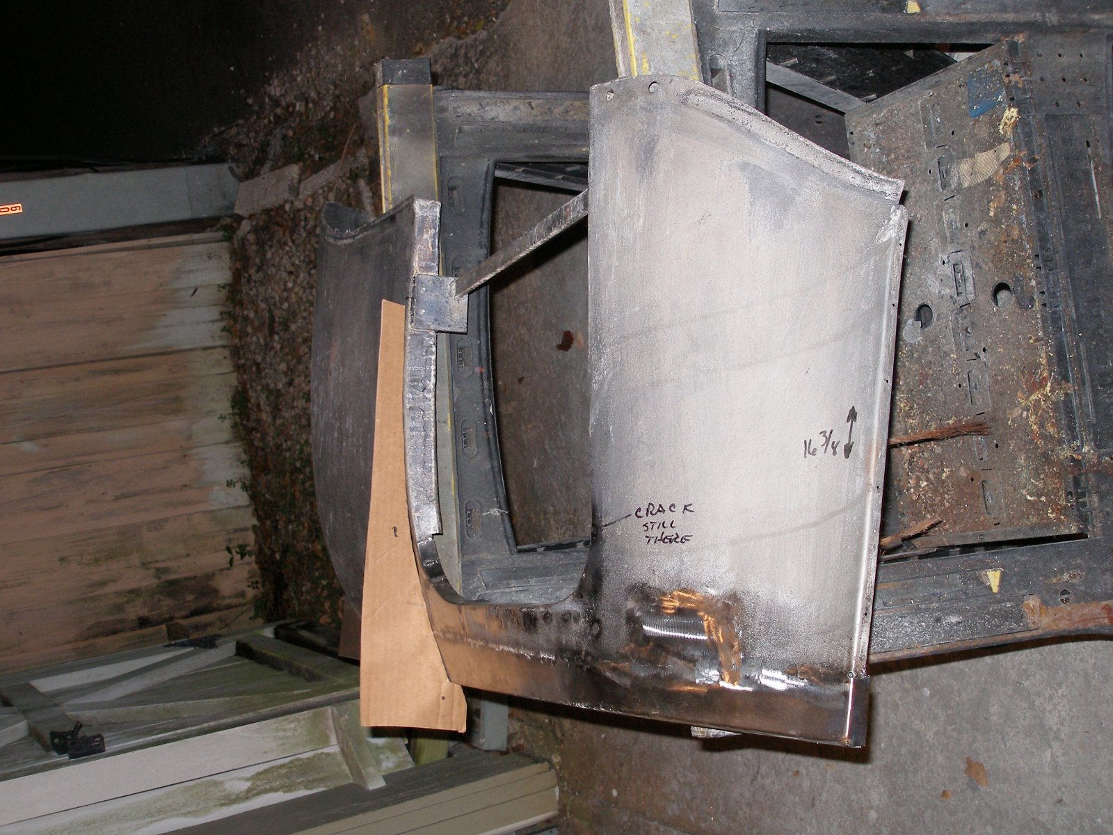

I'm including a picture of the brace I welded up to bolt to the door hinge and latch face to keep the door opening correct. You must hang the metal on the wood structure, get the door aligned and swinging well and then remove the door and build the brace in place so when the skin comes off you can reassemble it into the sheet metal.
you are most welcome
