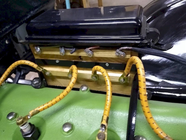

The engine is not running and I suspect it’s both a fuel and spark issue, maybe valves. I hear about three to eight hits and then it dies. Sometimes it runs on three cylinders. The choke rod to the dash was dragging against the hot pipe to the carburetor but I fixed that. Two weeks ago the carb poured out gasoline when I switched the flow from the sediment bowl to “ON” but now that problem rectified itself most likely from fresh fuel cleaning away any varnish. Having done the above, I resumed with electrical diagnostics. There are four new coils and all new wiring harnesses.
With ignition switch to BAT, slow hand cranking does not always result in buzzing coils. I pulled out the VOM and started with basics. Ignition to OFF. All four cylinders at the coil box commutator wires were shorted to ground and each other. Silly me, the coils in each coil are connected to the 6v positive which are spliced together. I removed the four coils, tested again. None of the 1-2, 1-3, 1-4, 2-3, 2-4, 3-4 are shorted together nor to ground. Tested the four spark plug wires, each passes with continuity.

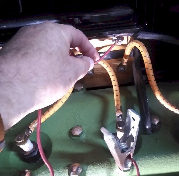

Fuel and ignition OFF. While the coils were still removed, I clamped one VOM probe to ground and clamped the other probe to each of the four timer contacts at the coil box and hand cranked the engine. I confirmed a 1-2-4-3 firing order. The wires are also in the correct color order. I confirmed continuity of the wiring harness from the timer to the coil box. I expect a beeping VOM exactly every half turn of the crank but that’s not what I am getting. If fact it cuts in and out in the range at each half crank. The same thing happens with the coils back in the box and ignition ON. The coils buzz somewhere around each half crank but also cut out.

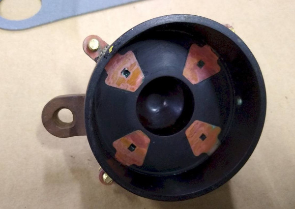

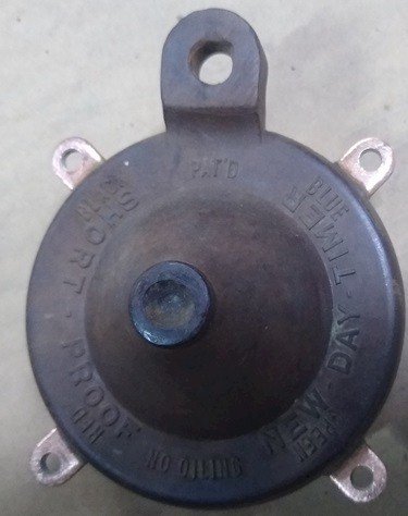

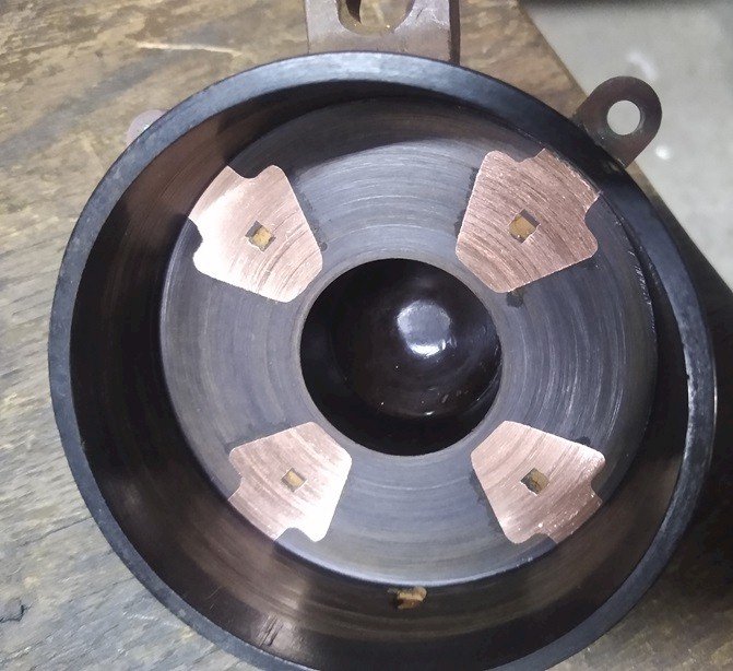

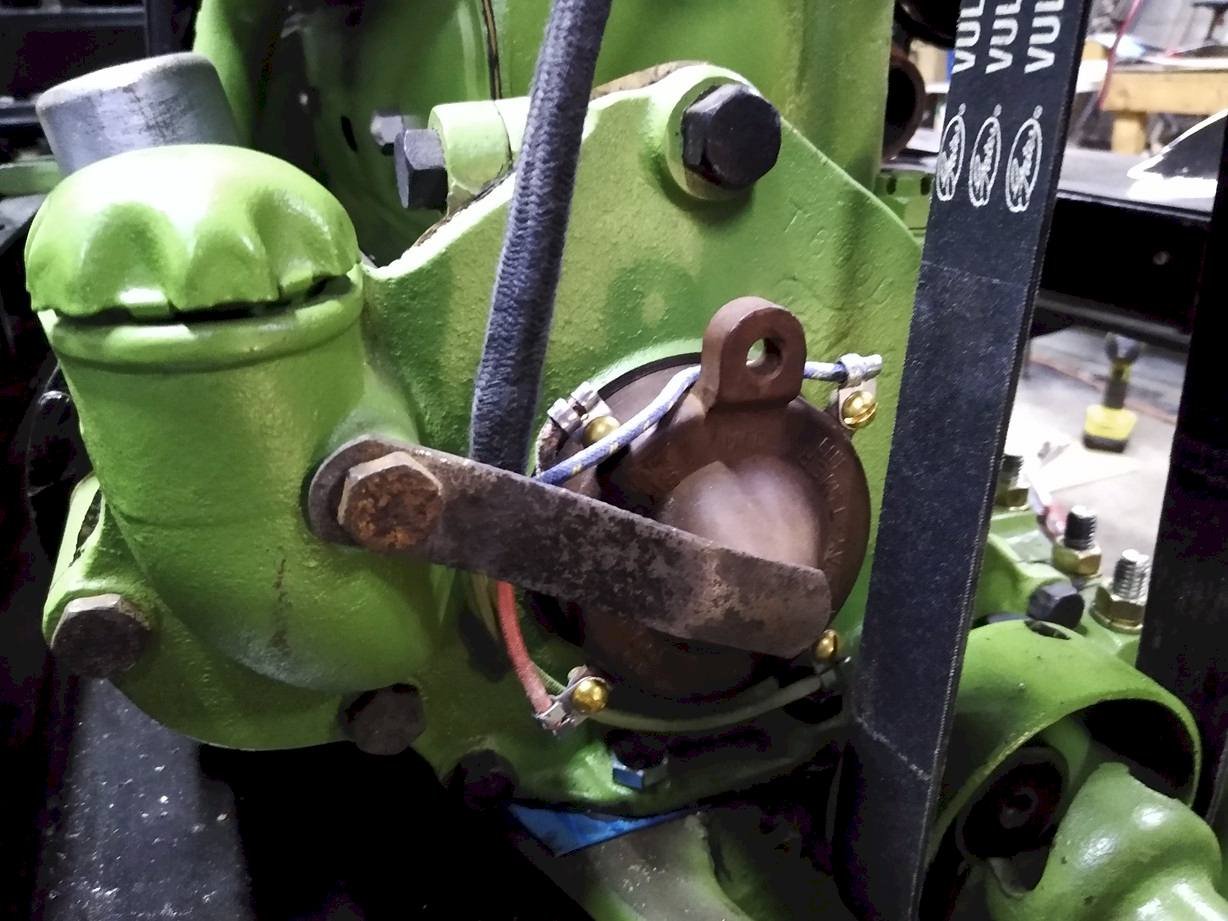

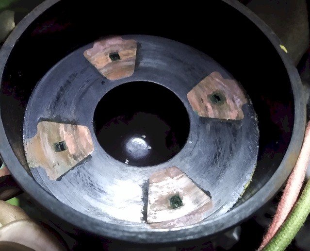

“Olivia Hardy” (improved Coupe) has a New Day timer that I cleaned up. The four contacts on the surface were cleaned up. At some point, I was advised to remove the brass plate, which I did. Early this year, it used to run for a minute before it ran out of gas.

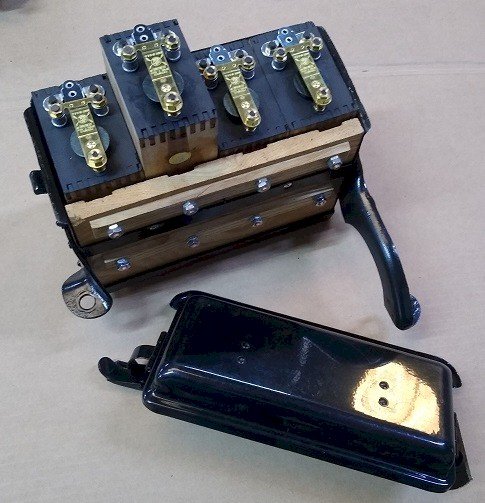

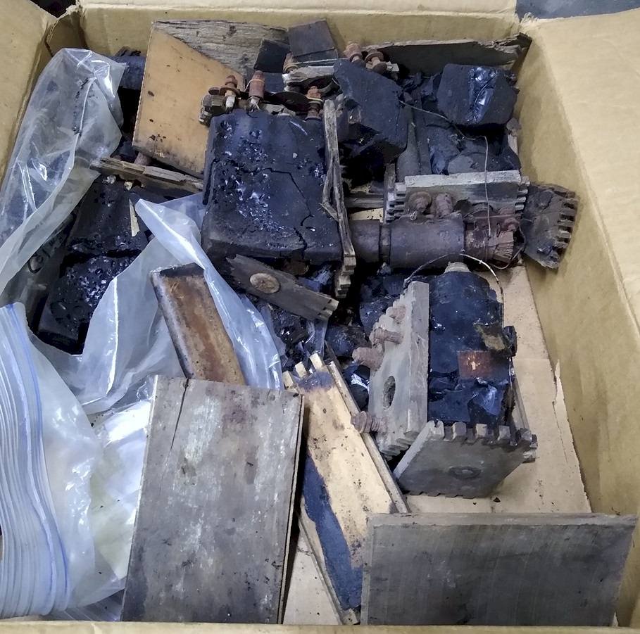

The coils are "new" to me. Here are my "old" coils.
Reputable? I don't know.
Properly adjusted? I don't know.
My paperwork says "The Coil Doctor", "tuned to perfection using ECCT".
I can get a better photo of the contacts.

If they're from "the Coil Doctor", they are adjusted right. Was the engine running recently? compression? I agree that those timer contacts need polishing. Check the timer rotor. You need fuel, timing, and compression.

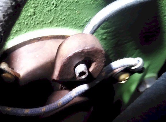

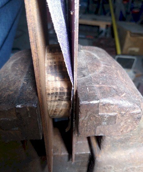

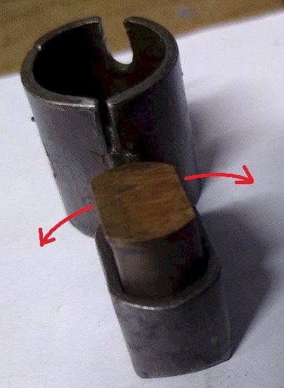

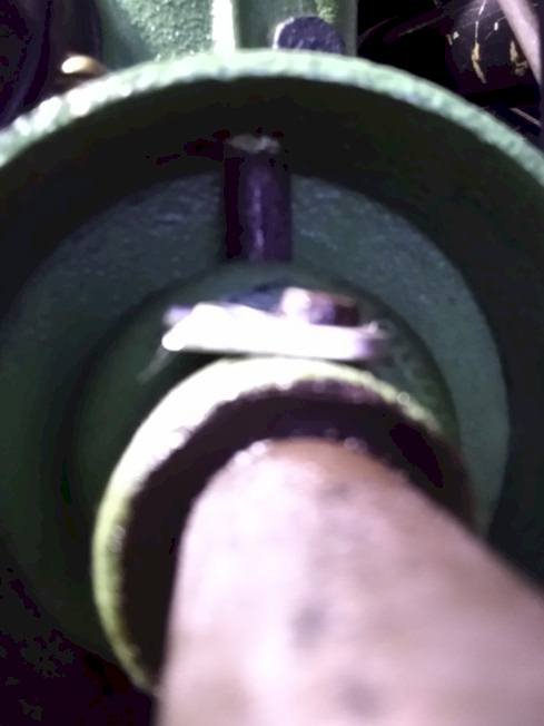

Check the timer rotor. Here is the brush. It wobbled back and forth. I squeezed the sides to remove play and it's three times better. The switch can lose continuity. When I found problems using the VOM, the switch was out of the equation as it was OFF and I was bypassing all use of 6v by testing only the ground side. Ground to rotor to contact surface to wire terminals at the coil box. But, if Vern honestly doesn't know what "new" is, I'm certainly willing to cycle and clean it.
The contacts in the timer appear discolored - perhaps a little polishing to shine them back up.
I have only run the engine a total of maybe five minutes since that photo. But when I opened it up tonight, it was way worse. I will be using the idea I got from Steve Jelf. Glue should be set in the morning.
Compression? Will check.

The end of the brush does not appear to square to the body of the brush, (maybe just the perspective of the photo?). If the brush was allowed to lean and to wear to one side, the out-of-square condition makes sense. Now, however, you have taken away the extra play and the brush no longer leans. That's fine, but now, with the end not square, the brush face will not fully contact the timer body. It would make your timing way too late. I would suggest putting it back together and checking your timing.

If the timer brush is squeezed too much, it may fail to make reliable contact with the timer cover. The ones I have seen have some wobble between the brush and brush holder. If the spring behind the brush is too short or too weak, it may cause poor contact.

The second picture of the timer cap looks like the brush was scraping and probably bouncing. A good New Timer will go a long time without any service, but yours doesn't look very good. I have a new day on one of mine and it works well. When running on battery, the coils should buzz from the time the brush makes contact till it breaks contact. It should be constant buzz at any position between those points. However on magneto, it will buzz when the sine wave reaches the amperage the coil was set for. Another good one is Anderson. That kind also lasts a long time but be careful not to move any of the contacts by letting the nut closest to the timer get loose when you connect the wires. I have never had a roller timer on any of my cars, so couldn't give any experience with those. Anyway, If the passages between the gas tank and the carburetor are clean and the float does not stick, the only other thing I can think of which would cause carburetor problems would be worn adjustment needles or clogged idle passages in the carburetor. The NH gives the least trouble of the carburetors, but some of the others give you finer adjustment for different speeds.
Anyway, as mentioned above, check compression and sticky valves. Check your timer, and also be sure the carburetor is adjusted correctly.

with the end not square: Correct Jerry, it's not square. Yes I agree about delayed timing.

If the timer brush is squeezed too much: It freely moves in and out by spring pressure. But I don't know what correct spring pressure is.

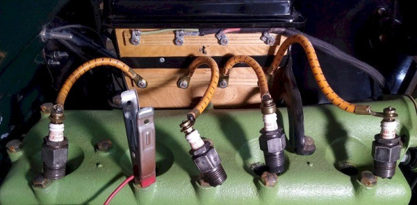

Giggled the key back and forth OFF to ON.
Reassembled the timer and pulled the crank handle many times. It coughs a lot, fires anywhere from one to three times and stops.
I advanced the spark lever mid way, pulled many times and it fires one to three times.
The carburetor is not leaking and dry on the outside but I noted a drip from the connection between the intake manifold and the carb.
Jacked up the rear wheels off the ground on stands, disconnected the clevis pins to the brakes at the handle. Pulled the crank and fires the same way. I do hear the wheels turn a little.

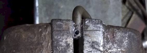

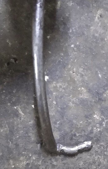

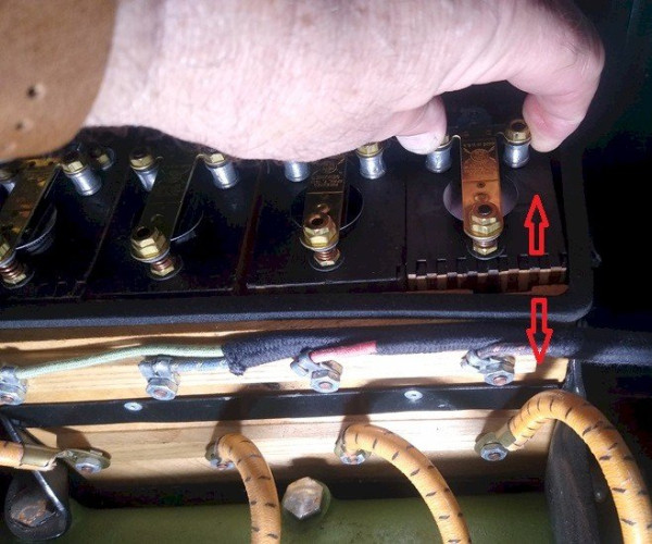

However, I realized that I’m getting a buzz every half turn every three pulls and nothing on the fourth. The advance lever is in the middle. Then I push it to full retard and to full advance but nothing. The fourth one is completely dead now. So, I clamp a wire to ground, switch the ignition on and touch the other wire end to each of the four ground connections at the coil box. Three of them *spark* and buzz but one does not.
Coil #1 is not firing (no spark, no buzz). I have a “new” fifth coil but why do that?
So, ignition OFF, swap coils #1 and #2, ignition ON, test again and all are good. What?

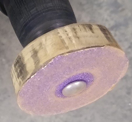

Time to look at the contacts in the coil box. Found something but not what I was expecting:
There is movement towards and away from the contacts. Time for a wedge or a shim.

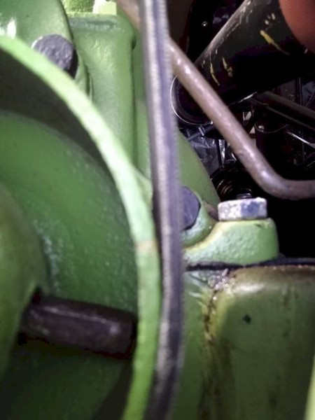

I think your timing is way off. Try turning the crankshaft to where the pin through the front pulley is just below straight across on the left side of the car as you would sit on it. So that would be the right side as you face the front of the car. At that point the timer should be set with the ignition on battery and you rotate the timer to the point the coils just start to buzz . Then the rod between the timer and the lever on the steering column should be bent so it fits into the timer without moving the timer. Now to test things out rotate the crankshaft and the buzz should come just after the piston starts down on the power stroke. The engine should be started with the spark lever all the way up and as soon as it starts pull the lever down about half way. Easy with a starter but you need to run quickly if starting with crank.
- Posts: 5087
Re: Not running - need direction
The service manual covers timing using a roller timer.
New-day timers are timed way different.
Follow Norm's method. Pin should be @ 3:30

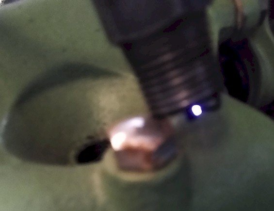

Might as well pull all four plugs and test for spark if I'm going to pull one.

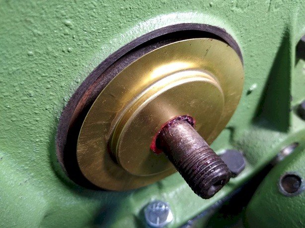

Do you have a roller type timer: No. Dennis, it's difficult for me to picture what you are saying but it sounds like the concept may be worth its own thread with photos and diagrams if it can solve a problem.
The #1 coil was at a complete fail state. So, it would have been impossible to set the timing.
I made a shim, placing it behind #1 and now I get a solid buzz every 1/2 turn without cutting out.
Cranked the engine and got 8 hits in a row.
If the passages between the gas tank and the carburetor are clean: Bought some fresh gas and poured in about a gallon. Unscrewed the fuel line at the carburetor, no mess. Turned the sediment bowl cock to on temporarily and fuel flowed out.
I think your timing is way off: Started with the instructions that I printed off and got stuck at step 1.

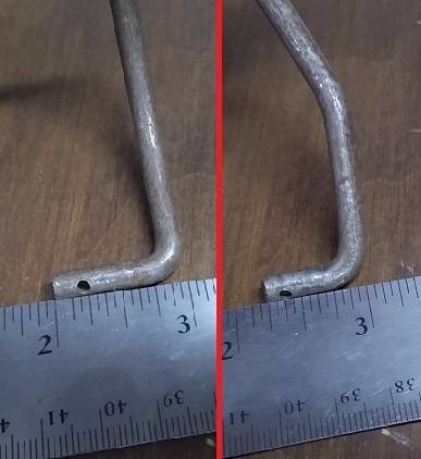

The rod (that I got from the vendors) can not be removed from the timer without removing the cap from the block. I will never be able to get it back in without messing up the timing adjustment in step 9. Either the end lengths were made reverse or I did something wrong. I spent the remainder of the evening, removing the rod, cutting it shorter and re-drilling the hole.

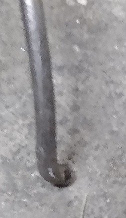

Maybe I'm picking a nit here, but I adjust timing rod length with simple bending.
- Posts: 4694
I do too, however, he says he cannot remove it from the timer because it is too long from the 90 degree bend and the end of the rod. He would have to remove the timer to get the rod off.

Oh! the frivolity.
Steve, I'm glad that your brain still works that way but I don't think everyone caught on.
re-drill the hole for the pin
just don't cut it too short
So the three next photos are for your...satisfaction. OK, and now for the seriousness.
Ignition ON - engine moved, but no free start.
Shorted ground to the top four terminals - buzz w/ no further engine movement.
Pulled plugs to test for spark.
#2 fails to spark, and no coil buzz any more.
I made a small shim for the back side of #2 coil.
Shorted ground to the top four terminals - buzz and get a spark on all four.

Seriousness continued...
The commutator rod has plenty of room now and there is no binding:
1) Moved spark lever all the way up
disconnected the rod linkage from the timer.
2) Rotated timer counter clockwise (as facing it from the front).
3) Removed #1 plug.
4) Place thumb over the spark plug hole.
5) Pull on the crank until you feel compression, stop.
6) Watch the crank pin as you slowly move the crank until the pin is horizontal...
Before moving the crank any more in step #6 and I found this:
3) Removed #1 plug.
Vern (Vieux Carre)
- Posts: 4694
It appears you are making progress. put the lid back on the coil box and do test again. If they still buzz, Leave the coil box alone and put see if the coils buzz as you turn the crankshaft 2 complete turns and all 4 coils should buzz. If so set the timing and after that leave the ignition system alone. (If it ain't broke, don't fix it)
- Posts: 5087
Steps 3 thru 6 are not necessary. Get the pin to 3:30/9:30 & check/set the timer firing.
Dosent mater which cylinder your are on. All 4 cylinders fire @ the same position of the crank pin.
In your case, if you are on # 1 & not getting a coil to fire, rotate the crank one half turn & try again.
- Posts: 4613
You mentioned the engine hasn’t been running in 6 months. How did it run before. What have you done to it since then. It looks like the engine has at least been painted and cleaned up. What else if any. That may be a clue in your starting issues. Or maybe not.

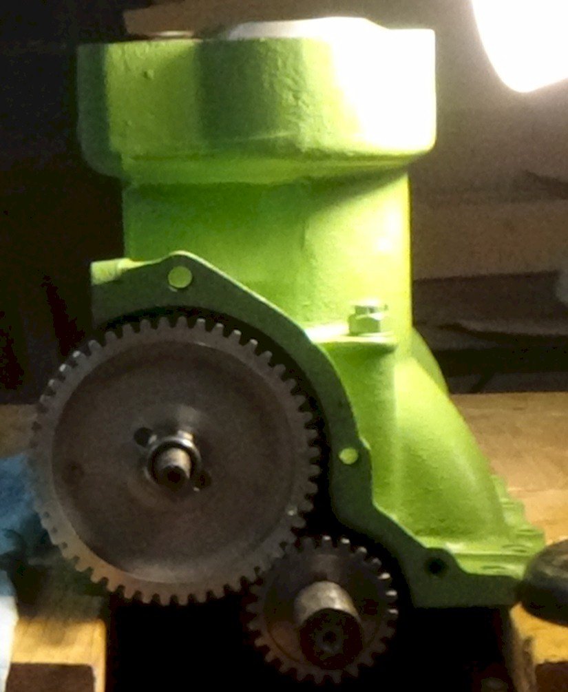

Is there any chance that when you replaced the timing gear that you got it a tooth off?
- Posts: 4613

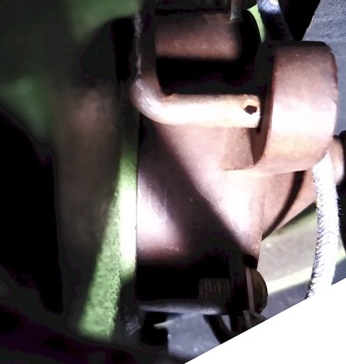

I think I can see the shiny dot on the cam gear but don’t see the one on the crank gear. Some crank gears have a dot but have see some with a line between the teeth.
- Posts: 4384
Some crank gears have no mark at all. The tooth that lines up with the keyway is "the" tooth to line up with the cam gear.John kuehn wrote: ↑Sat Nov 09, 2024 5:21 pmI think I can see the shiny dot on the cam gear but don’t see the one on the crank gear. Some crank gears have a dot but have see some with a line between the teeth.
- Posts: 4384
That's okay. It just means that compression is beginning. Keep turning until the pin is horizontal, as Step #6 tells you to do. Then you will then be at Top Dead Center, on the compression stroke. Now, continue with the remainder of setp #6: Now turn the crank just a little more until the pin is halfway between 3 and 4 on the clock. This is 15º past TDC.Now: What I am concerned about is that the pin on the crank is completely vertical and I am already feeling compression.

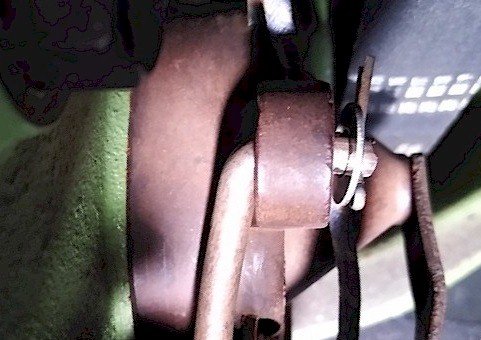

I was thinking that 90° more is not possible but then realized that this is not the cam gear. So, the gear set meshing is aligned up OK.
Completed step 6 by turning the handle little by little, photographing, and comparing it to a compass that I printed out until they matched.
7) Ignition to Battery.
8) Turn timer clockwise until buzz,
backed off until stop,
ignition to Off.
9) Bent the rod. (I can tell that the timing was indeed retarded. Photo)
10) Free to move.
I search around and still cannot find my adapter between Nation Pipe thread and modern straight to run a compression test.
So, that is abandoned and the plugs screw back in.
Retard timing, Fuel On, Ignition on, hand crank and...
It runs...heard sputtering and advanced timing half way.

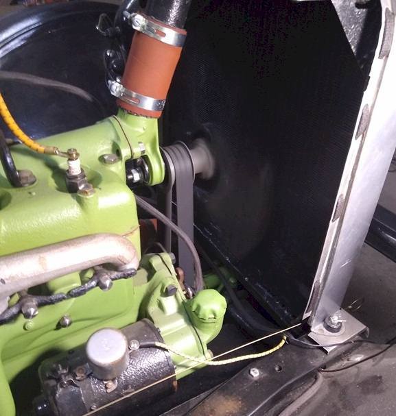

After three minutes of running...I checked to see if there was any water in the radiator - OK.
Lowered idle all the way slow and it runs like a sewing machine.
Thanks guys!
I took five minutes of video of it running (with the door open) until I closed the fuel, and Ignition Off.
Drove to wife's work and showed her the video.
To which she said, "That's the best birthday present that I've had."
ignition to Off.
10) Free to move.

The condition of your timer is still "iffy", (the brush end being not square). I would suggest buying a new one and keeping it on hand as a spare. Recheck the timing after you eventually install it.
