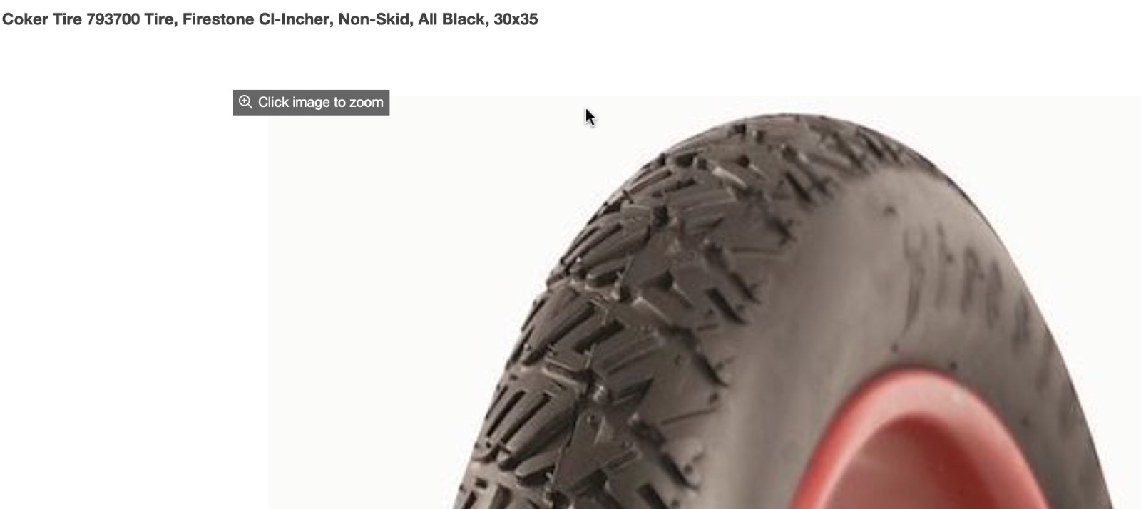

Re: Need a good photo of a new production NON-Skid Tire..

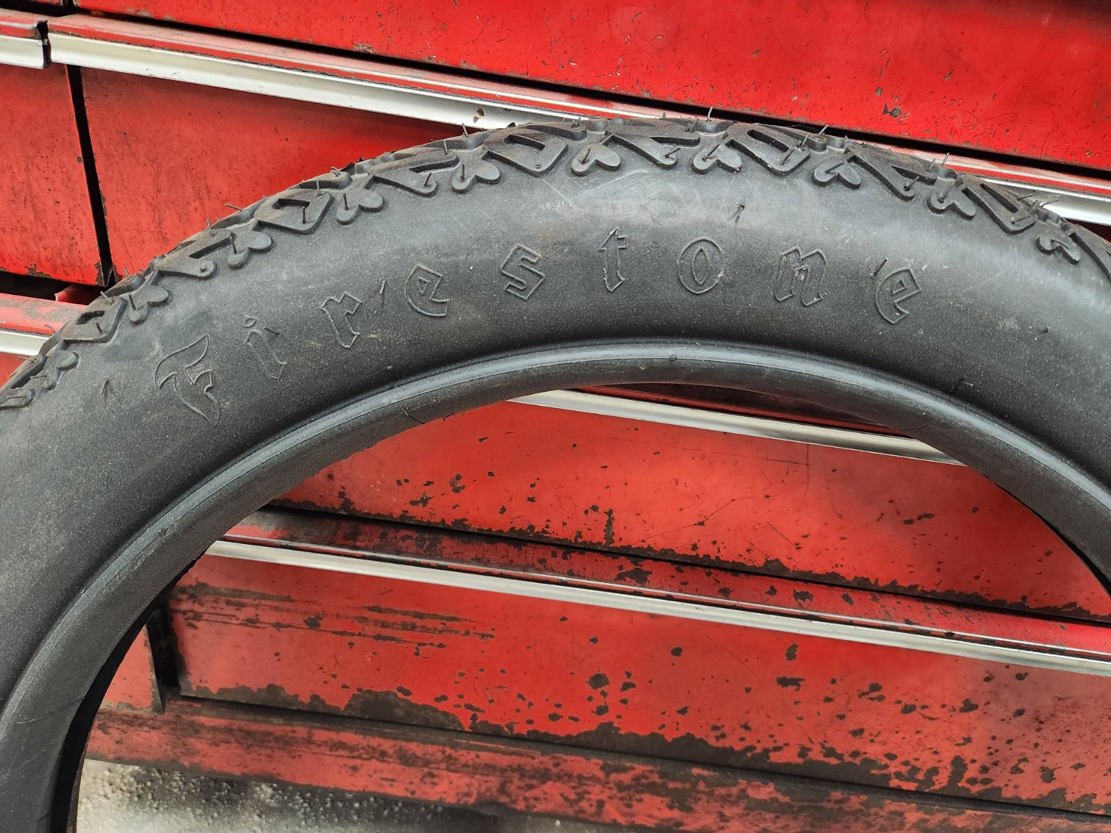

James
Don't believe that famous outlined script Firestone has ever been solid letters on these reproductions.
Here is current photo (zoomed) on Jeg's Performance website of that Coker supplied tire.
Dan... Thanks. I tried to manipulate those photo's but wasn't able to get the clarity. I didn't want to spring 400 bucks and end of with a mis-match, but that does look correct!

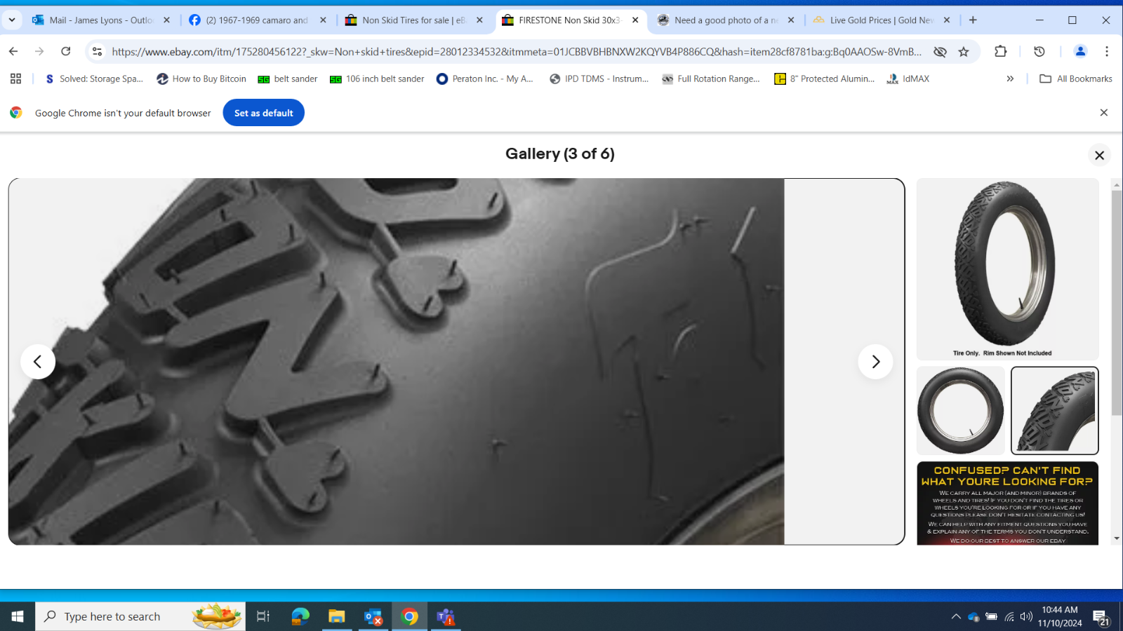

Dan/All,
See attached. This is from the sellers on Ebay. This looks like a solid letter to me.
Here is the Ebay link:
https://www.ebay.com/itm/175280456122?_ ... BMuLnt6-Jk

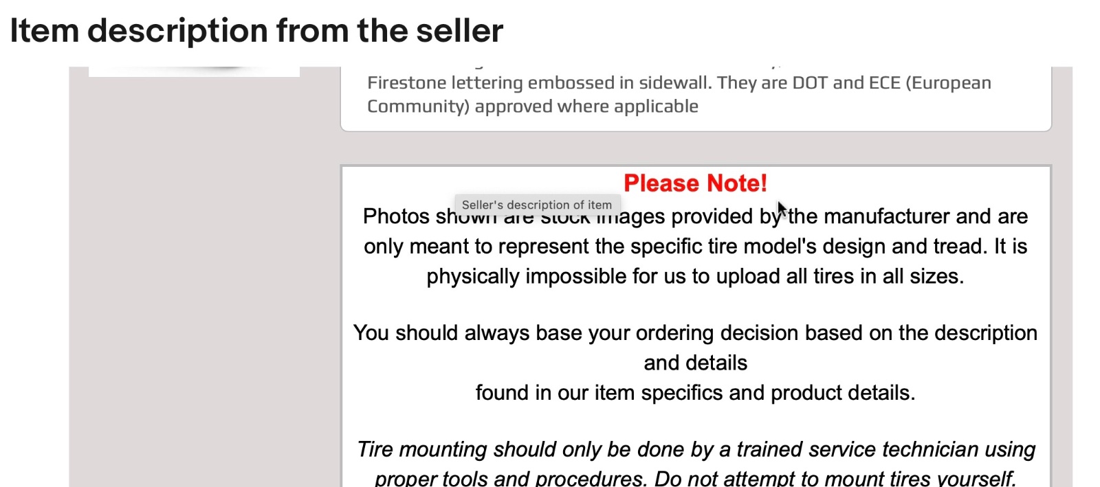

James
Better luck to phone call the supplier you wish to purchase from, and email using isn't answered as fast, how many time have you visited a store and the clerk interrupts your purchase to answer the phone
Calls work best.
Here is the website you posted, note it says photo is only representative image, and may not be correct.
Dan - That's precisely why I posted this and why I want to see a photo of the actual tire they sell for my size. I can't trust the stock photo!!

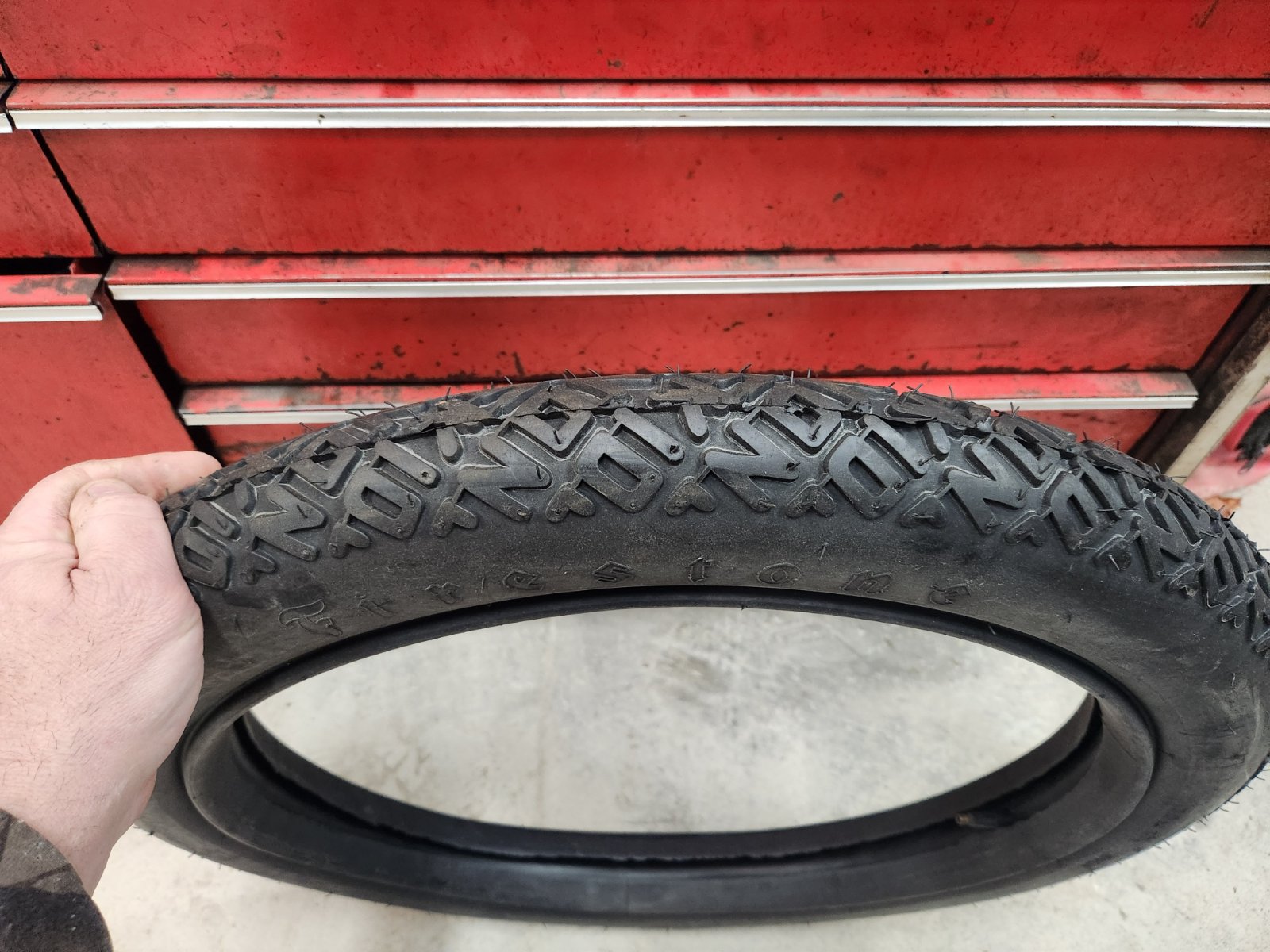

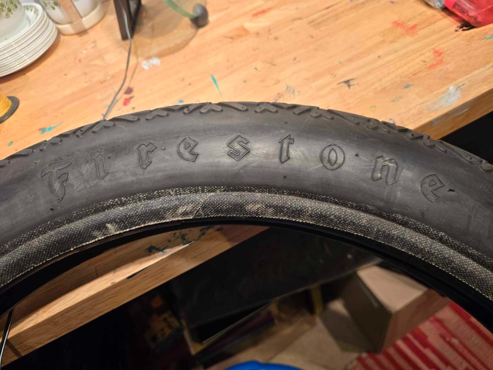

James, here is what I was sent by Coker. I'm a bit disappointed that they will have to be stretched to mount them.

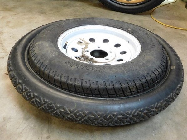

Ed, the safest way to stretch a BE tyre is to fit it over a deflated 14" modern rim/tyre and then inflate the tyre to stretch the clincher tyre. I stretched a set of old stock Olympic tyres that had shrunk 2.5" in circumference by fitting them over a series of modern tyres, each being a little bigger in diameter than the last.
Alternatively, if you just need to stretch it somewhat, you could use a Chev/other 23" split rim. Fit the tyre over the rim and jack the rim out with a rim tool. This was the last step I used on the Olympics. I ended up jacking the split rim join almost an inch apart for maximum ease of fitting. Hot weather is your best friend. Proper tyre fititng lube is a close ally.
Hope this helps.
Hope this helps.

RE: stretching clincher tires
My father has a 1910 IHC Model F roadster which he acquired in 1951.
It has 27 inch wheels and came with 34 x 3.5 clincher tires from the factory.
34 x 3.5 tires weren't available when he restored the car and I don't think they are available now.
To remedy the above, he bought metric 875 x 105 Dunlop tires (34.45 outer diameter and 26.18 inch inner diameter) and put them one at a time around a deflated truck tire and rim, inflated the truck tire to stretch the bead and let it sit overnight. That did the trick and he was able to mount them.
Here's a photo of stretching a clincher tire Dan Hatch posted on the forum a while back.
Note that this procedure works for clincher tires because there is no wire in the bead. However, it will not work with straight side tires because they have a wire in the bead.

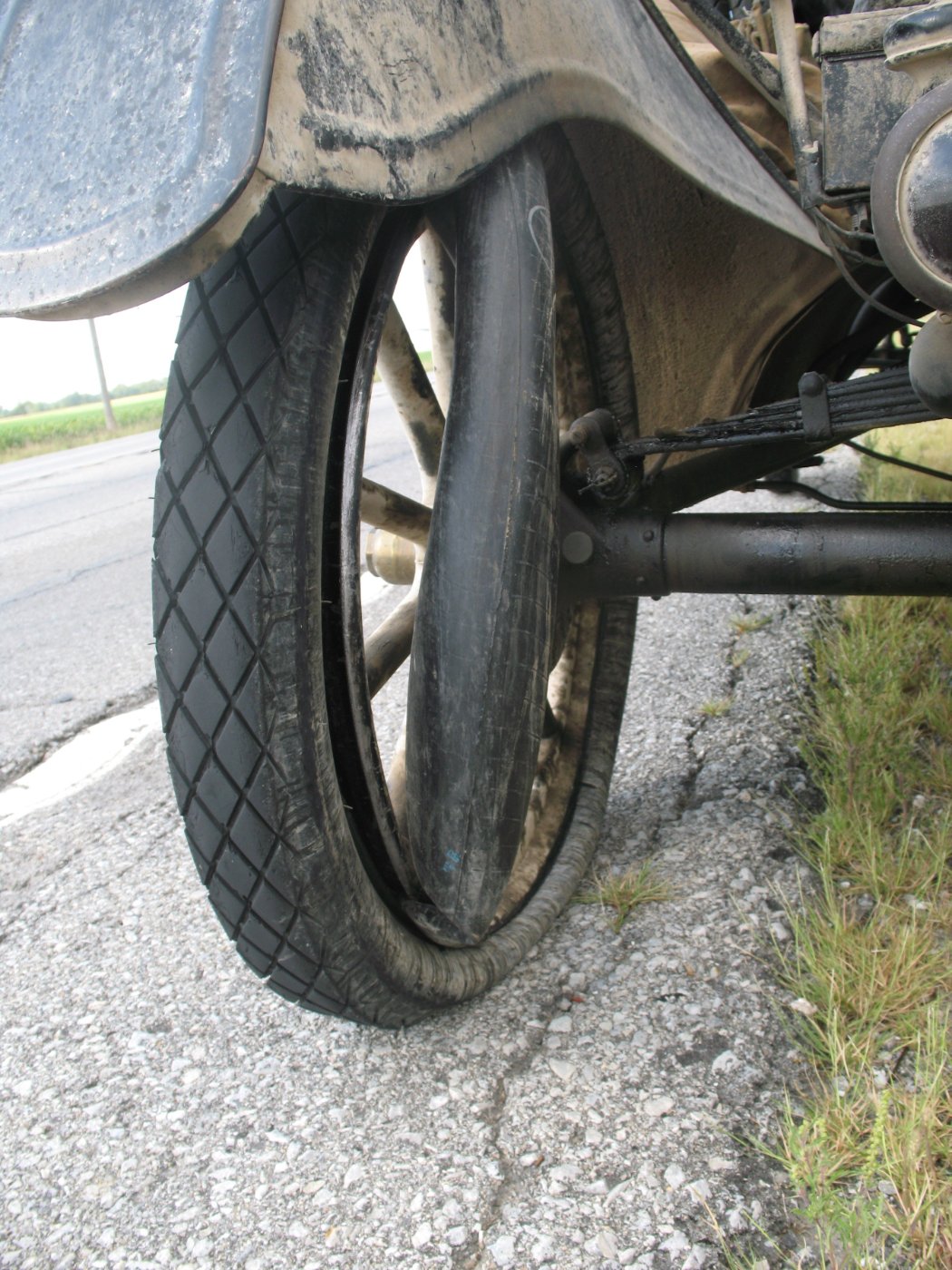

Some people object to Blockley tyres because they think the tread is incorrect for the Model T era.
1922 Goodyear
2023 Blockley (with a bad tube)
1922 Goodyear
