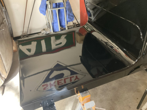

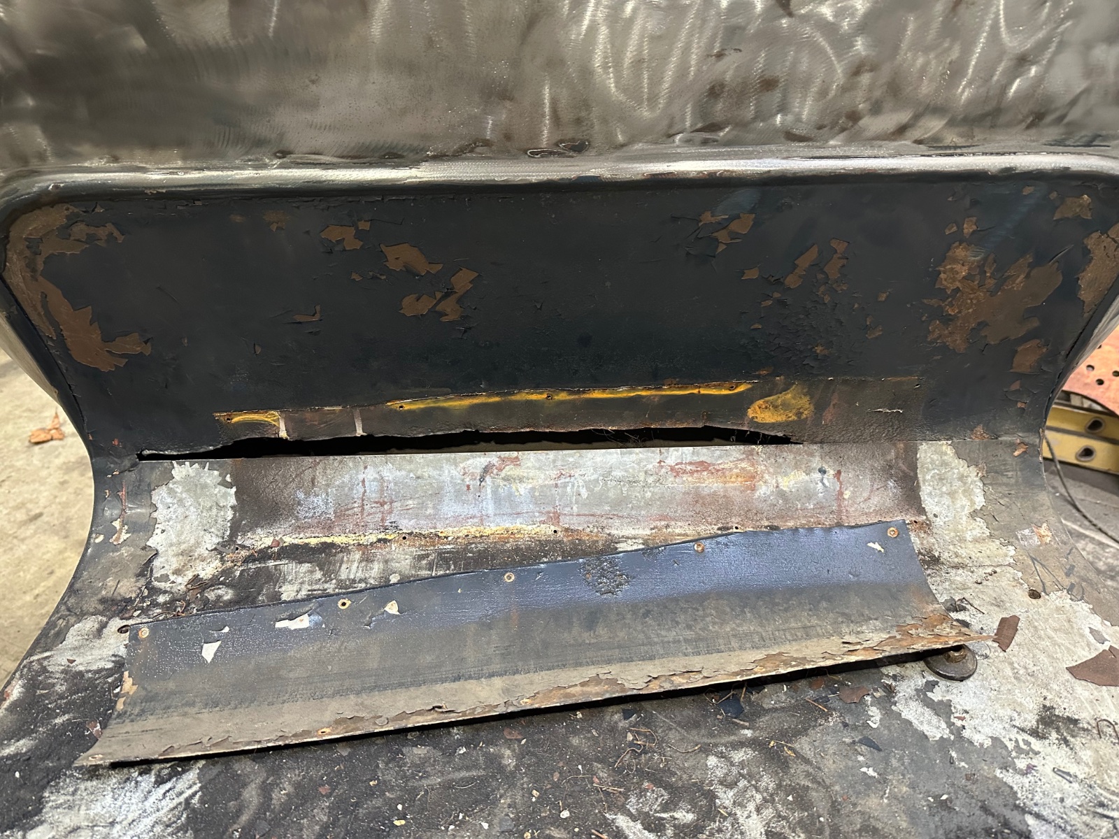

This is a 1914 Runabout body. It is s Beaudette body dated 10/14. Is this transition from the rear of the body correct? It looks like a patch. Art
- Posts: 1520
- First Name: Keith
- Last Name: Townsend
- Location: Gresham, Orygun
Re: 14 Runabout body question
That was added on. Looks like it needed it.
- Posts: 4456
Yes, that's an add-on. I think the piece of galvanized sheet metal is as well. I believe the rear panel of the body should slope/curve down to the rear deck floor, then stop after becoming horizontal. The rest of the rear deck should be wood. (I have a '21 Runabout. Happy to be corrected if my advice doesn't apply to a '14)

I figured as much. Can someone share a picture of what it should look like? Thanks for the info. Art
- Posts: 4456
I may be in error about the sheet metal deck covering. See here, Russ Furstnow's car... viewtopic.php?f=5&t=40709&p=312755&hili ... 14#p312755

Should the turtledeck have a wood floor?
- Posts: 3023
- Last Name: House
Yes, it is a patch and yes, it should have a wood floor. I have two ‘14 T runabouts. One of which I’ve restored and the other Ed Messenger restored. They both have wood floors. In fact, heres a picture of an original 1914 runabout turtledeck floor:

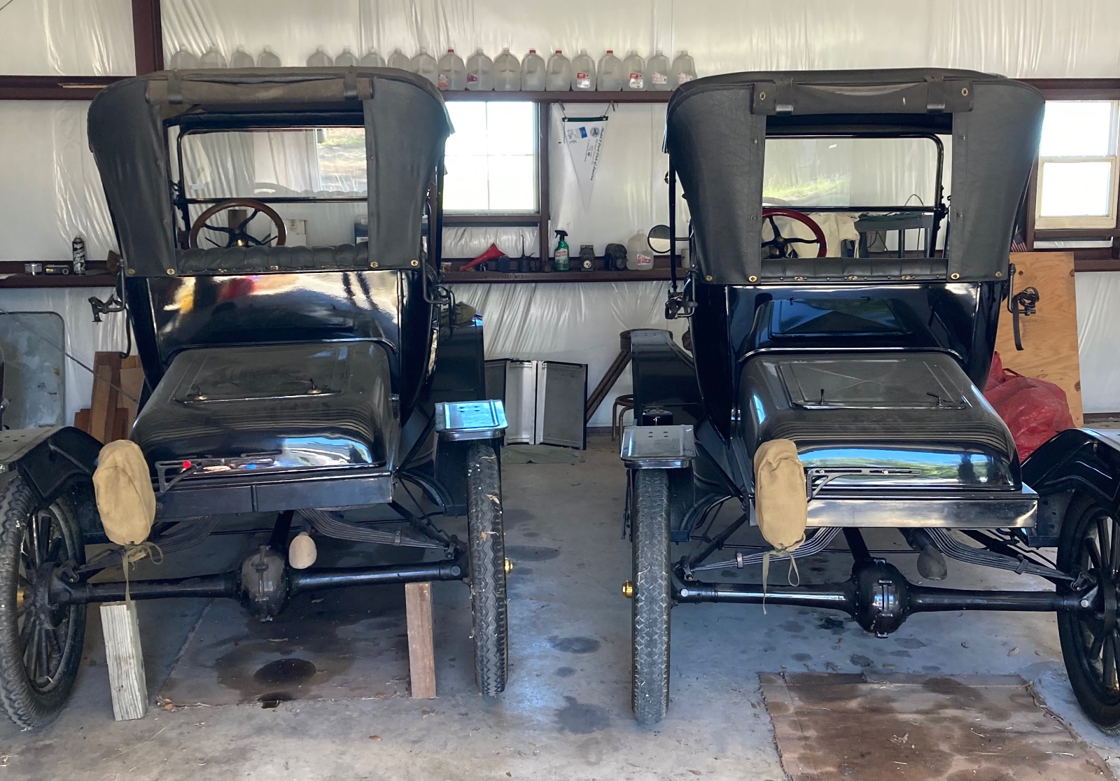

Art, I’m very sorry but both my Beaudettes have a turtledeck installed.
When the snowflakes start falling in Illinois, why don’t you drive south to sunny south central Texas and pick up that original turtledeck wood floor - like they all had.
Thanks Steve… the T on the left is an April 1914 so it has no bill front fenders and aluminum crank handle. The other is an October 1914 runabout so it has the ‘bill’ front fenders and cast iron crank handle. I’m very thankful to Wayne Sheldon for confirming the ‘14 models were factory assembled into very early 1915. They both sport U&J updraft carbs and are scary fast. I’d really like to give Art the turtledeck wood. Thought about donating it to the museum in Richmond for study or utilization.

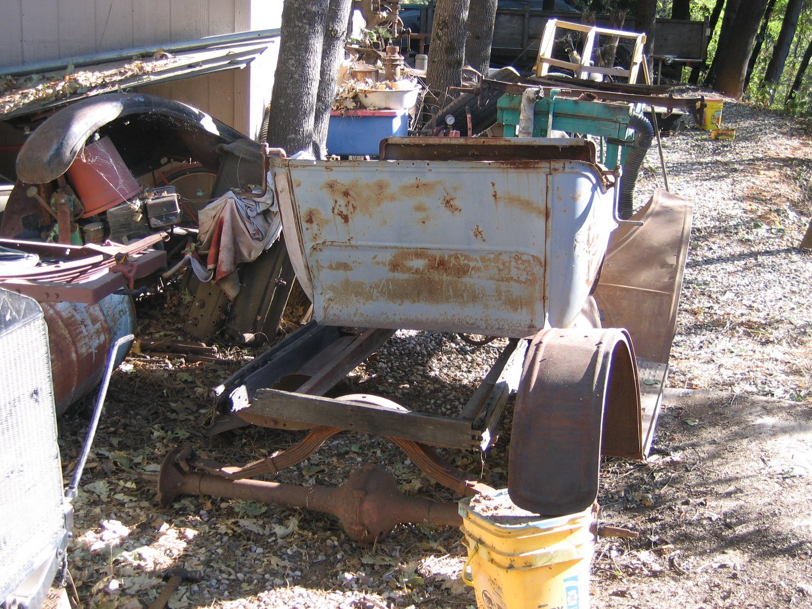

George H, Wow, two beautiful 1914 runabouts! I like how you have two, build dates about six months apart. One representing the early 1914s, the other the late 1914s. Wonderful bookends showcasing a remarkable year of the model T.
As for the rear panel of the body? I don't have any good pictures of my 1915, and don't know for certain it would be the same either? But I can try to post a couple "before" pictures I do have.
First, a bit of backstory. My car is not an intact survivor. The body was separated from its original chassis decades ago, probably because the body was in poor condition and in the early days of the hobby it was common practice to simply replace the original body with a nice later one (somewhere out there is my car's original 1915 chassis with a later body on it?). The body went through a few owners, some doing some work on it, most doing more harm than good.
When my circumstances made me decide to put together a 1915 runabout (a car I have always liked and had fond memories of a few of them), a very good friend offered me this body which he had gotten with a 1914 chassis he wanted. I had been collecting late brass era model T parts for several years and had restored a 1916 center-door sedan some years earlier. So I already had most of the rest of what was needed to put together a fairly right 1915.
That is the background for my 1915. The body, however, still had its original manufacturer's serial number identification plate. It does not have the code for who built the body, although the manufacturer's steel plate does look like the ones used by Beaudette. The original wood was in poor condition, only about half of it was usable for patterns. It was mostly sort of intact, with very rusty original nails nearly rusted away. The rear deck was missing its floor, however the sills were still together enough to provide the original rear inside corner brackets. The cowl panel might have been changed by a past owner (it had been messed with), and the door and turtle deck were missing. The original manufacturer's date coded serial number plate was still nailed (very rusty nails!) onto the sill inside the front door (I kept that piece of wood). The date code indicates the body was an original February 1915 ordered/built body.
Is that rear panel on a February 1915 the same as a 1914? Your guess is as good as mine, but I suspect it likely would be the same in spite of the 1914 differences around the front of the bodies.
I had actually considered altering the front of the body to "create" a 1914 runabout. However, since the date coded manufacturer's serial number plate indicated that it was a real 1915 body, I decided I would rather have an almost real early 1915 than a real fake 1914. But while restoring the body? Doing research I found out that the 1914s used a different door hinge than the 1915 and later open cars. The bolt holes were located slightly differently, and the hinge was located a quarter inch higher on the 1914s than they were in 1915 onward. While restoring my 1915 runabout body, I found it had had the 1914 style hinge location.
Remember that the body had been separated from its original chassis, so it is sitting on a piled up chassis with 1916 fenders propped up as inspiration (?).
After all that? Whether these "before" pictures of my messed up body help you or not? Here they are in all their messed up glory.

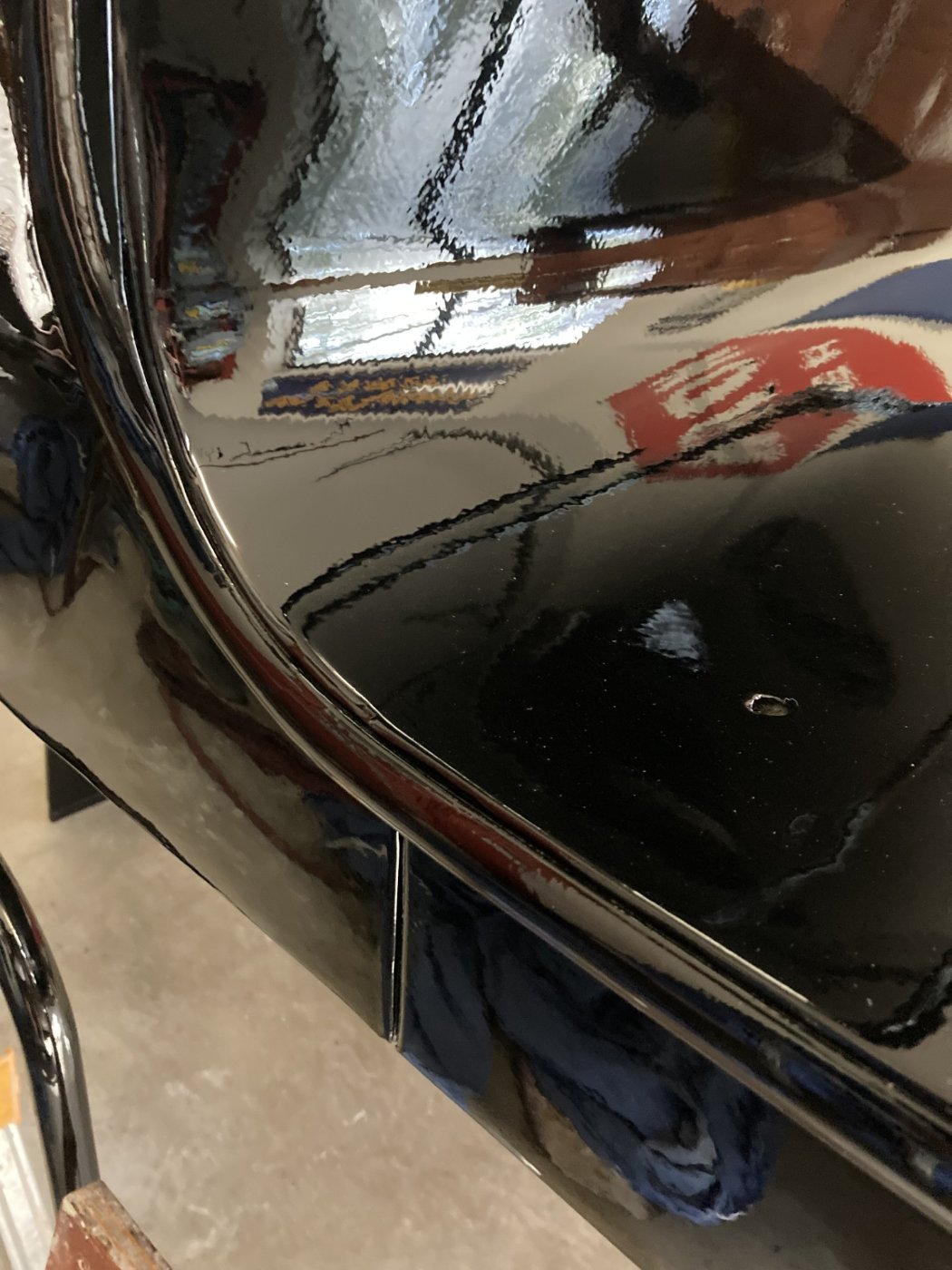

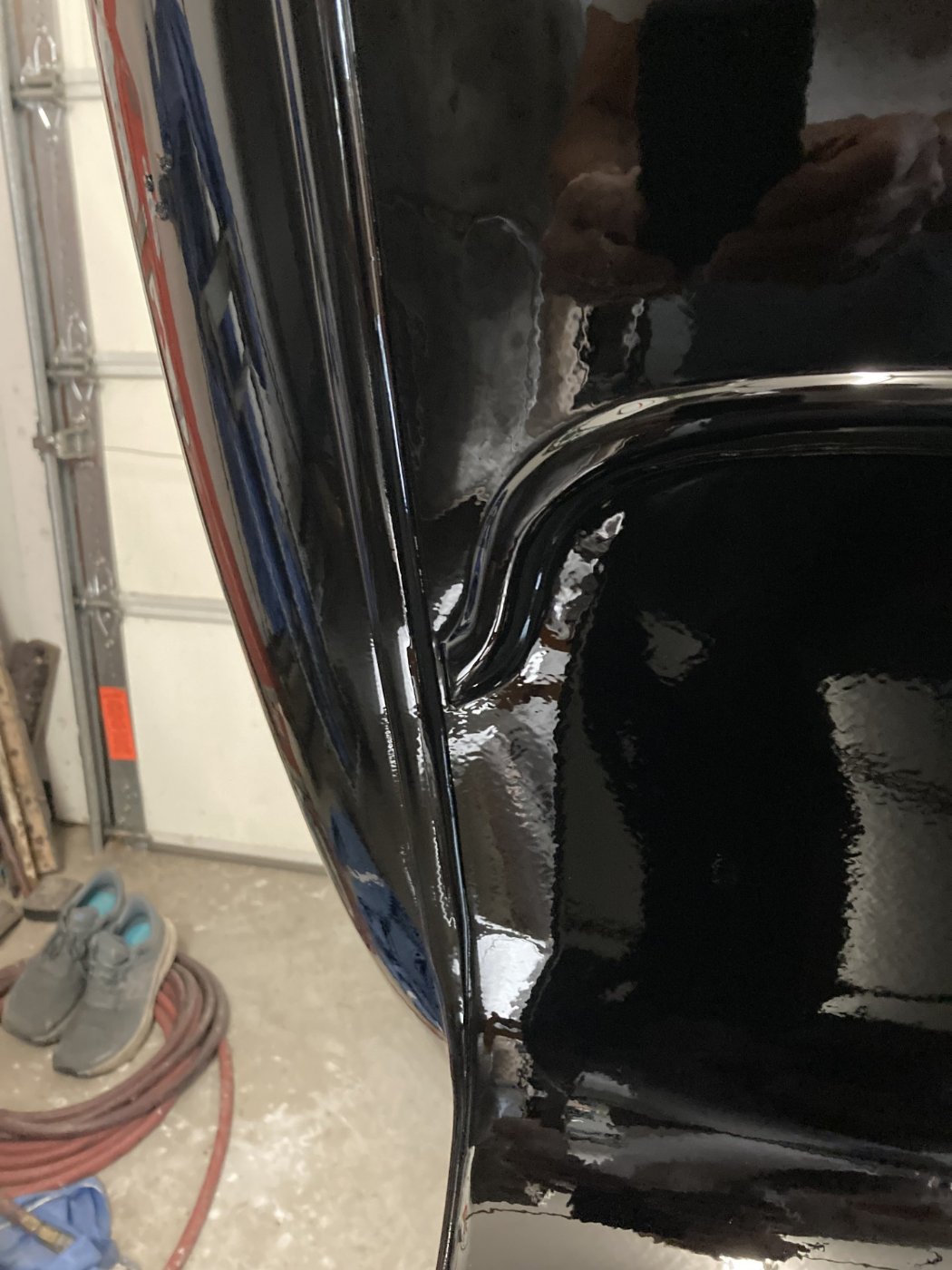

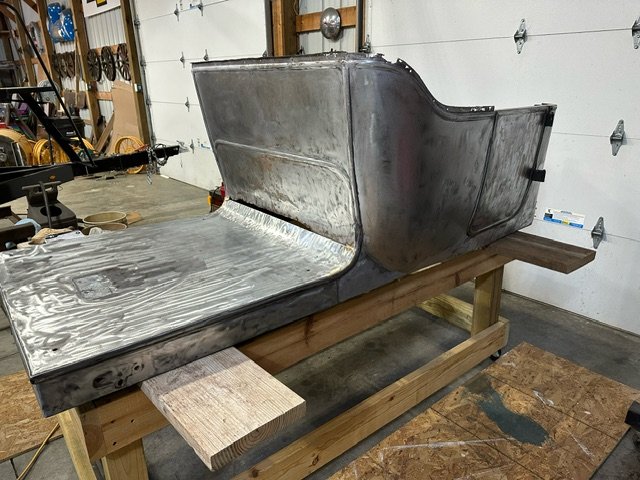

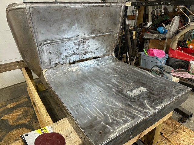

Here is the latest picture of the 14 Runabout body after removing the paint. Art

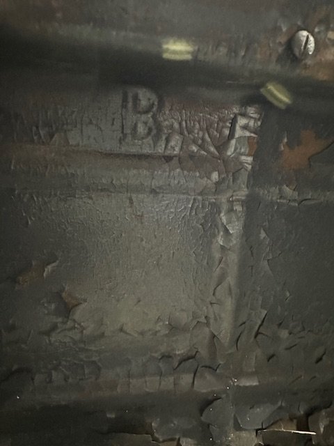

Art, The turtle deck floor looks great. Is there any letter stamped into the kick panel just below the seat cushion? Russ Furstnow

Yes ! You’ve obviously accomplished a lot ! You can cut off the cancerous rustout at the lower back body panel and there exists machines that can correctly curl 20 ga sheetmetal to MIG weld to the original squared off panel. I’m curious of the 2 vertical holes in the very rear ostensibly for the tail lamp bracket ? My 2 (4) bracket holes are on a horizontal plane ? A bit of $35 research I had done at BF Archives revealed the carriage bolts at this location used SQUARE NUTS. FWIW

Russ, There is a B on the seat riser. George, I am glad you noticed the tail light bracket holes. I do not have a bracket and I think the holes should be horizontal like yours. Art
