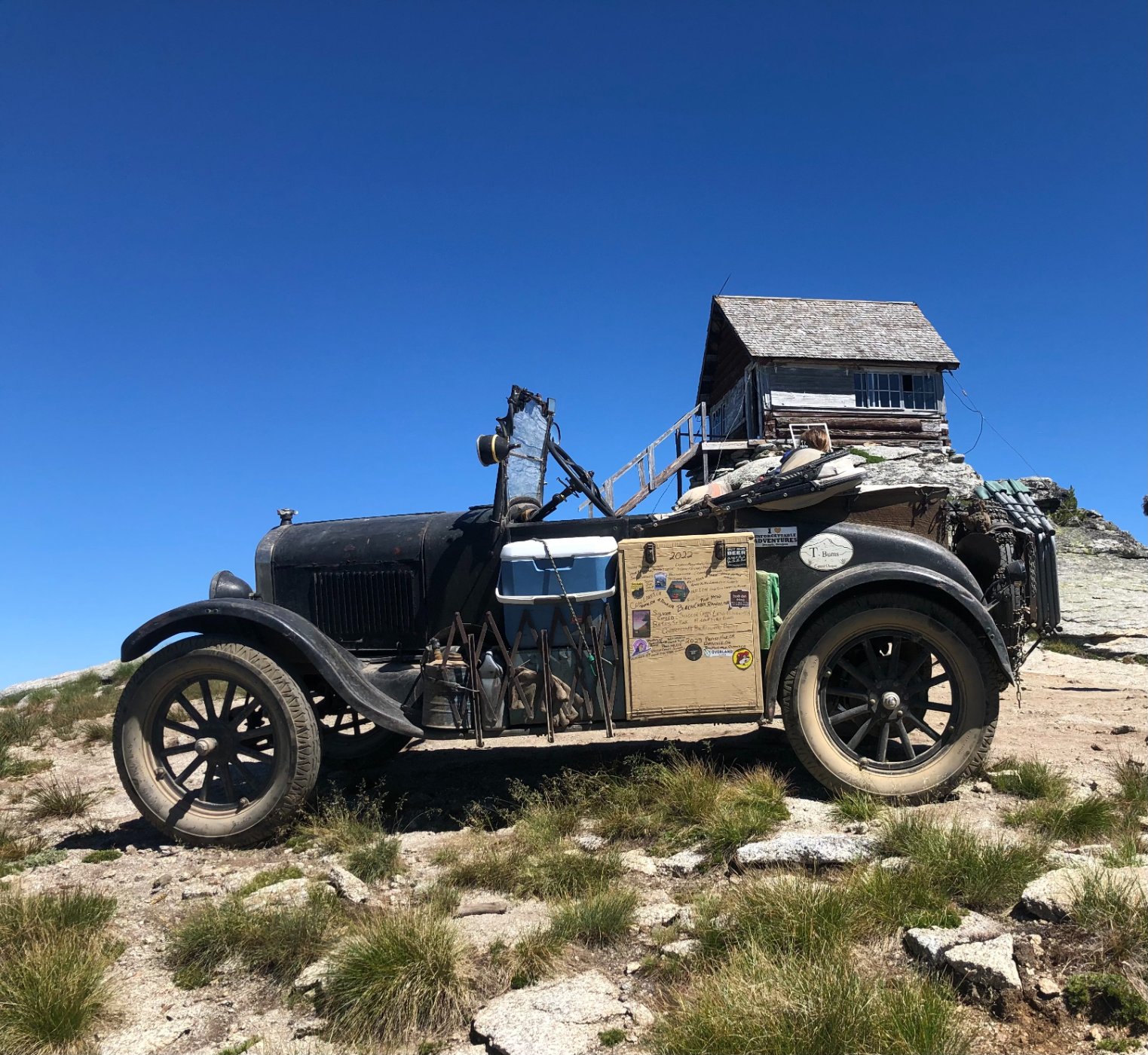

Post by Dennis Prince » Tue Nov 19, 2024 1:34 pm
I have run 5.25 firestone 6 plies for about 20 years with no trouble at all, as a matter of fact I love them. They give you about20 % more tire on the ground for braking, about 3% Hobo Overdrive, unless you are carrying a heavy load they give you a better ride and they last a lot longer ( I get about 30,000 miles out of mine) and I run a lot heavier than most, they also give you a little more ground clearance. I have run them on wood wheels and wires without issue.
