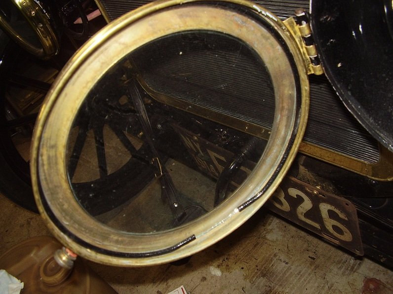

Hello,
I have a 1914 touring car with acetylene headlights. Last week I noticed the glass in one of the headlights tipped back. When I opened the headlight to put the glass back in correctly I noticed the grooved rubber thing around the glass had deteriorated so badly that it was breaking into little pieces. I looked on a couple of the parts suppliers websites and could not find a replacement. It might hold with just the spring metal clip, but I am worried that the glass will break. Does anyone know what it is called and/or where I could get a replacement??

These are great ideas and I understand that I can create my own solution, but I was wondering how it came from the factory. Was there an original rubber piece around the glass from the factory? Or maybe something else?

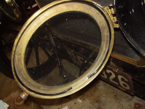

Bryan,
Are you talking about the retaining ring shown in this headlamp rim?
I have John Brown 16s and made mine from brass rod which snaps in
the groove provided in the headlamp rim.

My lights are just like that and I am able to hold the glass in with just the clip, but when I got the car there was a nice rubber piece with a groove for the glass to protect it from breakage. I am just trying to figure out if that was from the factory or if it was something the previous owner did.

I have been running my T for 58 years and the head light glasses have only ever been held in with the metal rod - never a problem.
I don't think there ever was any sort of rubber or other material for the glass.

Re: Acetylene headlight glass
Bryan,
I believe Peter is correct and that's all there was.
If you light with the car running there is considerable
vibration so I have a couple pieces of electrical tape
inside the rim to be sure the retainer does not come out
of the groove and the lens falls. Had the same lens for years.
Just be sure your mirrors are seated on a pad and snugged up.
You don't want them rubbing the silver on the rear of the bucket.

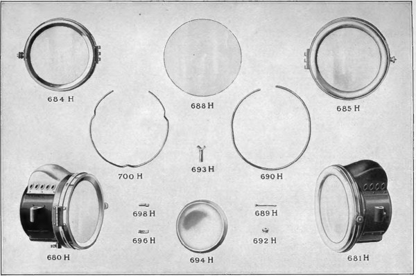

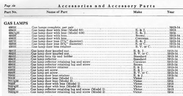

On original non adulterated headlamps I have found a very thin piece of paper like material between the door and glass. On occasion I have found the material between the door & glass plus the glass and spring rod that holds the glass in.
- Posts: 6588
The parts list for accessories shows a wire retainer. Part 690H

- Posts: 1685
- First Name: Dennis
- Last Name: Seth
- Location: Jefferson Ohio
Eric, I did not consider the heat factor and that's a good point about the heat factor when adding a gasket type material or the electrical heat shrink tubing that I mentioned.
- Posts: 6588
The heat shrink is a good idea.
Things to consider.
The glass will hardly expand from the heat.
From the internet
The coefficient in the table for 'Glass, hard' is 3.3 X 10-6 in/(in F). This means that each linear inch of glass will get 0.0000033" larger for each degree Fahrenheit that the temperature increases. If you have 10 inches of glass that get one degree warmer, you can expect it to expand by 0.000033".
500 degrees x 0.000033" = .0165"
From AI Bot
When a steel ring is placed inside a brass cylinder and heated, the brass cylinder will expand more than the steel ring due to brass having a higher coefficient of thermal expansion, meaning the ring will potentially become looser within the cylinder as the temperature increases.
So the "ring", 690H, is open and made of spring steel to allow for expansion

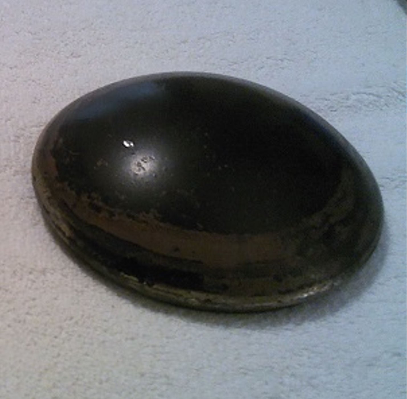

Thank you for the parts list Frank.....
Bryan,
Since good 6" mirrors are so hard to find, you may want to check
what kind of pad is behind your mirrors, or if there is one at all.
The back of the Mangin is silvered and coated with shellac and the
"MANGIN - BAD BACK" picture below is one I took out of a headlamp with
no pad. It rotated in the bucket and rubbed through both the shellac and
silver, all the way to the glass. To be sure that doesn't happen, I cut 2-inch
heat resistant webbing to fit/conform to the curve behind the mirror.
There is very little heat involved in acetylene headlamps, but it doesn't seem to have
trapped water between the mirror and rear of the bucket in the last ten years.
Also, provides a good cushion when snugging up the mirror to the bucket.
Can't seem to post but one picture for some reason, anyone??
Light 'em up!
