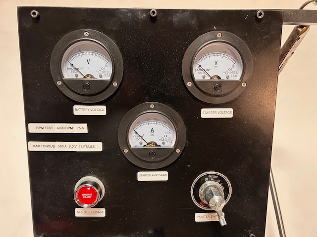

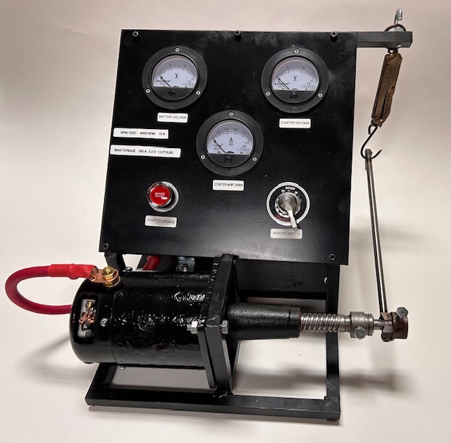

To answer the question of amp draw, I measure it when testing staters. I think the official Ford spec is 530-550A but batteries are a bit stronger these days. I use a Napa commercial 6V battery which has 600 CCA and I have a 1000 A shunt on my bench tester. So common for me to measure 550-580 on max torque test and I typically measure 13-15 ft/lbs of torque. No load spin test is around 70 A, this is a great test to ensure there is no drag on the armature shaft. So if the alignment is off you will see the motor pulling more, so time to find the mis-alignment and correct.
I want to try that 6v Optima Battery, it has 800 CCA.
Remember this is a 6V system, people get used to 12v systems which use less amps and a lot of times will use 12v battery cables on a T which are not rated as high and can either get warm or limit current. So another thing to check if you have an underperforming starter.
I attached a photo on my dedicated T starter bench tester.
Great tool to diagnose and test starters.
I can measure:
Starter Amp draw for both no load spin and max torque
Scale for measure ft/lbs
Volt meter to measure volt drop
Laser tach to measure RPM ( I believe Ford spec is 4000 RPM, no load) I typically measure 3500-5000, crazy they can spin that fast.
So it’s always an advantage to have a pro test, rebuild or diagnosis your starter, I get a lot of “rebuilt starters” that was done by the local shop and don’t really see anything inside that was rebuilt, plus they have no way to test.
Hope that answers your question.

Woody 23... Happy Thanksgiving and thank you again for "Giving to us " what I believe was a repost of your starter testing and pictures. ...... My father , electrician , educated me on sizes of copper wire and it's capability to carry current safely in applications.... Lifelong employee at Hercules Powder Company, explosives manufacturer, safety prevailed. ...... I believe that Dan's picture of adding a cable from the starter mounting back to the battery Negative terminal/ frame mounting was the one that helped me to do the same to 1926 Runabout...... Your information is correct and hopefully an education that will change previous methods and electrical values thought by some..... We do learn something helpful everyday, thanks again for your help.
- Attachments
- Image 11-26-24 at 8.57 PM.jpeg (72.85 KiB) Viewed 3519 times

Hello and Happy Thanksgiving Moxie26!
I hope you and our family had a wonderful holiday.
Yes I did post the photo of my bench tester in the past, I was just answering the question of where the 580 A draw number came from. I see and sure you do as well a lot of slow starters out there so just wanted to touch on the amount of amps it really takes to spin it and the benefit on having it professionally rebuilt by someone that specializes in T starters. Get them done right it will most likely be the last time you last to mess with it.
Happy Holidays!
