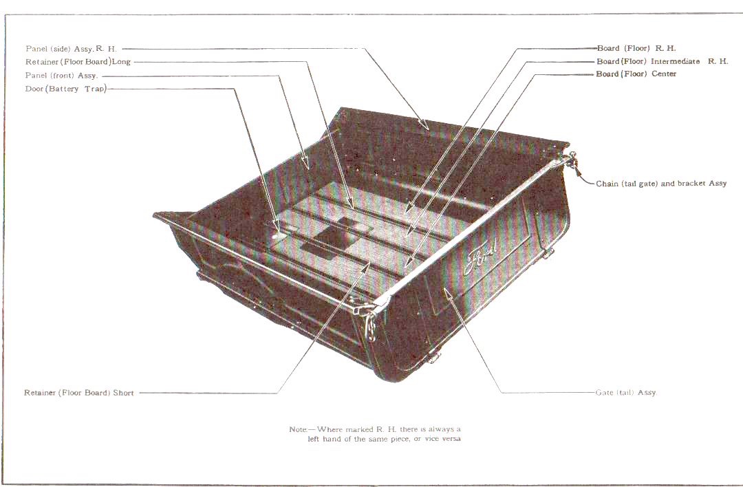

The bed is correct for a 26-27, here is the parts drawing of the T bed.

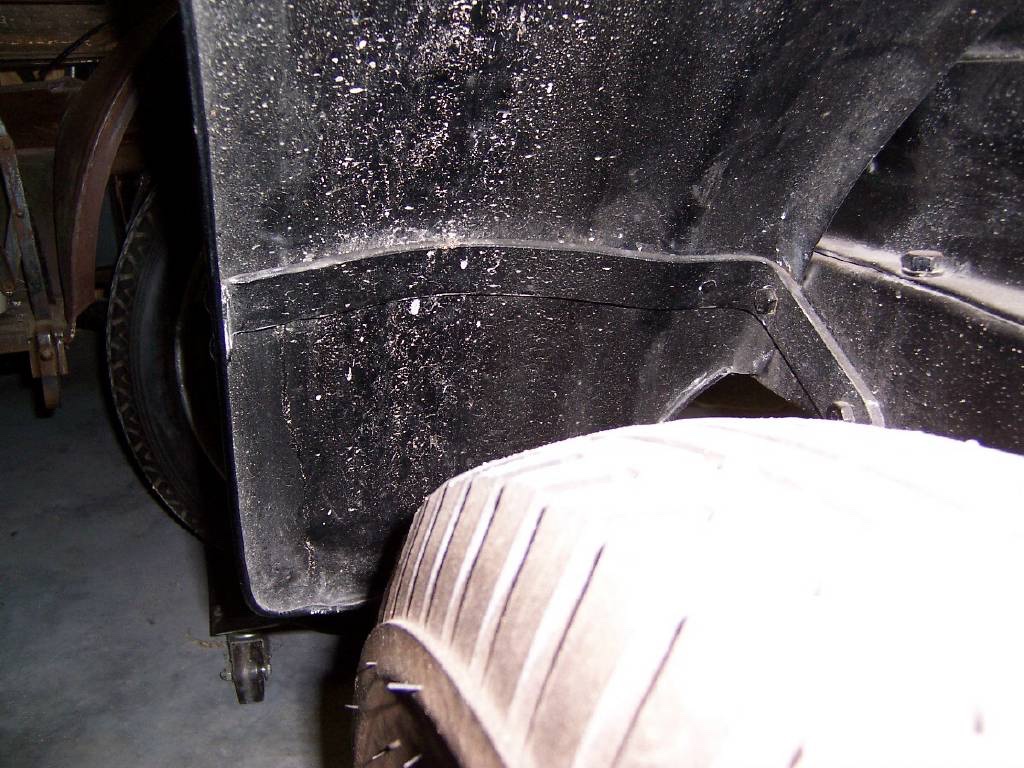

The bed fasteners are hex bolts, with washer under, the length don't recall, but the bolt dia. should fit the hole in the bed flange and into the runabout body subframe. The bolts in photo are original fasteners reused.
