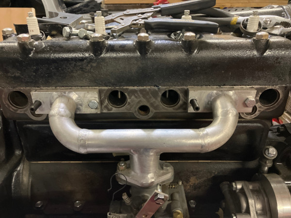

Re: Dual exhaust manifold clip design
A picture of the intake manifold!

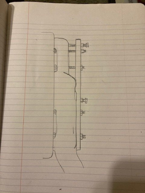

Hi Les,
I had the opposite issue when building my speedster as the exhaust bolted to the engine & the intake clamped. I used grade 8 3/8" fine all
thread long enough to clamp a 3/8' x 3/4" bar across the intake. You can do that but the of the ports on the dual exhaust manifold on 2 & 4
are greater than 1 & 3. I would think a 1/2" x 3/4" bar long enough to cover all 4 ports could be used to clamp the longer ports & set bolts
threaded into the & locked with a nut would give you the ability to adjust the hole on the exhaust manifold. It may not look pretty but if
you take some of those round corners from under the grinder & put on the bar it will improve the appearance. May not clear a early hood? Nice manifold?
Craig.

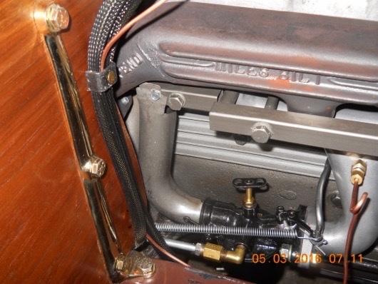

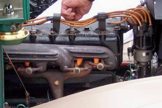

- Posts: 4040
Neat set up, now this photo is off the forum years ago, seems good way to hold that dual exhaust manifold.

Craig and Dan thank you for the input. Certainly some ideas to consider!

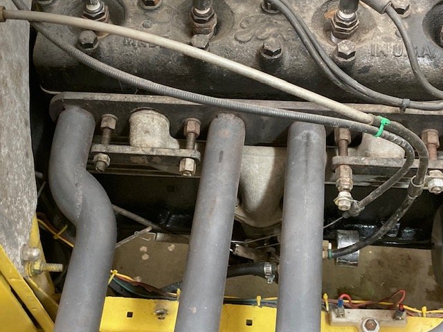

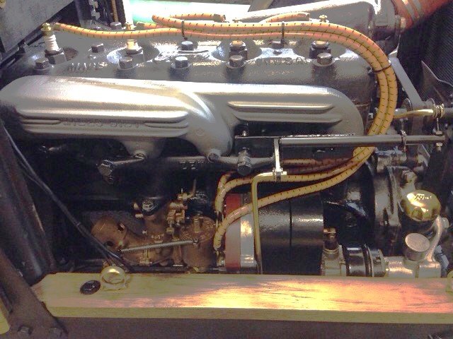

- Posts: 4381
I think I would use stock clamps, but braze on an extension to the end that holds the intake manifold.
- Posts: 6531
Me too. Long threaded studs & using nuts for the low connectionsJerry VanOoteghem wrote: ↑Fri Dec 06, 2024 7:20 pmI think I would use stock clamps, but braze on an extension to the end that holds the intake manifold.
