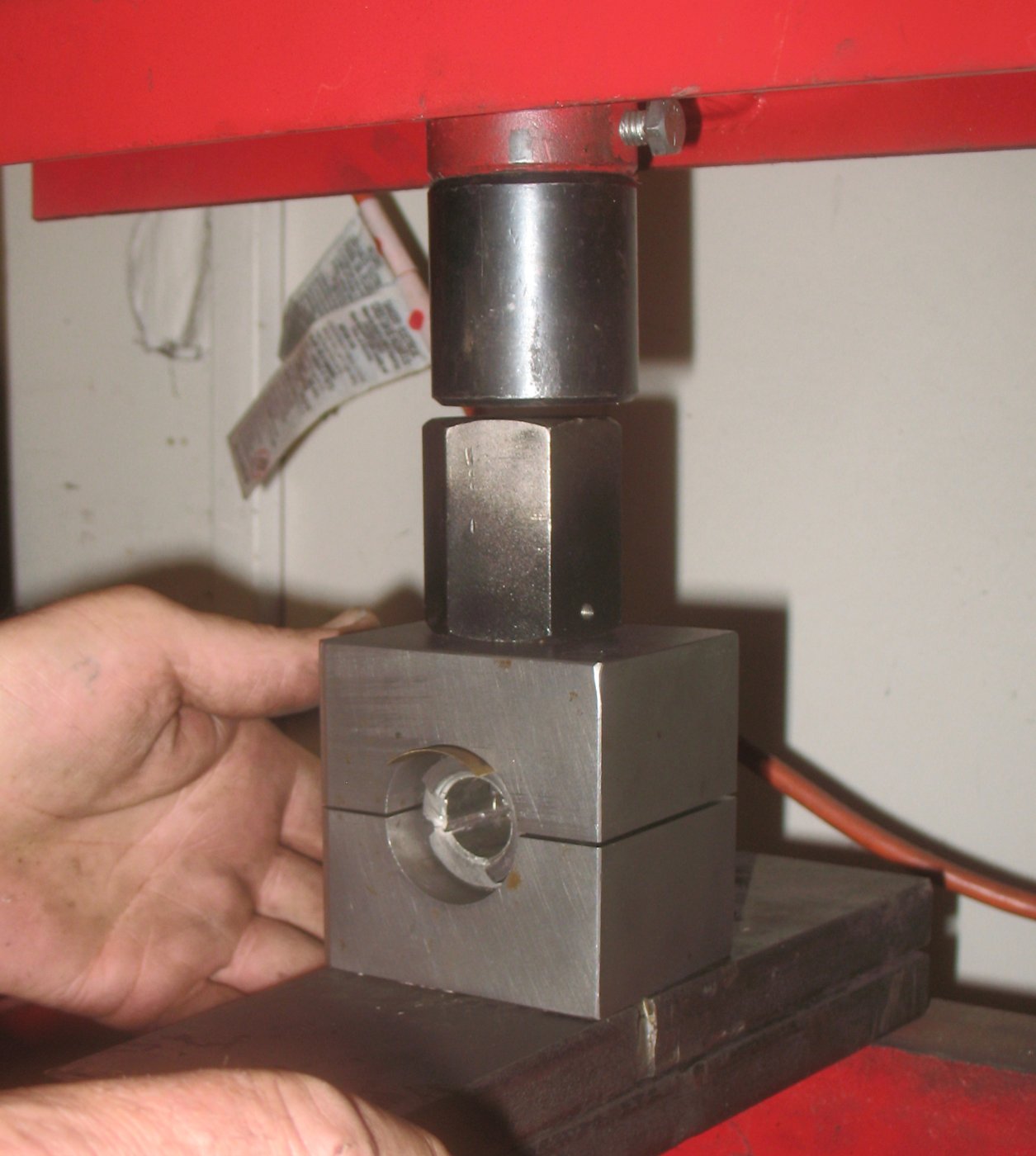

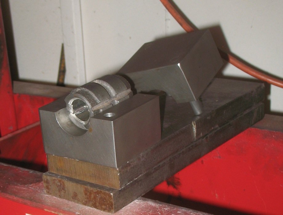

I believe a rebuilder I know made a fixture to squeeze them round in a press.

The issue isn't bearing to cam fit it's bearing to block. I have seen the die and press pictures to make round again but have no access to anything like that.

KenHaverhill wrote:
Sat Dec 14, 2024 9:59 am
A lite squeeze in a press will do it. A vice might work if no press.
Measure the od to confirm where & how much squeeze is needed.

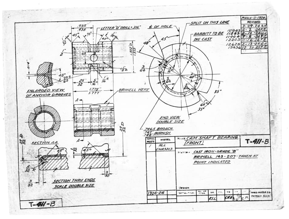

Anyone know the proper OD diameter of a cam bearing? Is the pictured jig exactly the size of the diameter or a few thousands smaller?
Thanks.

Someone was asking about cam bearing dimensions. This drawing is from The Henry Ford’s website.

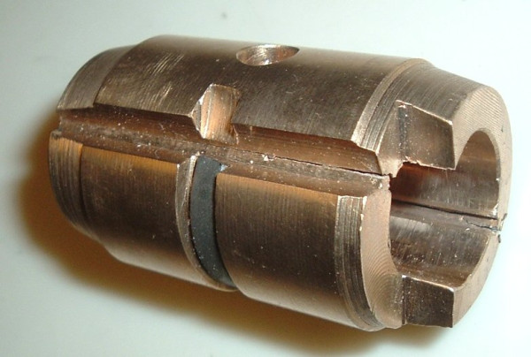

Here is one made from bronze
