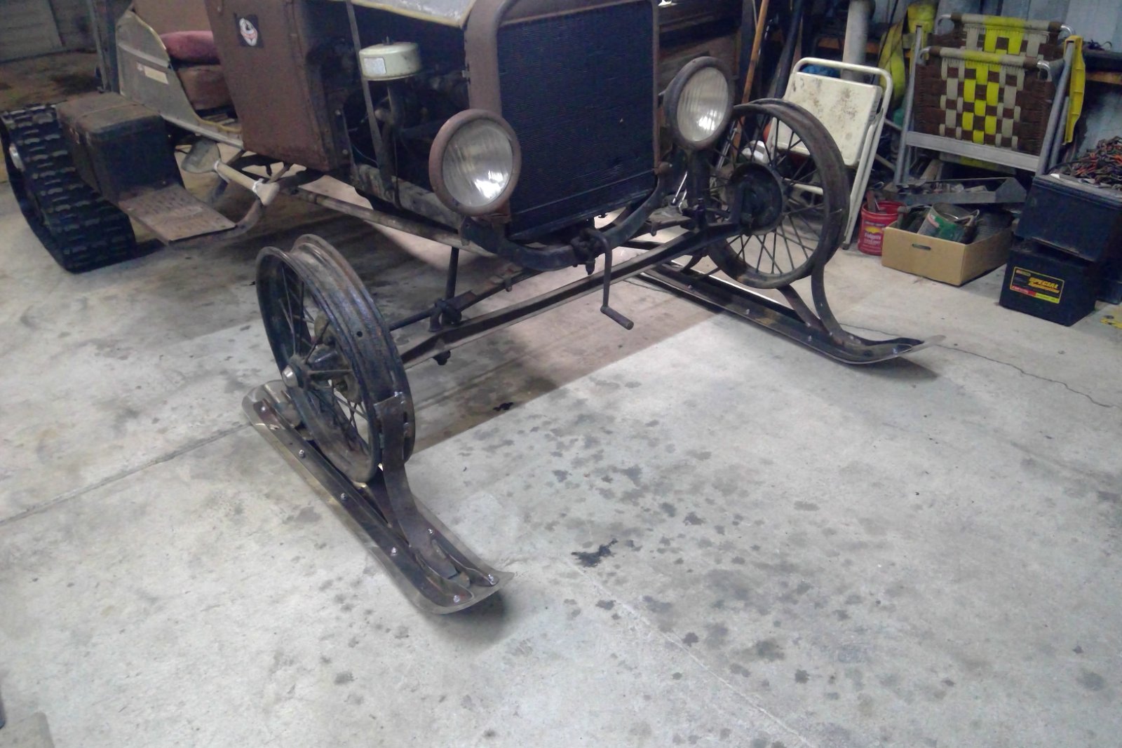

I finally got my skis finished. They are made out of things out of my raw materials pile (formerly known as a scrap pile) I used wheels that were no good for tires, some broken Model A springs, old bed frames, chain links off a potato digger and what was part of the kitchen remodel at the Elk's Lodge 25 years ago. The skeg on the under side I made 14 inches long and now all I need is snow to test them out. As you can see from the pictures it is not a traditional T snowmobile, my nephew had these tracks for his side by side and doesn't like them so a friend and I put 2 tracks a piece on our T's. We will see how well they work. The only time in my life that I have ever wanted it to snow.

Dennis that turned out really nice. Take some shots out in the snow. Model T’s are light but I wonder about boyancy on top of the snow. This is the 30’s version by ARPS.

Dennis, I'm preparing to make a wood rim for my steeringwheel. I never considered making one like yours. I like it, but I think that I'll stay with the factory shape. :D

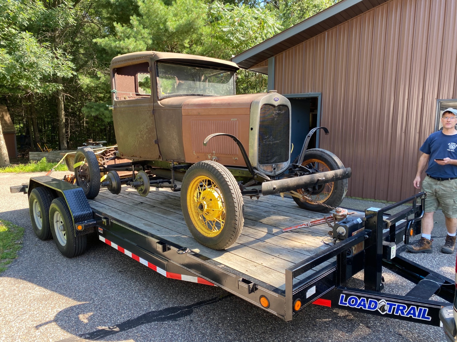

This is how my Supersnowbird started out. The cab metal is pitted more on the inside than outside. The Model A frame was cut, bent and welded to make it straight for some reason and it came with the 25 T pickup box. The frame cross members are now oak and fiberglassed. That is the reason it has the 25T box.

Joe, You did a really nice job on your Supersnowbird. With it having no rear fenders I thing that the 25 bed looks better than a Model A bed would, looks like a fun vehicle. Do you have to get in and out of the window with that track setup? I am just waiting for snow, all of my snow is coming pre melted.

Post by Joe Reid » Sun Dec 29, 2024 12:56 pm
The doors are cut and remanufactured to open over the tracks. Still not too easy to get in.
