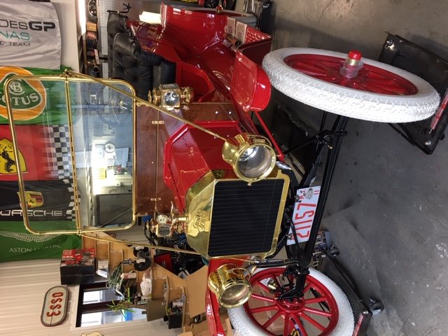

Here the beast ! After 8 years of restoration.

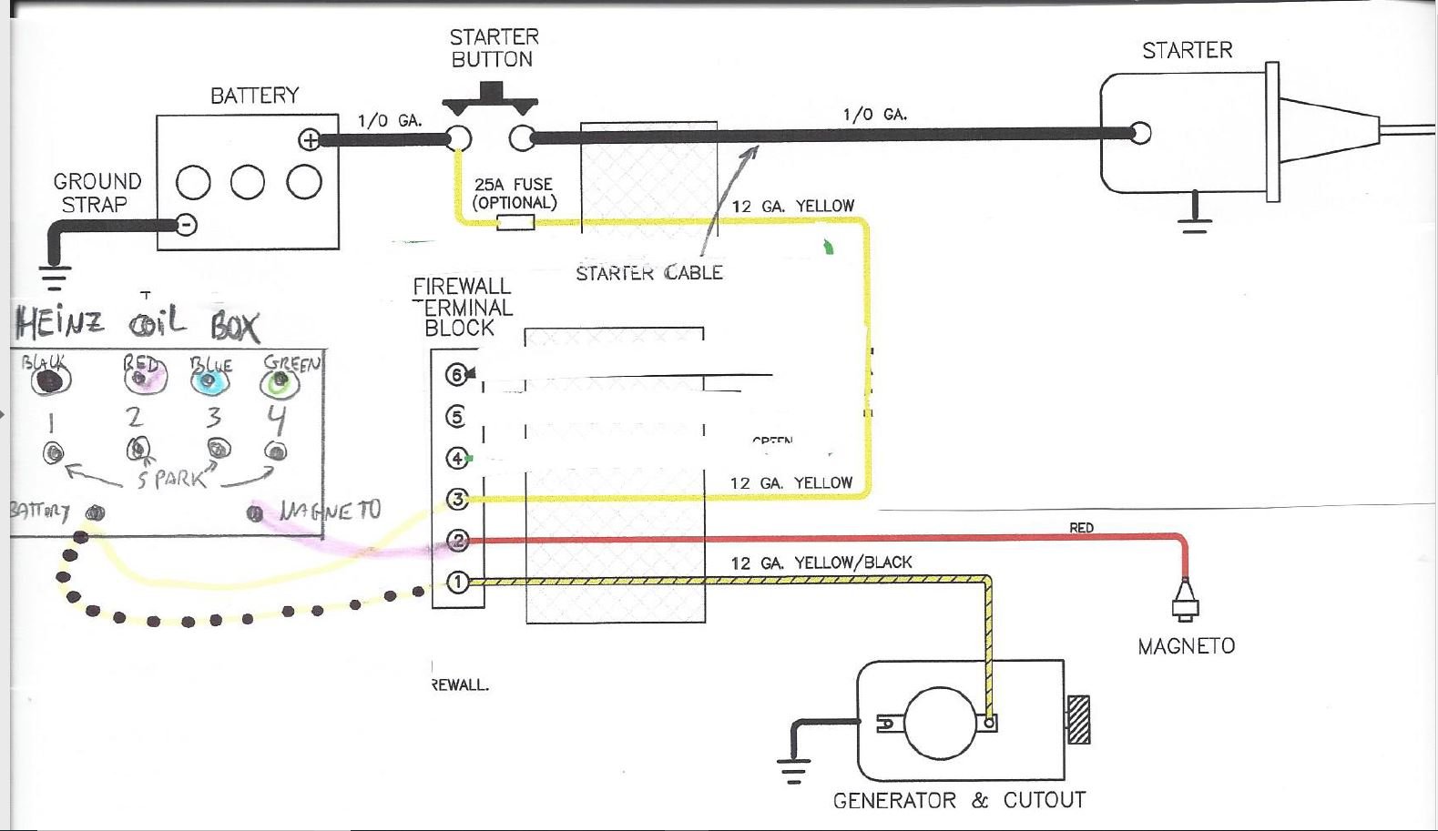

So if I understand I put together the yellow wire and the yellow & black on the battery post on my Heinz coil box?
see bellow my home made diagram.

Re: Wiring diagram need it for a special set up.
It that configuration, the battery will be connected to the generator full time.
This will work but, this relies solely on the cutout to protect the generator and battery when the motor is not running.

Even the Model T's which came with the generator and battery depend on the cutoff to isolate the battery from the generator when not running. The switch only disconnects the battery from the ignition coils. You are damned if you do or if you do not use a fuse! If the fuse is between the ammeter and the battery, if it blows when the engine is running and the lights are on, you will burn out all the lights. If , if it blows you will still be depending on the cutout because if that fuse goes out, the generator will destroy itself. It is best to have an ammeter in the circuit. Look at it when you turn off the engine. If it shows discharge, you have a problem which should be tended to immediately. Anyway, you should have the cutoff connected to the battery and the generator so the juice goes through the cutout whenever the engine is running, and the cutoff disconnects whenever the engine is off.
