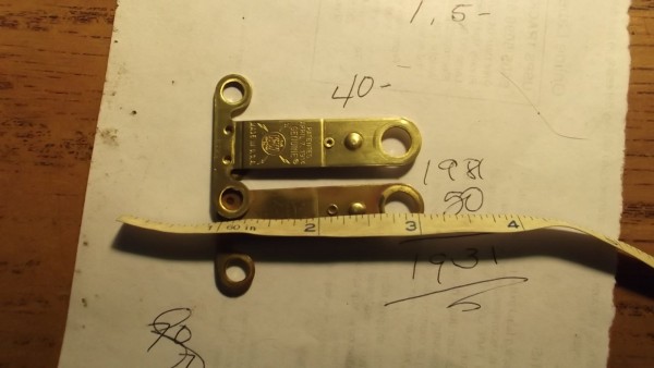

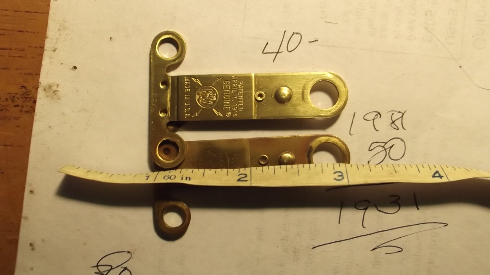

Ok so new wisdom is .010 to .012 cushion spring gap, but the new points are like .017. The old KW point, the upset behind the rivet is about 1/8"+ to center of the rivet, the new ones, it touches the rolled over edge of the limiting rivet and is about 1/6" to rivet center. Our club has a set of the setting pliers but don't think they will work on these. I made a cupped tool to put in the vice, but it not an easy job to hold the points, punch and hammer at the same time! LOL
Someone in the past suggested cutting a slot in a .010 feeler gauge to use as a stop that would be put between the cushion spring and bridge. I do have a nice piece of flat stock to work on and think that might be a good way to go.
Question; When setting the point gap, is the gap measured with the cushion spring against the bridge or hanging down? Do not recall ever reading or seeing anything about this. If hanging down, I am in big do-do as there are no thread left on some of the studs and some of the lock nuts are proud of the stud and to get the .030-,031 gap, will have to address the cushion rivets.
With the cushion as is, I end up with about a .013 gap when the points are open. I have all 8 coils set to approx 1.3 amperes with no double sparks on the HCCT. But....will if I have too, just hate to mess up new points.

First try with the shim stock and slot, no movement.

I have several sets of NOS Ford points, and the gap on them isn't anything as much as what is being made today.

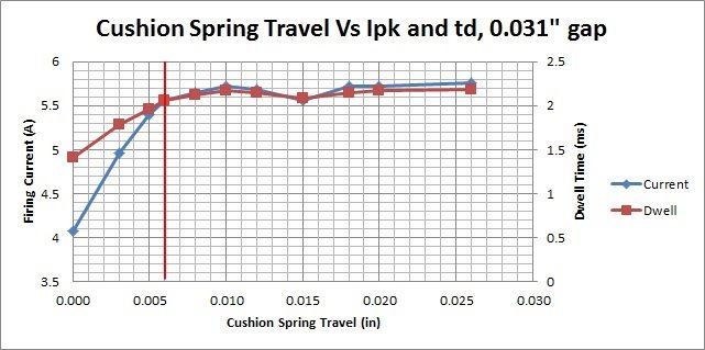

Where the heck did this "new wisdom" come from? The Ford specification is 0.005" which agrees very well with the measured test data I took using a set of points with adjustable cushion spring travel.
Note that there is no significant change in coil firing time or firing current of THE First Spark once the cushion spring travel reaches 0.006" That means the point contacts have opened after 0.006" travel even if there is more available travel before the cushion spring hits the limit rivet stop. In other words, the vibrator spring contact separates from the cushion spring contact (Contact OPEN) all by itself after 0.006" of cushion spring travel without the help or benefit of the limit rivet stop. This is a critical detail many do not understand the consequence. Coil points with excess cushion spring travel (More than the 0.005" Ford recommended) The point contacts separate without the help or benefit of the limit rivet stop often do so relatively slowly, negating the purpose of the capacitor (condenser) promoting the formation of an arc. Coil point arcing is undesirable for several reasons.

Ford knew what he was doing by specifying cushion spring travel of 0.005". The primary coil current is already of sufficient amplitude to guarantee a good hot spark with sufficient energy to insure combustion after 0.005" travel of coil point contacts closed. Both point contacts are traveling with considerable momentum after 0.005" cushion spring travel. The cushion spring contact stops abruptly when the cushion spring hits the limit rivet permitting the vibrator spring contact to continue moving, away from the cushion spring contact VERY Quickly. The capacitor (condenser) permits primary coil current to continue flowing for a short period of time (millionths of a second) but that is long enough for the point contacts to move physically apart from one another with the cushion spring contact abruptly stopped by the limit rivet. Abrupt physical separation afforded by the limit rivet and brief continuation of primary coil current by the 0.47uF capacitor is key to preventing electrons from jumping the point gap and forming an arc. This also hastens the collapse of the magnetic field once the primary coil current ceases to flow through the capacitor. This results in a higher secondary voltage to be produced creating conditions necessary for the spark plug to generate spark.

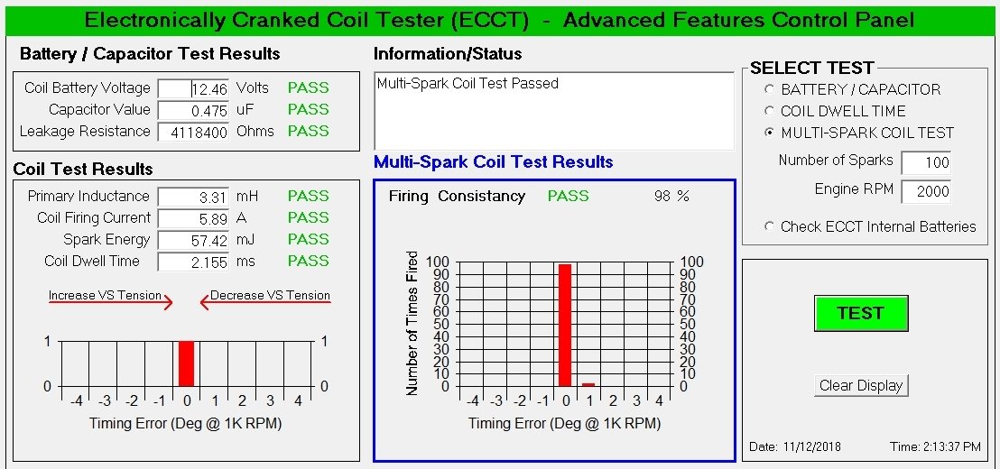

Better than 90% refers to the firing consistency. For example, if the coil is fired 100 times in rapid succession and the dwell time remains constant for at least 90 of those firings.
This coil has 98% firing consistency when tested at an equivalent engine speed of 2000rpm.
