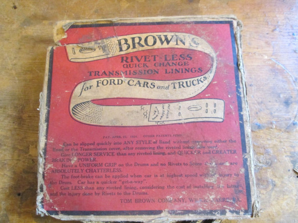

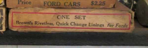

OK, so in the aftermarket world of the Model T, with hundreds of vendors believing they could create something "new and improved", or, even wholly unique...my brain is scratched raw trying to figure out the possible engineering principle that could enable a tranny band to be "rivetless"!!!! What possible form of attachment could have been employed???
Just one of the kazillion Model T mysteries for sure....
Anyone ever hear of Brown's rivetless linings????
Hopefully an answer awaits...

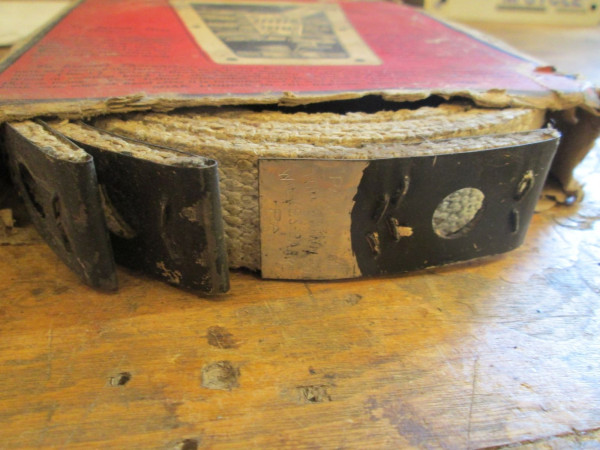

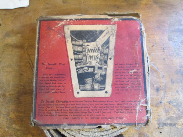

Kurt - I opened the box - they have a tin plate on both ends with a hole that the spring rides in - simply wrap the lining around the drum, insert pedal shaft & spring through the tin plate ???????????????????????????????????????? They do explain about shortening the low band adjuster and replacing it with a special washer ?????????????????????????????????

Many thanks to Steve (RajoRacer) for sending me pics of an actual box, instructions, and bands of Brown's Rivetless bands. With so many aftermarket redesigned parts that came & went & lost to time, it's always amazing what still exists out there.... thanks Steve for taking the time to document these.

Just imagine that brake lining wearing down thin, you do a panic stop and it snaps. Oh boy.

Really no difference from burning out the lining in the stock band. No lining, no nuttin’. :lol: The seasoned T driver knows that if the brake band fails, stomping low and reverse at the same time will clamp up the driveline (not recommended). Panic stop ??? T’s were built for roads that wouldn’t allow for speeds much over 30. Then there’s the rubber to the road surface of less than one square foot. Go ahead and lock up your rear wheels. Now what ? :lol:

You can tell when brakes are failing. Losing the band at once is another matter.
Yes, stomping them all is a cure,

No adhesives on the "rivetless" linings above - the connections for the shafts were riveted.
