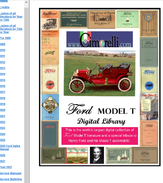

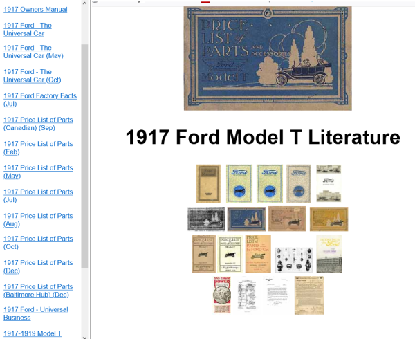

Post by Jones in Aiken SC » Mon Jan 06, 2025 4:37 pm
tdump
Posts: 1407
First Name: Mack
Last Name: Cole
Location: North Carolina
Re: I just bought my first model t and would like some insight
Post by tdump » Mon Jan 06, 2025 5:45 pm
Or download service manual here.
https://cimorelli.com/mtdl/servicemanual/default.htm
Thanks, i just put those on a flash drive to keep in the shop. I inherited a 65 inch tv- monitor and i can pull up the diagrams and such up nice and easy to read on that screen!

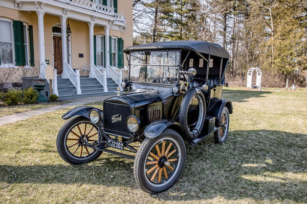

Lucas,
Welcome to the hobby. Hopefully you'll have many years of enjoyment from it. Be sure to take advantage of the opportunity to tour and socialize with other members of the community. Age is not a factor -- your interest in T's is your ticket in.
I too own a 1917 Model T Touring. I added a starter and a few other things and have thoroughly enjoyed the adventures and knowledge gained that I have experienced. I've also met some of the finest people in my lifetime, which is considerably longer than yours :-).
If you email me I have something to send you that you may find of great use in deciding what is correct for your car. That said, the car doesn't have to be "correct" to be enjoyed. Post some photos and let us know the serial number of the engine and we can provide you with some more info. Do not hesitate to ask questions. Folks here are glad to share knowledge (and opinions) which you can sort through and decide what best fits your situation. I definitely support the suggestion that you find a chapter and get to know some of the members....it'll make the whole process easier.
Best of luck!
TIM
PHOTO-My 1917 Model T Touring

Lucas,
Best of luck!
TIM
I was meaning to get some photos, but I've had it covered after moving it in to the safety of my fence rather than outside, I ran it then covered it again, Wednesday when I get time to change coolant and oil I'll get some photos. Thanks I'll need the luck.

There are many FREE original manuals available for download at this site by year & topic https://www.cimorelli.com/mtdl/default.htm
https://www.cimorelli.com/mtdl/1917/default.htm
Other valuable;e references
Descriptions Model/Year https://www.mtfca.com/encyclopedia/
Exploded Diagrams app.php/gallery/album/5
Repair instructions+ https://modeltfordfix.com/
