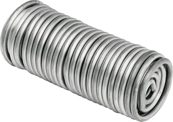

This might a good alternative for a lead gasket for the sediment bulb. I didn’t know solid lead wire is sold as fishing line! Amazon has it in a roll of 3/16”. Wrap it around the screw n connection, overlap a little. Tighten it up and cut off the overhang.
- Posts: 7304
Re: Sediment Bowl Lead Gasket
John, I think that lead is used to add weight around lines without altering whatever bottom in in use. The same stuff can be used to wrap around the spokes when balancing wire wheels.
