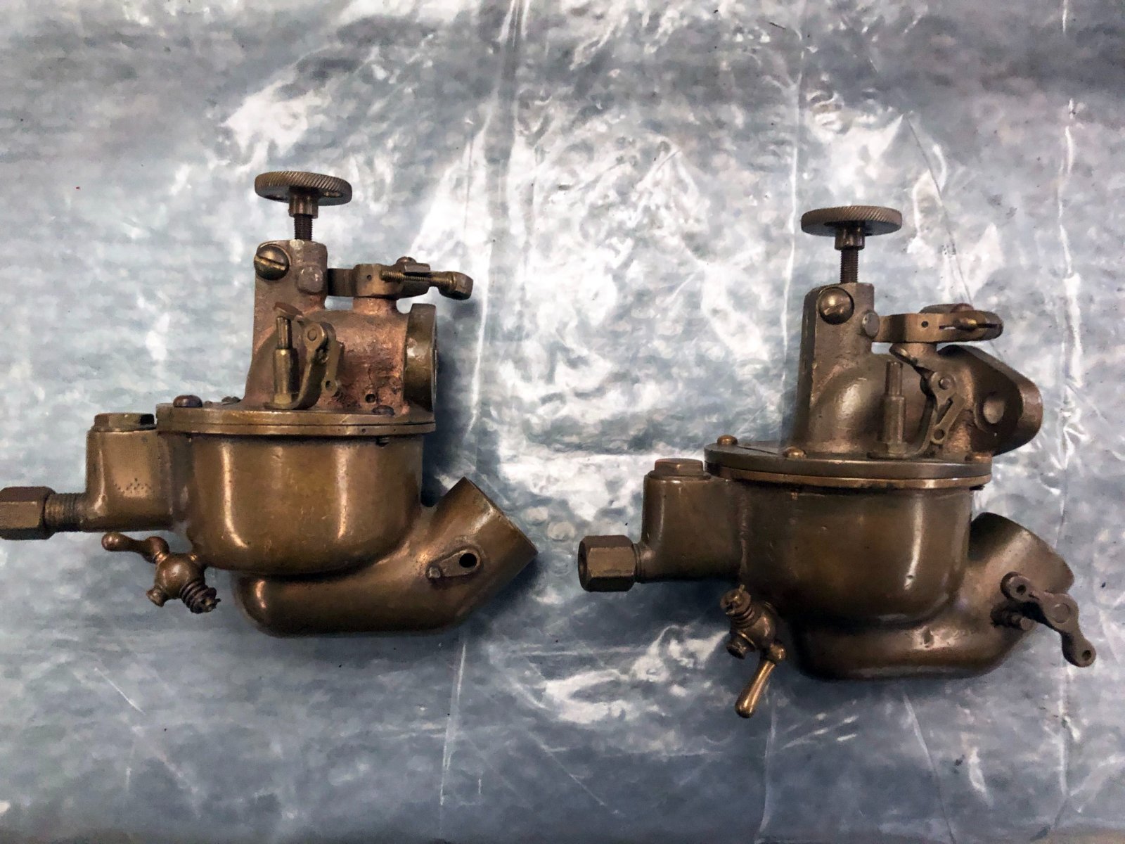

Can anyone tell me definitively if the 1911-12 Kingston 6 Ball carb used a stove/hot air pipe? I can't seem to find much of any information about these carbs.
I am told they are rare. I have two of them that have been rebuilt with new floats, etc.

Thanks, Richard. On the Kingston 6 ball, the inlet does not have clamp like some carbs, just an open throat. Seems like it would need an adapter at that end. That is one of the things I am trying to figure out what was used originally. I will probably just have to fabricate something that works and holds the pipe securely at both ends.
What I can't find out definitively is whether it used a stove at all. However, I believe every other carb for the Model T used a stove so don't know why this Kingston 6 Ball would be any different.

Thanks, Dan, that answers the question as to whether it used a stove. Now I need to figure out how to make one up. The carb inlet throat is 1 and 3/8". Langs sells a pipe with 1 and 1/8" diameter. I will probably need to fabricate something. I have a casting that clamps to the exhaust manifold like other carbs, but I need to fit the pipe to the exhaust manifold casting (should be relatively easy) but need to figure out how to secure the pipe to the inlet on the carb since there is no counterbore or clamping nut in the carb inlet. Seems like it needs an adapter that is counterbored to fit over the carb inlet that is counterbored for the appropriate sized pipe.
I wish that illustration was clearer so I could see how it fits to the carb inlet.
