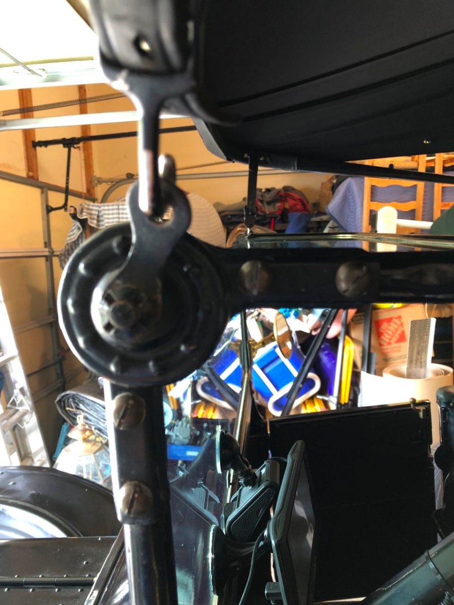

This is the right side hinge. Notice how the arms are tangent to the outside diameter of the hinge.

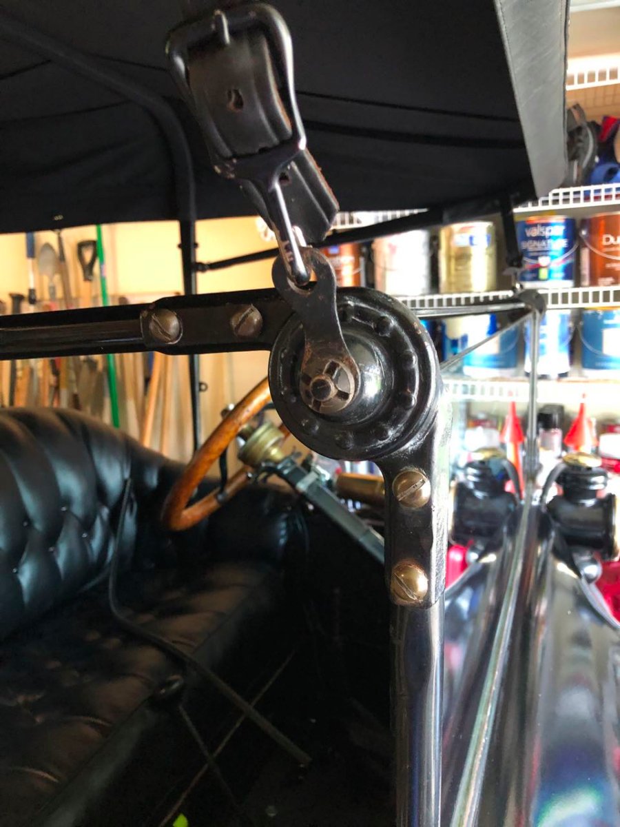

This is the left side hinge. Notice that the arms are NOT tangent to the outside diameter of the hinge.
Pay no attention to the junk in my garage.
I am not sure which is correct. This is a car built up out of parts. I don't really care if it is exactly 1915 hinges. They could have been changed during the year anyway. The top and bottom windscreens are the same width so there is no offset side to side in the hinges. Also the windscreens stack on top of each other so there is no offset fore and aft.
I would very much like to buy a new left or a new right hinge to match the other side. Please let me know if you have one that you are willing to sell.

Someone mixed the pieces up! As you point out, both sides line up (both sides are wrong!) from the lower to upper frames. They MUST NOT line up! The upper frame NEEDS to be forward of the lower frame by a bit over a quarter inch. They are supposed to line up sideways, but not from the front to back of the car. There are four different main hinge pieces. They correctly assemble ONLY ONE WAY! One piece is the right upper, only. One piece is the left upper only. another the right lower, only, the last the left lower, only. Yours appear to be assembled with both uppers on one side, and both lowers on the other side.
I can't tell for sure from the photos, but it looks like you have the proper '15ish parts. Probably, a simple take apart and assemble in the right positions is all you need. As far as the hinges go. You may need to have new glass cut to make it right because the glass edges are supposed to overlap slightly to allow rain to run down the front of the upper glass onto the front of the lower glass. It is likely the glass was cut short so that the frame could be raised straight up with the glass lined up instead of upper forward of the lower. (A common incorrect correction to an incorrect assembly!)
If I have everything rotated correctly in my head? It appears your right hinge is both upper pieces, while your left hinge is both lower pieces.
I recently restored the hinges for my '15 runabout project. I started with a couple original hinges in terrible condition, loose, not assembled on any frame, and had to sort it all out as well as repair some badly damaged pieces. Believe me, there is only ONE right way for those to be assembled.
What I can't tell for certain from your photos, is that you could have one '14 style hinge. If so, it would be your right hinge. However, looking at the detent dimples, they do NOT look like the '14 hinges I have. That, and given that you appear to have all the proper offsets (just in the wrong places), I would speculate that someone in the past had it all apart, and put it together incorrectly. The assembly is somewhat counter-intuitive. A lot of people seem to need to assemble the pieces wrong.
Good luck! I think you have the hinges you need.

So, as Wayne said, it turned out that I had all the right parts, just in the wrong places. Thank you Wayne. Chalk this up to "learn something new every day" or maybe learn something new constantly. There was no grease in the hinges and no cotter keys. Now, with grease, the hinge folds nicely, without the nuts coming loose.
As near as I can figure out, the car was assembled just after World War II and I don't think the internet was working at that time so the person or persons who assembled it did not have the advantage of assistance from the MTFCA Forum. They did a lot of other things wrong too that I have been correcting over the years. Still more to go.
Neil
