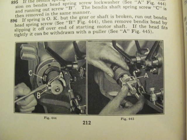

Re: Trying to remove bendix spring holder
Ford Service, showing a puller being used on that starter drive head.
Puller being used, with starter in the car, access from below. After removal check for burrs or damage that may have made the drive head stuck or difficult to remove.

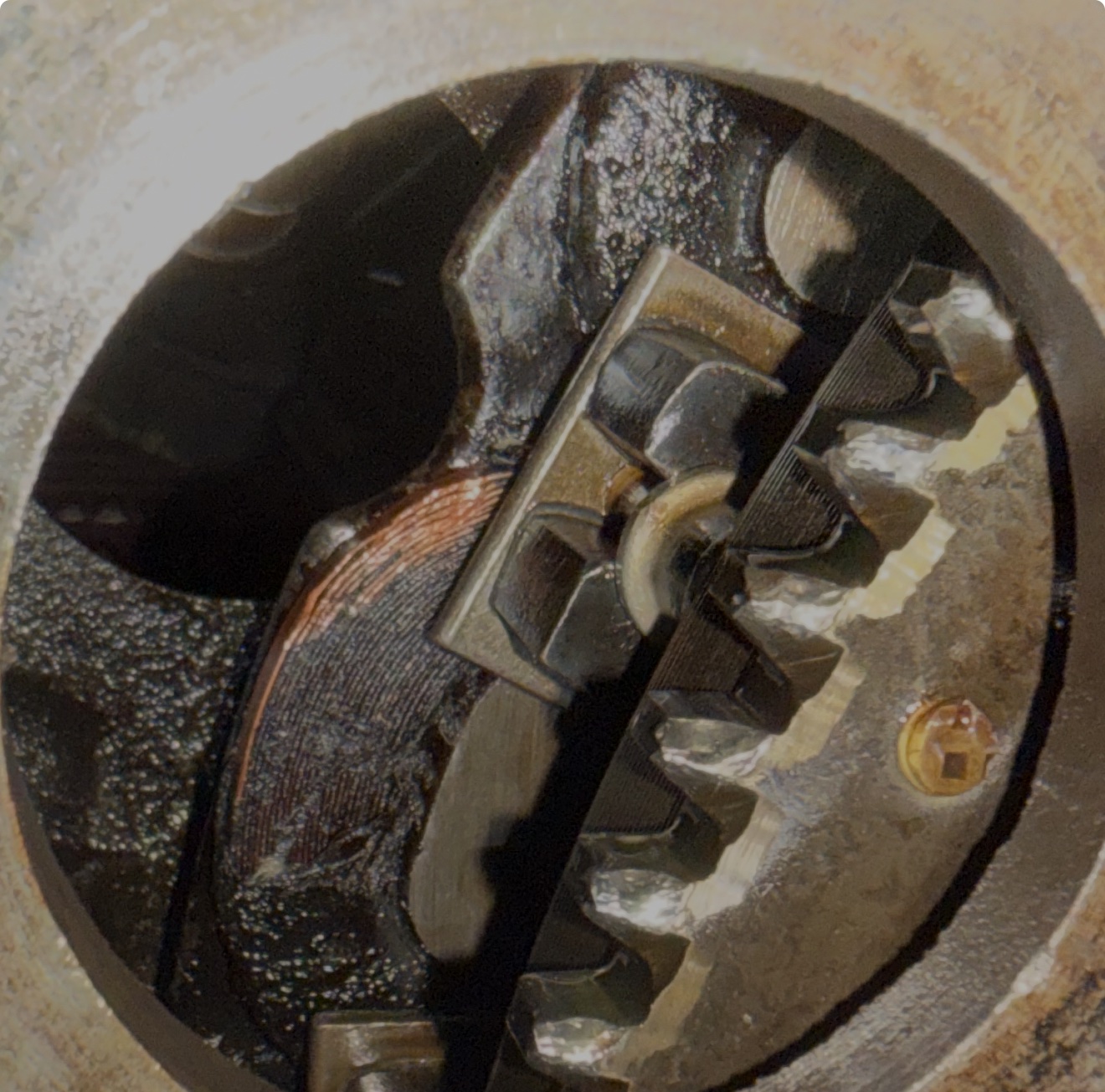

Got it off and things seem well….EXCEPT…
Is there a way to test the windings in the magneto?
Should this be all black or all copper?
Does it look bad to you guys?
[image][/image]
[image][/image]

Well, good news is I found an article abnout testing the magneto. The not states the best is to have under 1 ohm of resistance. The higher the number (above 1ohm) the worse the situation....mine tests between .25 and .3 (YIPEE)...
Now, should I clean that black or just count my blessings and put things back together?

The "black" , if I understand you correctly, is just discoloration from oil and carbon. So that is not a problem.
However, the insulation on the mag coil winding shown in your picture has come off. I don't think that has an effect so I would not tear down the engine to put a new rebuilt mag coil ring in. If I am wrong about that, others will chime in. However, if you do some day tear the engine down you should get yourself a rebuilt mag coil ring.

Matt,
The mag ring insulation probably got damaged by someone being rough while removing or installing the starter. Do not touch the mag ring, leave it alone and it should be fine as is. I have worse in my car and it runs just fine on mag.
- Posts: 4695
