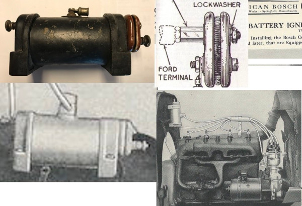

- Posts: 6337

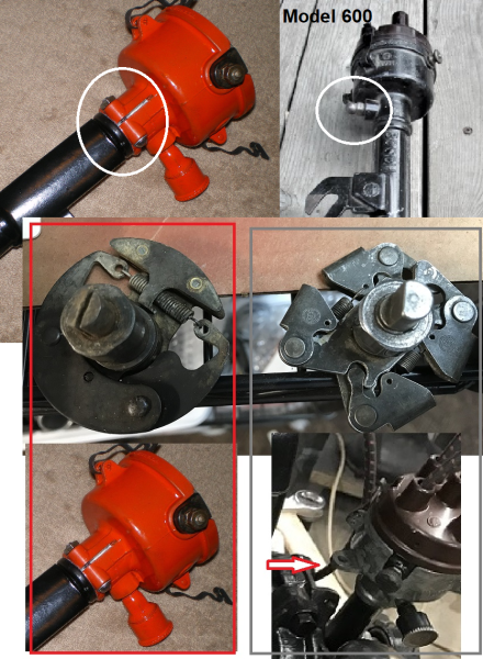

Re: American Bosch distributors with centrifugal advance
last page................
There were 3 different clip on models that I am aware of -
The one on the right I believe was the early version
this was the most rare 600 D a later version

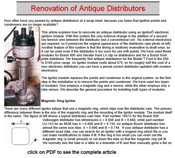

- Posts: 77
- Joined: Sat Feb 29, 2020 1:26 pm
- First Name: Larry
- Last Name: Young
- * REQUIRED* Type and Year of Model Ts owned: '26 Tudor, '22 speedster, ABC/Rajo
- Location: Tulsa

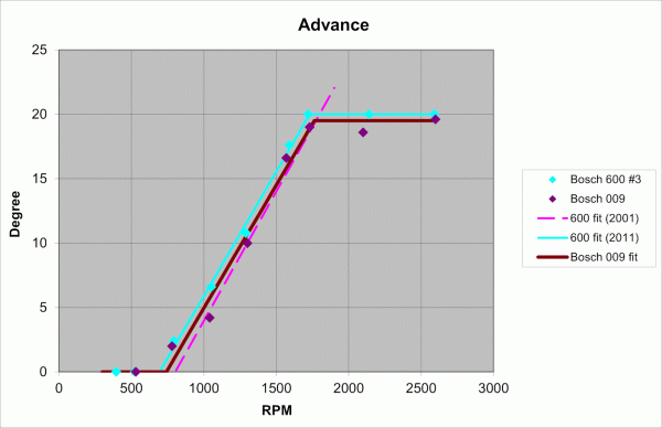

I run a Bosch 600 on my Tudor. It is converted to use a Pertronix Ignitor as described at the Tulsa website. I measured the advance curve for it, but I'm not sure which advance mechanism it was. I found it was very similar to a Volkswagen 009. Normally you want around 30 degrees at speed and 0 for starting, so I retard it to start and then advance it. The type without manual advance tend to break when you tighten the head, so I prefer the type with manual advance. They are a pain to set up because it can only be advanced over a small range.
