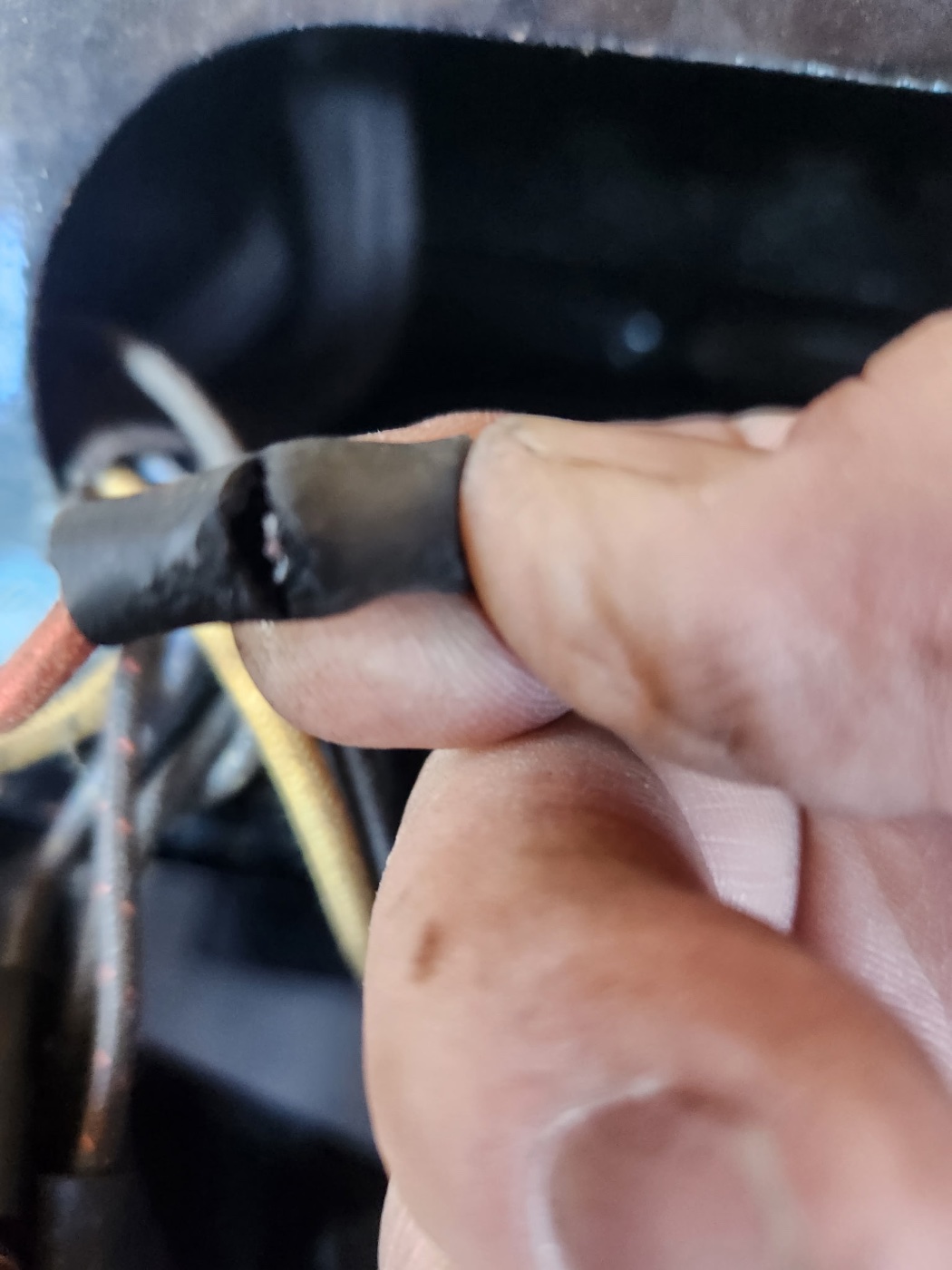

So how did that happen? Determined the red BAT wire to the ignition terminal on the combo switch had a fray or break in the insulation, and was touching the MAG terminal screw on the switch. Storage battery 6vDC was going each side of the key switch. :cry:
Fix was to remove that frayed red wire and taping it, and reattaching to be sure the wire was away from the MAG terminal screw.
