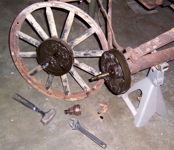

Posts: 4090
Re: Rear Puller Needed
Post by DanTreace » Sun Jun 30, 2019 12:26 pm
As others posted, apply a force, Hammer! Those hub cap thread style pullers need assistance, you can't wrench off a rear wheel hub, unless it was too loose to start with :)
After the puller is tight on the hub thread, twist the knock screw in firmly, strike! And then twist the knock screw again, as the axle will start to move slightly, strike again! Normally you will hear a 'bang' and the hub will now be loose.
100_5400 (600x520) (590x511).jpg (166.59 KiB) Viewed 4471 times

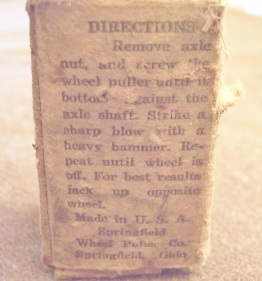

Or without that style, the simple 'knock-offs' that thread fully onto and bottom out on the end of the axle shaft are done similar, remember to have the opposite wheel jacked up, and the wheel for removal on the ground. You are 'knocking' the axle out of the hub.
Wheel puller instructions - Copy.jpg (114.18 KiB) Viewed 4471 times
